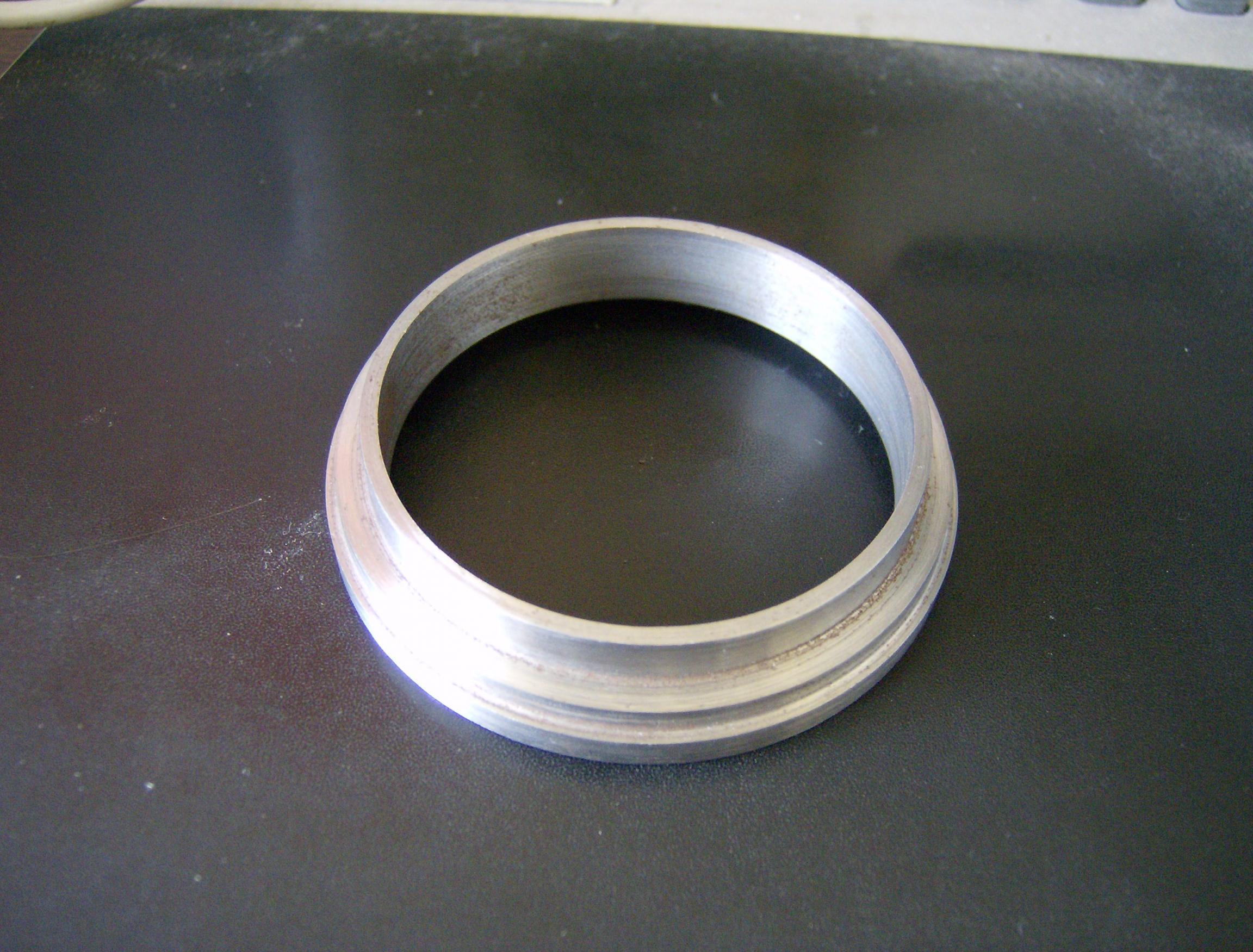

    1. Early Hemi Tech
    I made up some kits that just used the centering ring as shown below. No other crank hub adapter.
  4. How does that ring work? Does it pilot the converter hub directly into the bore of the crank? Is that bore usually pretty concentric with the crank centerline?
  5. 73RR
    Joined: Jan 29, 2007
    Posts: 7,207
    73RR
    Back in the '80's I designed a couple of variations of a one-piece similar to what you describe, but never made any for sale. I had trouble keeping the flexplate portion 'flat'. Fast forward to 2012 and I used the same basic design for a one-off TF adapter for a Mopar straight 8.
    Like Tom, I also have some 'centering pieces', but I use them as weld-in-place parts and refinish the id/od when the crank is ground. I don't find the id of the flanges to be very consistent...remember that the front pump does not want the converter to be out more than 0.007" TIR.
  6. TR Waters
    Joined: Nov 18, 2006
    Posts: 1,439
    TR Waters
    from Vermont
    1. Early Hemi Tech
    The ring has two steps. One picks up the center hole of the flex plate while the other centers in the crank.
    The ones I sold were tigged to the flex plate. There really wasn't much interest in this type of kit.
