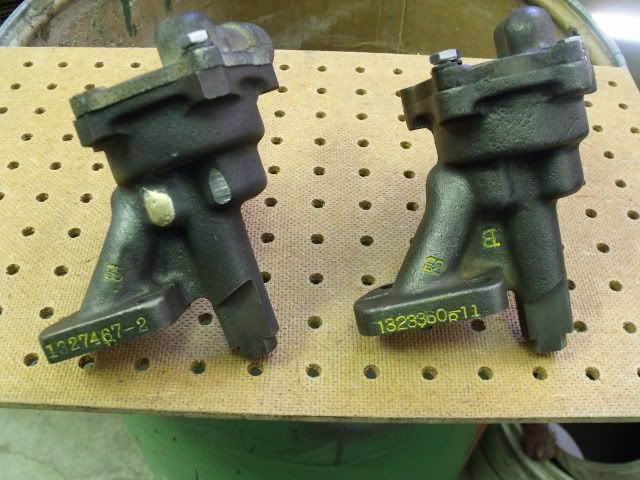

    Here are some tid bits of oil pump info...I have also put this in the OIL System folder.
    Dodge started out with what we generally consider to be the '392' pump.
    Chrysler started out with what is generally called the 'early style' pump.
    ...and then there is DeSoto...
    DeSoto used the design of the early pump, but, they used the 'foot' design of the Dodge. So what you have is an early style pump that will bolt on to a Dodge or a 392. Conversely, you can put a new M-50 on your DeSoto, of course the pick-up tube must be dealt with but, hey, were fabricators, right? Also, the DeSoto shaft is about 0.100" shorter than the rest so some fussing is required if you swap things around.
    276-291 DeSoto on left, 331 Chrysler on right, note the casting numbers.
    The feet sure 'look' the same...
    time to get the tape out...DeSoto
    331...
    392...
    Hopefully I have been able to offer some additional confusion to the issue..:D
