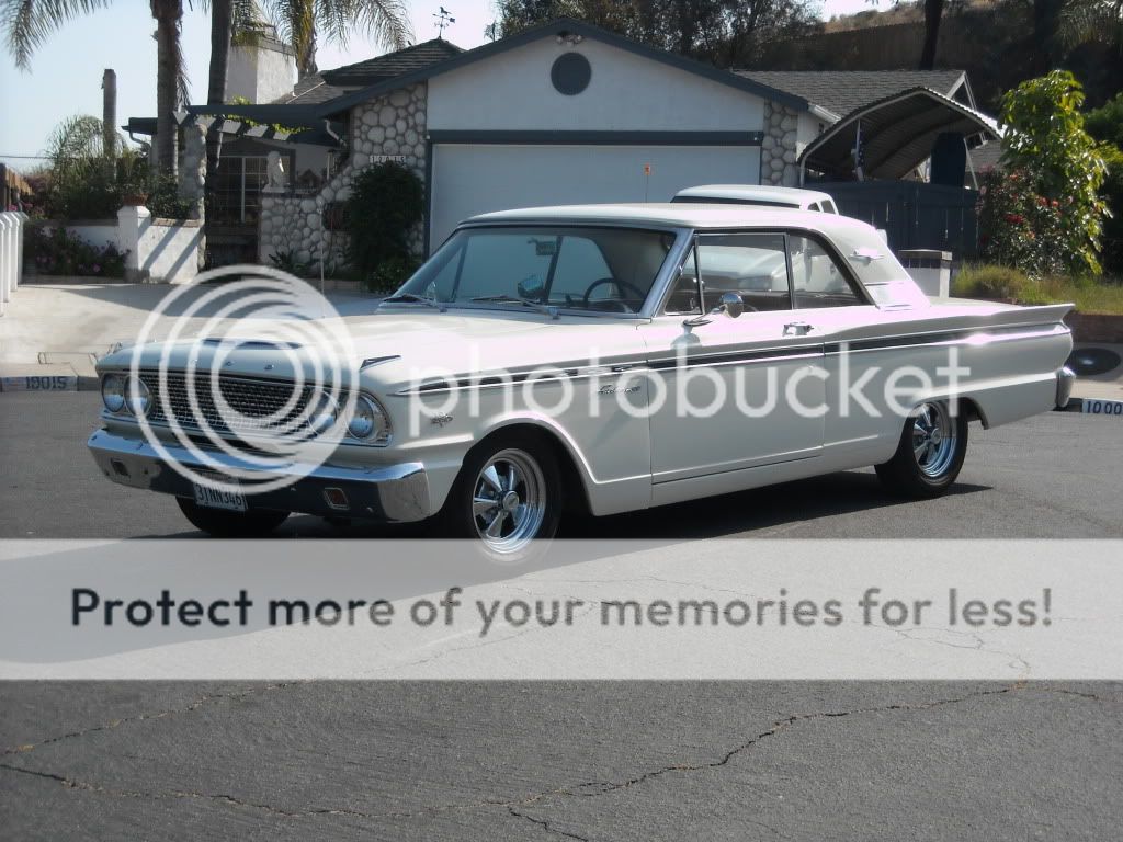

  9. Anybody have any pics of one of these all finished?? Need some inspiration
  10. JeffB2
    Joined: Dec 18, 2006
    Posts: 9,503
    JeffB2
    from Phoenix,AZ
    Like this?
