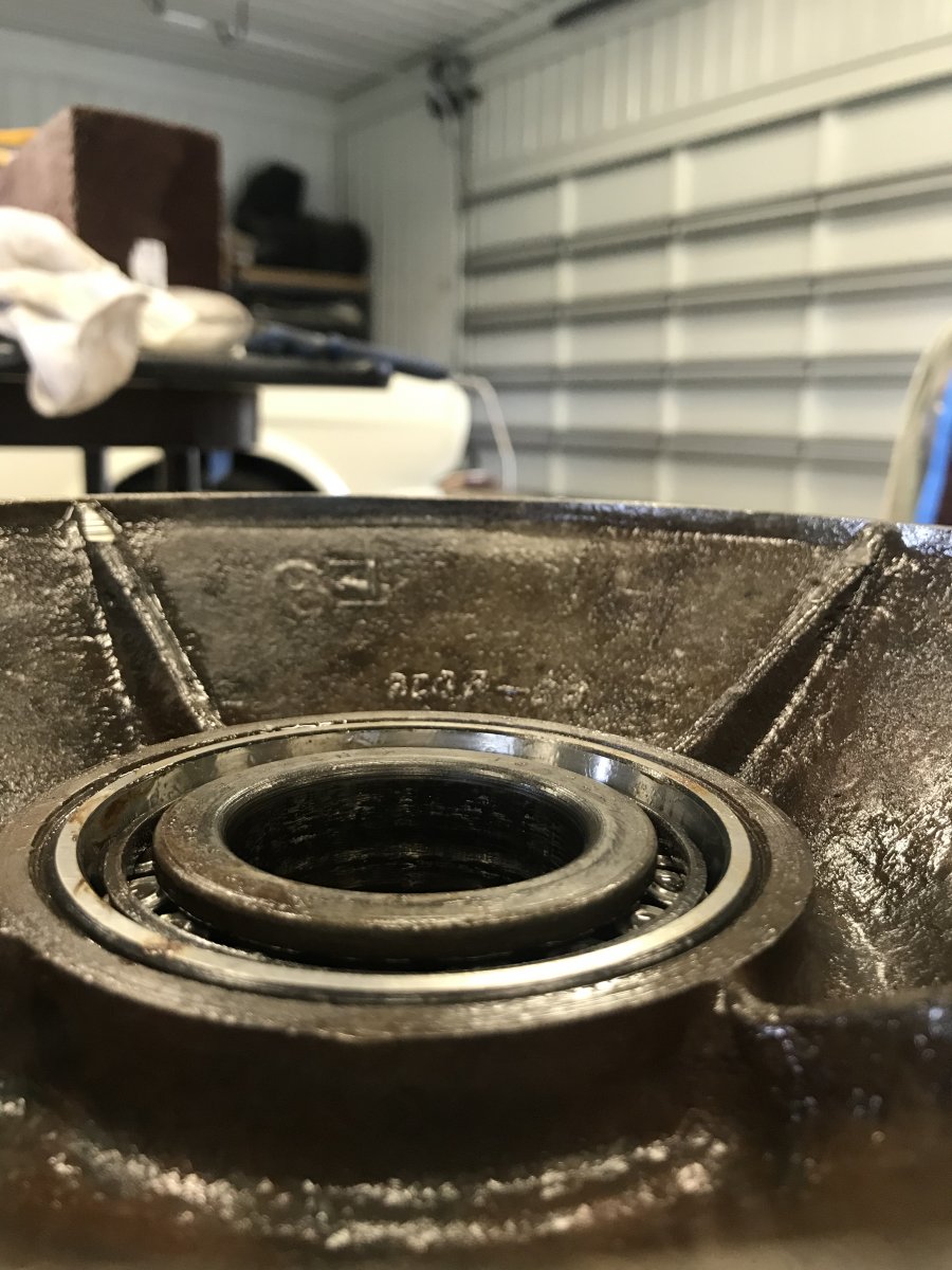

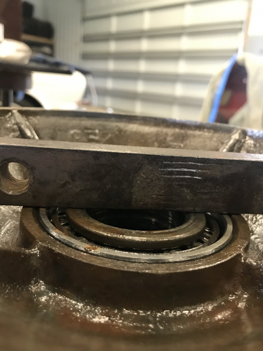

    EEAE1753-AE3C-40A3-9A86-BA64C8B0BC9F.jpeg 79C4ED7E-5F30-48B9-B7FE-F4A1532C5478.jpeg I had a chance to get out to the garage. I pulled the bearings off the carrier and the part numbers appear correct and are stamped “Ford”.
    After I pulled the bearings, I dropped one of the carrier bearings into the race installed in the bells. The bearing sat very low into the race. The face of the race and the Bearing were flush. I’ve never seen a taper bearing sit so low into the race. The excessive side to side movement of the entire carrier led me to believe that the bearings were the wrong o.d. Or the races were wrong. (When I pulled it apart I was pretty shocked at how new the races looked). I’ve never seen someone replace just the race and not the bearing so that didn’t really add up for me. The bearings were marginal the rollers had some pitting so I will replace them.
    Thoughts on how low these bearings sit in the race? It seems wrong to me.

    @cobra5laddict - I'll bet my lunch you have early bearings and late races. The earlier bearings and races are narrower from a side profile view, the later ones are wider, which actually helps mechanical longevity due to larger surface areas distributing the load, but that's a conversation for another day. Luckily you can get them for about 25 bucks. You currently (very likely) have a 18-4221 bearing in a 68-4221 bearing race. The 18-4221 bearing as seen here is .78" wide, you need the 68-4221 which is 1" wide.

    Also, and for what it's worth, my guess would be someone previously changed either the carrier or the entire center section on your rear using an earlier carrier/center. My stock '35 rear had the narrow bearings and races, but you could easily bolt on bells with wide races and not know the difference. Hell, it took me about a full weekend to figure out what was going on with mine when I was mucking around.

    I pulled the bearings from the carrier and the races from the bells. It turns out that the carrier bearings are early banjo 18-4221 original ford stamped. The races are newer banjo bearing size. The part number on the race is timken 25522. Obviously a mis-match.
