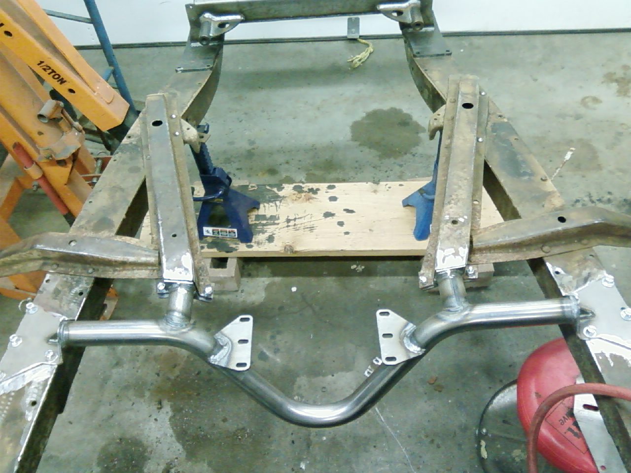

    that walton engineering crossmember looks pretty cool. I believe it bolts in ??
    I've never seen one installed in person.. people speak well of them though.
    I used chasis engineering motor mounts

    IMHO the best bet for a rearend is keep the stock springs and use one of the many rearends that drop in, and if you don't like the ride go to Posies springs. A second gen Camaro rear is damn near a bolt in, as long as you drill new holes for the locator pin which is not centered on the stock spring. This can also be compensated for when using lowering blocks. Fatman will sell you a kit to put a late rearend in and add a sway bar while you're at it, too. And Walton has a kit also, springs, hangers, the works. It pretty much depends what kind of money you want to spend.

    Walton was an easy way to go...i sent you a message.
