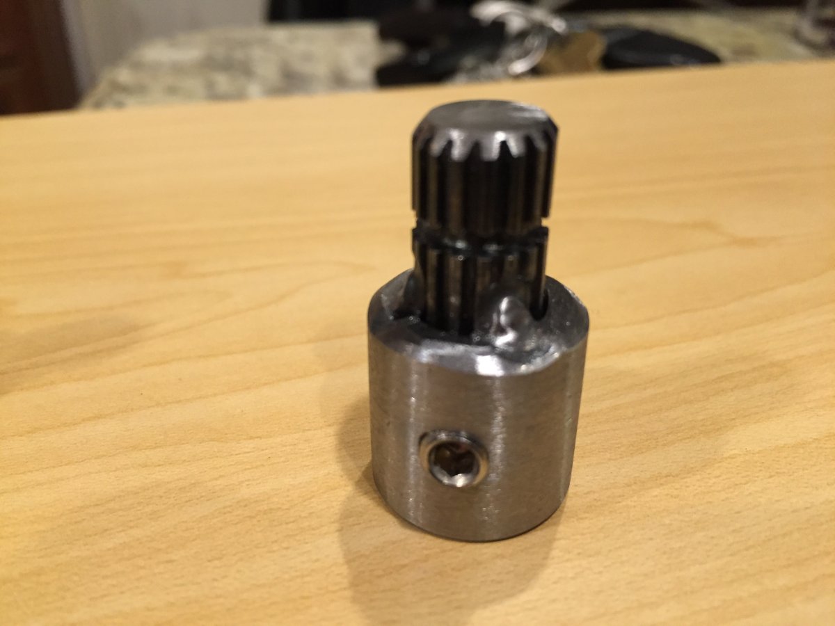

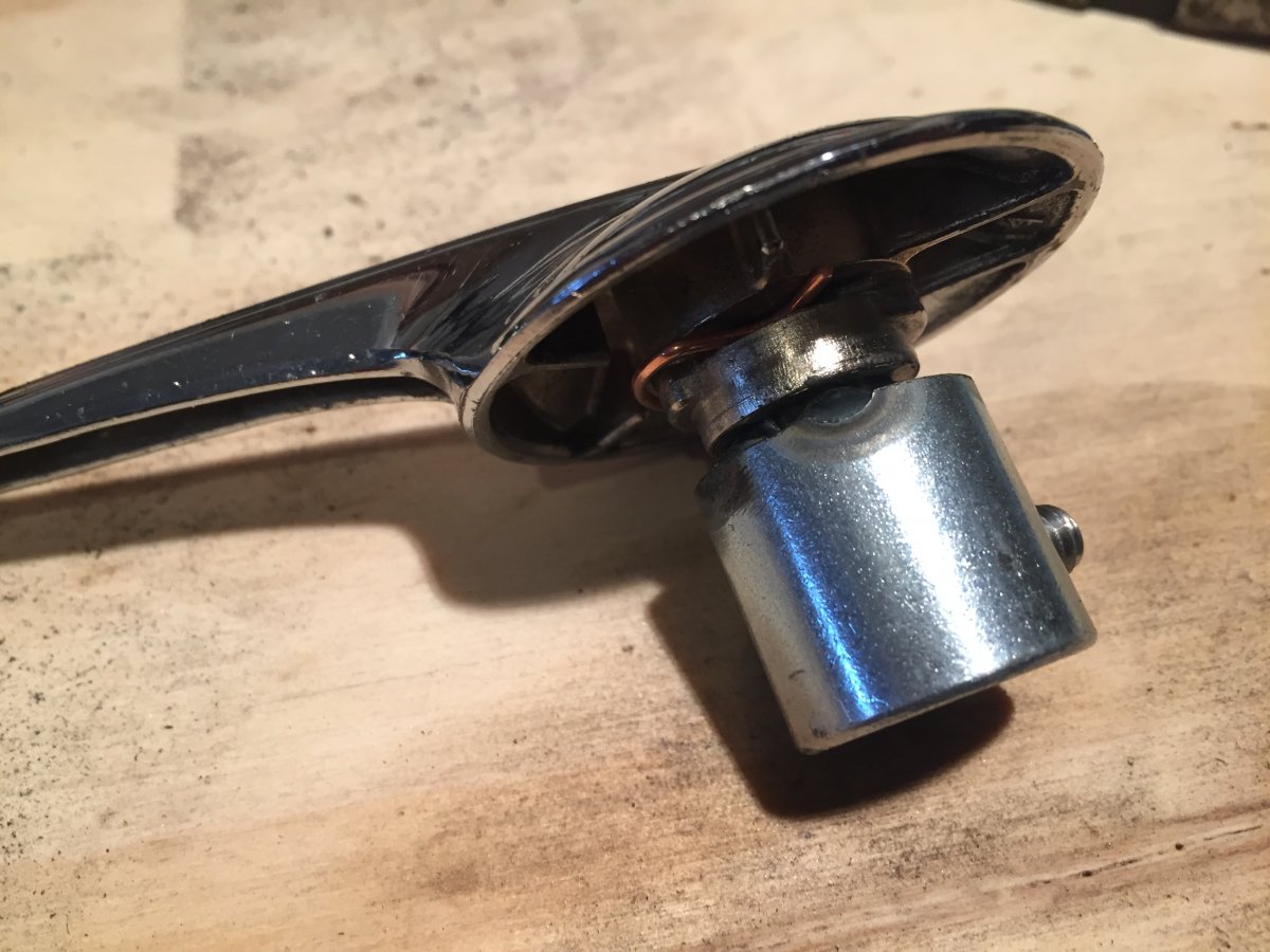

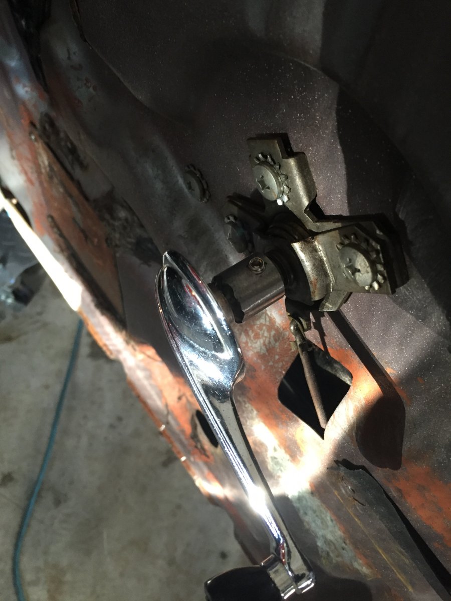

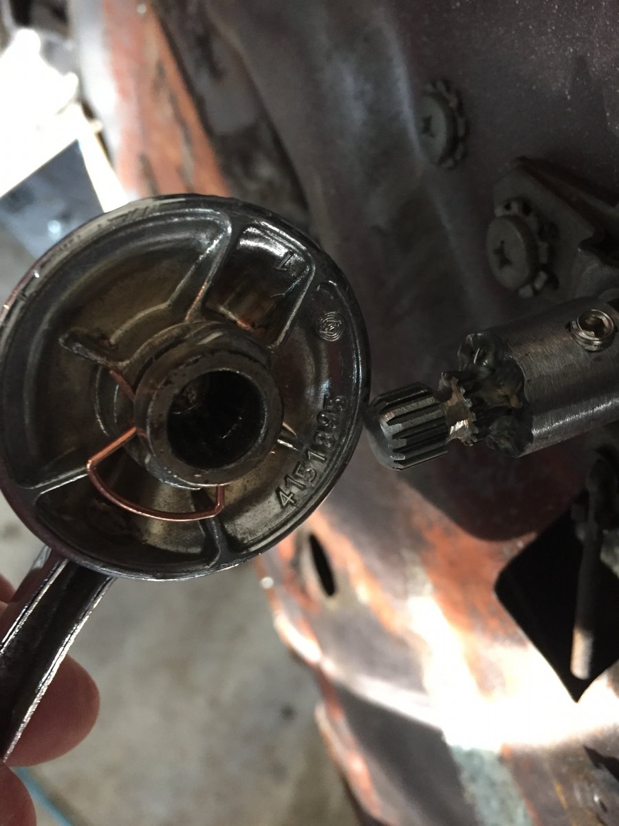

    I feel your pain, but now there is a solution for this. My company manufactures a high quality all steel extension that can add 1/2" to 13/16" to your existing shaft depending on how you attach it to the original shaft.
    It is a steel bushing with a window/door crank shaft welded to it that slides over the existing shaft and is firmly secured with a Stainless Steel set screw.The extensions are conveniently sold on eBay by Resto-Mod of Connecticut or you can contact Mark Vaughan at (860)208-3924 to place an order. image.jpeg

  15. 12 years now ,,,,
    Figured out last week that we need some.
    And these look good but wondering how it works without the internal splines.
  16. evintho
    Joined: May 28, 2007
    Posts: 1,218
    evintho
    Should be easy enough to make. No internal splines? Drill the existing shaft and pin the bushing to it.
