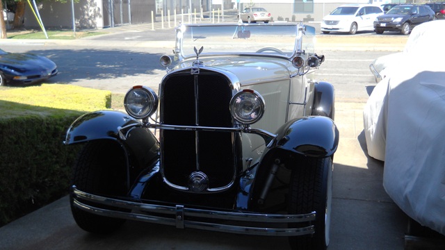

    Just want to get back to HAMB about Rudy and his 1930 Buick. He came down the street today honking his horn and I waved him over to take some photos. Incidentially, I was wrong on his age, he's 87.....
    I told him about repacking the leafs with the teflon sheets. As I look at his spring packs there's no doubt in my mind these are absolutely flat, hence his harsh ride. He told me today that some time ago 2 leafs were removed. Also, his wish is for the car to sit lower. I told him rebuilding the leaf packs is gonna do the opposite and raise the car slightly but he'll have a better ride.
    Note: he does have a rack and pinion installed. Yeah, I know it's not good and when you see the angle of it you'll agree. This is another issue that needs to be sorted out. but for right now I want to focus on the leaf springs.

    Part of the problem looks like those angle iron shock mounts would bottom out on the frame, there looks to be very little clearance, so he's not getting any suspension travel.

    Keep it stock and cut those angle plates so they give more frame travel. I'll bet that's all it needs. 15 mins with a burning torch and he will be a happy camper, and you will be his friend for the rest of his life. Iceman

    Not sure, below are additional pictures. The angle to the steering arm is steep. Not good. I know it's not good.
    So where on the angle plate should I make that cut? Are you talking about narrowing the base where it rests on the leaf? I have a Milwaukee cold saw that can cut angle iron easily.

    Man what a mess. I believe I would try to unbolt and remove that piece of angle iron that the shock is mounted to and test drive it without shocks to see if that piece was bottoming out or not. If the shock brackets is bottoming out, cut it so that it clears the frame or make a new shock mount. I would also be concerned that the springs might be bottoming out on the bottom of the rack unit.

    I don't want to sound like a dick and I know you want to help out Rudy but he really should to take to a shop that knows what they are doing. The fact that somebody has already installed that rack and those shock mounts tells me whoever has been working on it doesn't know much about suspension and steering.
    But if you insist, the shocks being straight up and down are hurting the ride, they should be at an angle, the shackles are at a pretty bad angle and the ends of each leaf should be ground at a taper so they aren't grinding into the other leaf.
    And for sure the tie rods need to be straightened out, at that angle a good dip in the road could snap them right off at their pivot.

    I really agree with T McG, that car needs taken to a shop that does really good hot rod fabrication and have them sort it out. The shock mounts are really bad, the springs are flat, and that rack and pinion steering would be of concern to me if it were mine.
