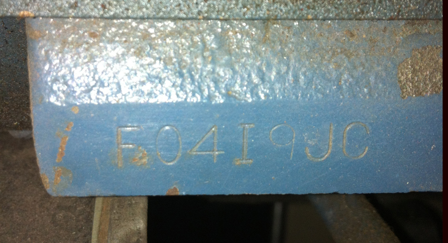

    Can someone help me figure out what year this Chevy 235 engine is. Any Help would be greatly appreciated.

    looks like a 61 or 62 truck engine, if you find the casting date, back by the starter, then you could figure it out for sure. A letter followed by a few numbers, like D 16 1
    letter is the month, A=January, B=Feb, etc
    middle numbers are the day of the month
    the last digit is the last digit of the year it was made.
    Since the engine was assembled April 19 (04 19) I'd expect the casting date to start with D

    Casting # is D 16 0 . So, I guess that's April, 16 1960.

    yup, that's what it is. I got out the older book and looked it up, the JC code was used from 1959-1962. I did pretty good guessing the day.... :)

    Yeah I thought that was pretty good. So what is the F for? Is that for the place it was made?

    F = Flint, Michigan engine plant
