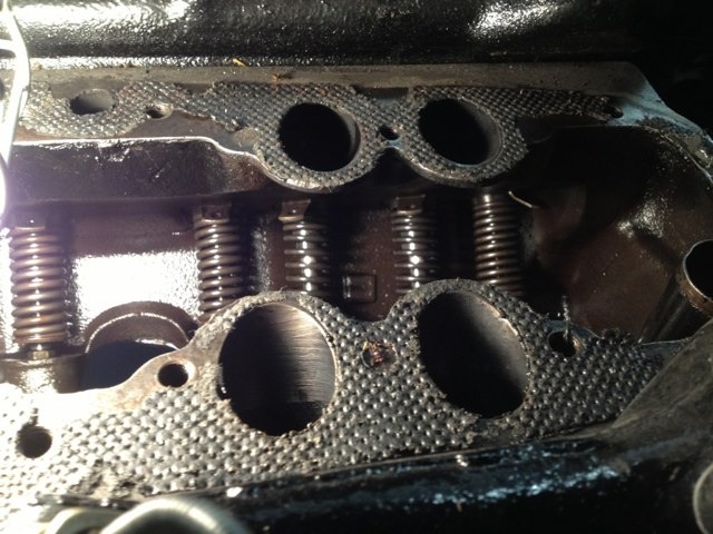

  1. Two years ago I had the motor rebuilt in my Shoebox by a reputable local flathead guy. As soon as I fired it up for the first time I head what sounded like a lifter ticking. I pulled the intake and checked the lash on all the valves. They were all within spec (.014) as per Iski spec on a 77b cam. The noise is louder when it's cold but still there when hot. Strange thing is sometimes it will get real loud and then it will just quiet down all if a sudden. One time while driving it got real noisy and I revved it up a few times and it quieted down. I had the intake off three times so far checking the lash and it always good. I took the car to the engine builder when I first got it going. He is a hour away and by the time I got there it was not ticking very loud. He said it "sounded like a good running flathead". I kind of got the hint he was saying get lost or he thought I was just a pain in the ass. I put my stethoscope on the header pipes, it sounds the loudest on the front pipe on the drivers side. The other day when it was ticking away I dumped a 1/2 a quart of oil in the motor while it was running. As soon as I did that it stopped ticking completely, until the oil drained down into the pan then it came back. It has good oil pressure all the time, and runs great otherwise. I did a compression check, it has 120 psi on all cylinders. I just at a loss as to what to check for now, if any one has any suggestions I'm all ears.

    Something I noticed in the picture the valve springs on the intake valves are not the same as the ones on the exhaust. The springs on the exhaust should not be used on a higher than stock lifting cam that type of spring will end up in coil bind. The springs used on the intake valves look sort of correct but its possible they are only the stock spring which has very low seat pressure. The proper spring for all the valves would be at least the Zephyr springs.
    You mentioned you have maybe only about .030 movement before the valve stops moving that also is not good the clearance should be more than double that. As the top of the valves become covered by carbon you will begin getting a knock as the top of the valve touches the head under load. Seems to me the valve train needs some attention once the proper parts are installed you should be fine.

  15. I noticed that the springs were different.
    He said he was gonna reuse the original springs. I don't think the valves are sticking, because it runs smooth and the compression check out good. I think my next step will be to pull a head to see if the valves are hitting.

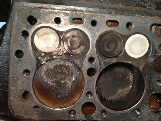

  16. Just pulled the left head, lot of carbon on the front and rear cylinder. ImageUploadedByH.A.M.B.1380848647.947833.jpg ImageUploadedByH.A.M.B.1380848663.747416.jpg ImageUploadedByH.A.M.B.1380848679.271792.jpg

    From the head picture it looks like the intake valve in the front cylinder is hitting the head. When using a higher than stock lift cam I find there is not enough clearance in valve pockets of the stock Ford heads. Looks like the engine builder did not check for proper clearances. If the block deck and heads were resurfaced during the rebuild the clearance over the valve is now way to small making matters worse.
  18. I put some clay on the valves on the front cylinder. Getting about .090 at the thinnest point. ImageUploadedByH.A.M.B.1380850639.300152.jpg

    That's a lot of funky deposits in that one hole, sucking oil? If it's two on each side it could just be a carb issue. Might want to roll it through once and see if everything moves right, valves going up same amount and then pull the two valves on the weird cylinder to check for odd wear.
  22. Yea, I was a little shocked when I saw that crud in there. I spun it around a few times and everything seems to move fine, nothing sticking. I'm gonna pull all the valves out and check them all plus the cam and lifters. I'm thinking the carbon came from a few factors. First I had a Pcv stuck in the intake where the road draft tube went. The hole is un baffled and is sucking a little oil. I probably should start running better gas too not just 87 octane. I think the carbon build up could be the cause of the real loud ticking that would come and go. But there is still a smaller ticking that was there when I fired it up for the first time when there was no carbon in it. I appreciate all the help / tips I'm getting here, keep it coming guys.

    Looks like some valves are getting awfully close to the head on the second and maybe on the fourth cylinder in the picture of the head you posted.

    A "quick-check" method for checking V/H clearance is done by installing the head on the respective deck WITHOUT any gasket and turn the crank over by hand. This will not give an exact dimension (clearance), but it should show any interference.
    Leave 2 bolts in place to align the head, but do not tighten them. (Our Flathead builds here now get the heads dowel pinned to align them in the same location at all times)
    Thanks, Gary in N.Y.
    P.S. This method is NOT good for checking "radial" valve clearances, but this shouldn't present any issue for the conventional 1.500" valves? This is important only with 1.600" or larger valves!
  25. Thanks Gary, what is a good clearance spec for the valve to head? If it is too tight is it ok for me to machine some material off the head for a fix? I do have a small mill I could mount it in to do it.

    Hi 'fritz", if the unit turns over with no gasket you have plenty of room. Seeing as how there are no pushrods/rockers to deal with I would say .025" V/H in any Flathead would be acceptible.
    You could clearance the heads, it will not hurt at all. Just don't go "crazy", every little bit removed lowers the C.R. some.
    (Add) There is a way to determine reasonably close how much room is present. It would require a couple spring shims (a .015" and a .030") the same diameter as the valve head (1.500"). You would place the .030" shim directly on the valve face, held in place with some white lube, and repeat the above procedure with R&R'ing the head. If the unit still turns you're really good (still no head gasket), if not try the .015", same procedure. You will have a "general" idea how much room you have in there. This method would also allow a comfortable decision with respect to the amount of milling you would be able to do if necessary in the future.

    I would check the pistons to see if there is pits in it , that looks alot like detonation ( clean area in the middle when it should be carbon covered ) when it occurs , if there is pits and the pistons were new , then you found your problem as motor oil vapor will kill octane and theses motors run a hot cylinder head which makes them more prone to problems like this . wouldn't be unussual for one cylinder to do it if the carbon got hot and was glowing .
