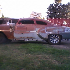

    Thanks everyone for the input but I WILL NOT be abandoning this car or scrapping it. Other than the roof line needing work and some finessing, it’s a good car. And no clue where these “$500 ‘54 chevys” are that someone mentioned but definitely not in this region; I’m seeing crappy 4 doors go for what I paid for this car. I’ve seen A LOT worse cars brought back or a lot more work put into other stuff that were considered wastes and in the end the cars turned out awesome.

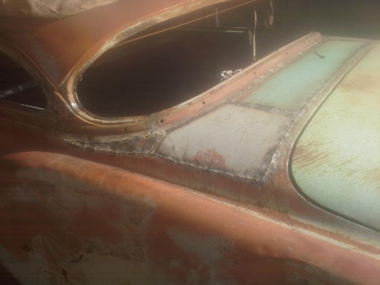

    Bring it back down to bare metal and do a restart. I know for myself it is not unusual to cut, recut, and cut and weld again. The rear sail area along with the rear window is usually the most difficult part of a chop on one of these designs. Just stick to it.

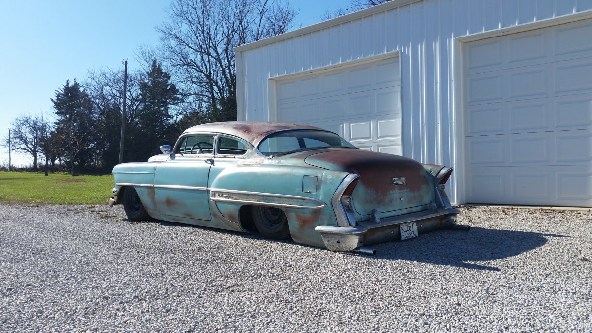

    Wow.... I came into this thread late but here's a pic of mine it's a 1953 210 that I chopped I use the stock rear window opening but I chop that down with the top since they do make laminated rear glass that can be cut your car has the stock size rear glass they try to slant it forward like they do the 51 Mercs... that approach does not work on these cars I would suggest redoing the rear completely either with the stock opening cut down or go with a different rear opening since you're there cutting up the metal anyway here's a picture of my car
    Peanut 1959 likes this.

    Hey Everyone, found a possible rear window frame donor but wanted to get some input on my idea and see if anyone has some thoughts/inputs on my plan:
    I'm thinking of cutting the '54 frame out and using the donor frame/glass posted in the pic posted, then tip the frame down more so that it takes up some of the space in the catwalk area and relieves some of that nasty bump in the rear of the roof. Taper the roof more in the back so it flows more with the quarter windows and then try to make/fix the belt line trim. Thoughts? FullSizeRender.jpg Screen Shot 2018-09-05 at 11.36.51 AM.png

    Well folks, after months of going back and forth on what I wanted to do to fix this chop...I decided to dig deeper and found more stuff that helped me make a decision. I found a donor '54 pontiac that I'm going to be swapping roofs and doors from the donor car onto my '54 and then rechopping it CORRECTLY. Let the good times begin!
