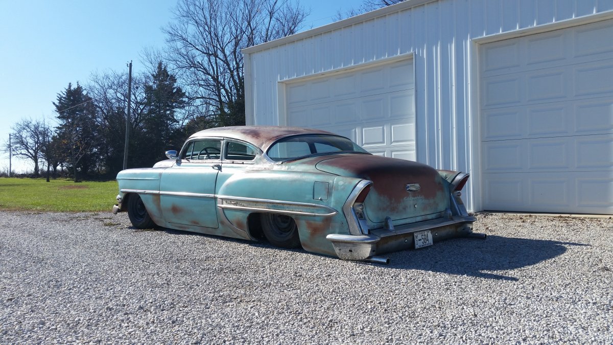

    20180428_110532.jpg This is a similar chop that I did on mine. 4" front, 6" rear. Back glass is slid forward 4". Corners of backglass are sunk approximately 1". The backglass' on these cars are real tricky. The comment about spending a couple hours of metal work to avoid using filler as modeling clay is a little misguided. That should be stated as "days" of metal work. There are so many angles/shapes happening around the back window, quarter panel, roof, drip rails, quarter window opening....the list goes on and on. All of this has to be done while retaining a roofline that "flows" well and looks good to the eye. It's very, very difficult. I would guess this is why most do change to a different make, model and year rear window. Less work and also allows for more chop. The factory backglass on a '53-54 really limits your options on the chop.

    Thanks for the kind words. I'll be honest, I was really close to putting a '52 backglass in mine last summer.
    This was the first chop I've ever done on a 50's car. They just take time. With a lot of patience and continually stepping back 20-40 feet to make sure it looked right, it eventually started to pay off. I think this car could be saved but unfortunately I think it's going to require another roof or at the very least require a backglass section. You don't need all the fancy tools you see on TV either. English wheels and planishing hammers are luxuries, not necessities. Get down to the bare metal and make it happen. Good luck.
