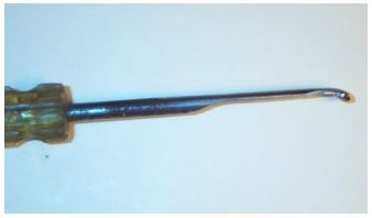

    I ground down an old screwdriver to help push the terminal and wire through the boot lubed with WD40.

    I use this type of bent needle nose plier. You can get them around the bend to pull them through before putting the end on. I use dielectric grease, but the silicon spray sounds like a good idea too. Will have to try that next time.
