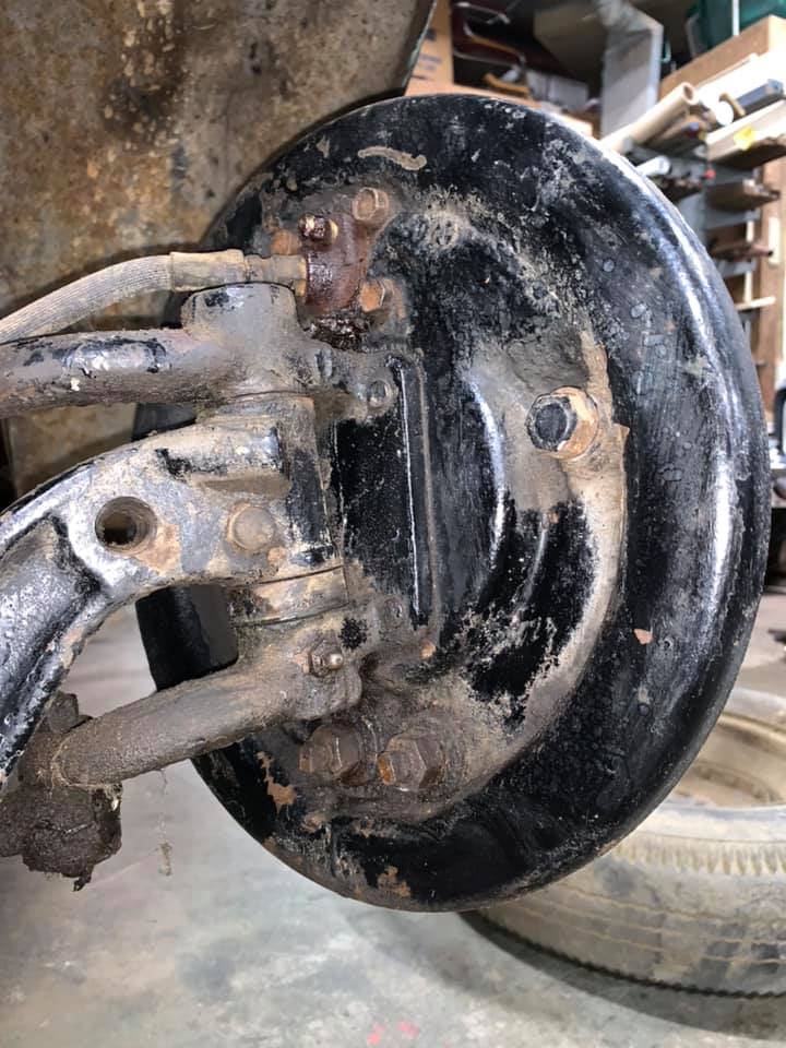

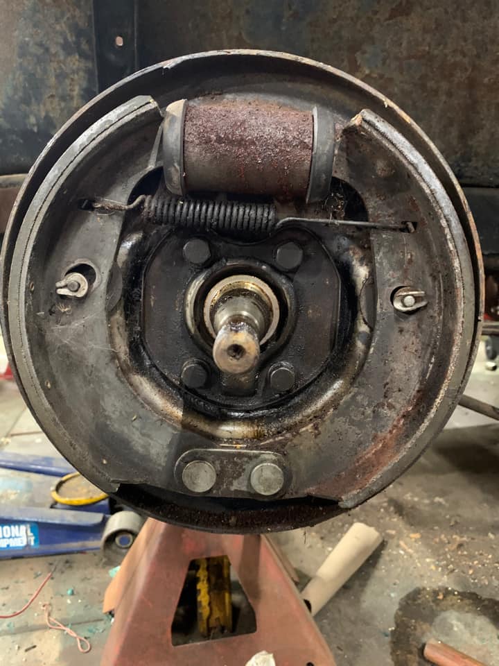

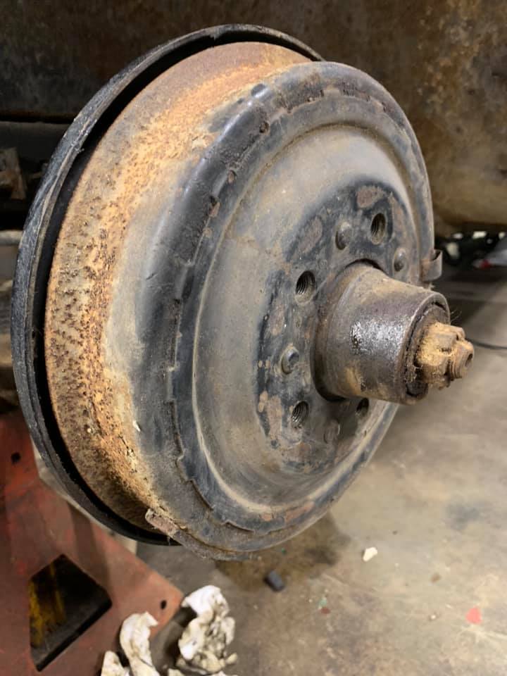

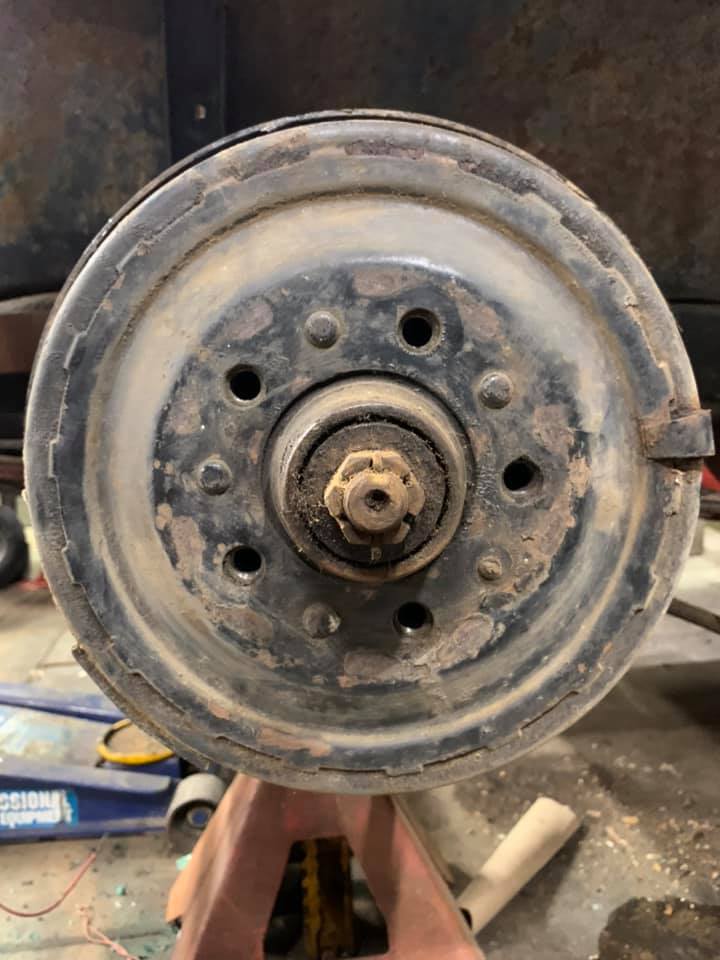

    I picked up this 1928 Chevrolet cabriolet a few weeks back. I'm having a hell of a time figuring out what all the front end consists of. What do you guys think? I would assume that the whole front axle, spindles and brakes would be pulled from the same car but who knows? It's 5x4-1/2 bolt pattern and uses wheel bolts rather than studs which makes me think mopar? But i cant find a mopar backing plate that matches mine.
    what do you guys think?

  2. Hudson also used the lug bolts instead of studs/nuts. I remember working on a '37 Hudson Terraplane years ago. My first thought looking at it was that the rear end and brake drums looked the same or nearly the same as similar vintage Mopar.

  3. 1971BB427

    If you'd take a picture of the whole axle it would help ID the axle. Tough to say which maker it is just showing the ends at the backing plate.

  6. With Mr48 Chevy - drum is a Mopar - can't be sure of the axel - looks kinda like a mishmash of parts like they did back in the day. Nice rare Cabriolet there.

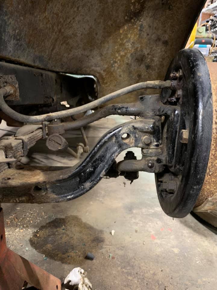

    Looks like an old Chevy with 49-54 spindles

    The axle is definitely from parallel leaf vehicle. I thought 49-54 Chevy had bolt-on steering arms? Those spindles look Ford to me, maybe 46/7 pickup? I'm not familiar with any Mopar stuff. Another possibility is mid-60's Chevy, Ford or Dodge cabover pickups and vans.

    I'd have to say that someone figured out that a Mopar axle would bolt up under the Chevy without much trouble and give hydraulic brakes and act as a dropped axle in the process.

    The brakes look alot like the ones on a 56 Dodge truck I am working on

    Yep Lockheed brakes, Mopars ran them for years on end (23) Vintage Mopar Lockheed Brakes. Typical Issues. - YouTube
