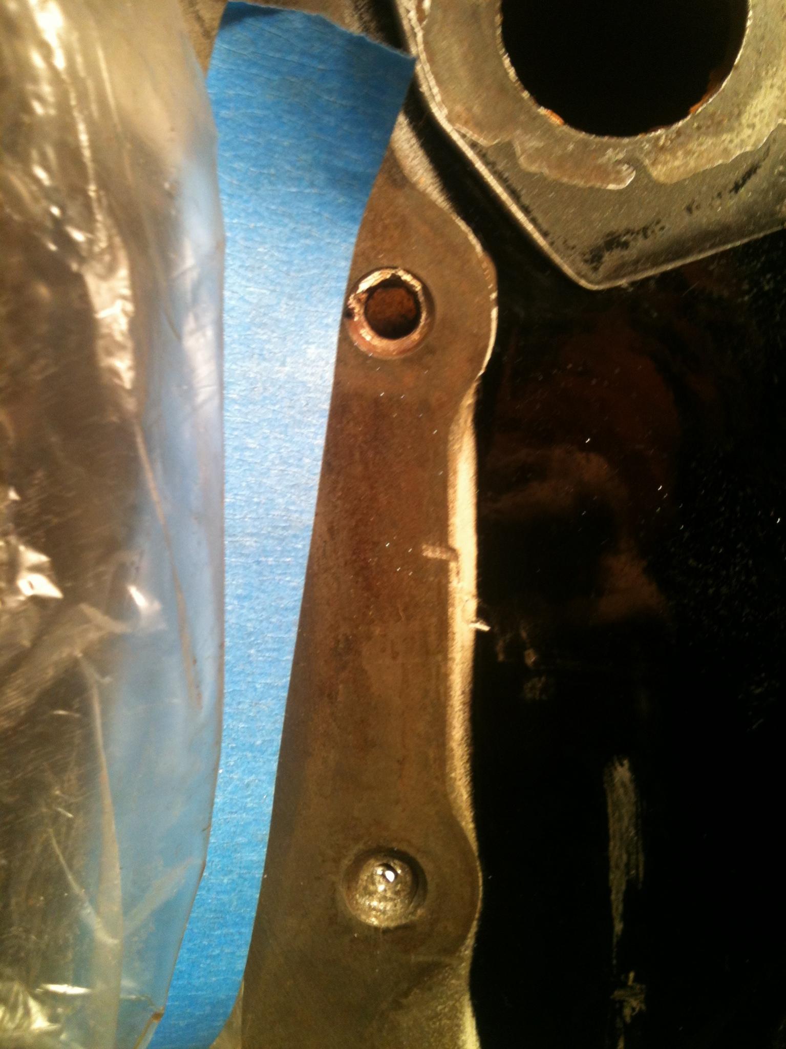

  10. Here's a couple cell phone shots of the broken bolt and the motor. I don't want to put any heat to block as it's already been ground smooth and painted gloss black. And I really don't want to have to disassemble the entire motor to have machine work done.

  26. Judging by the pics, the bolt looks to be broken deeper than the face. That leaves the weld tricks out, the pliers tricks out. Carbide drill in 1/4" is not cheap, about 30.00.
