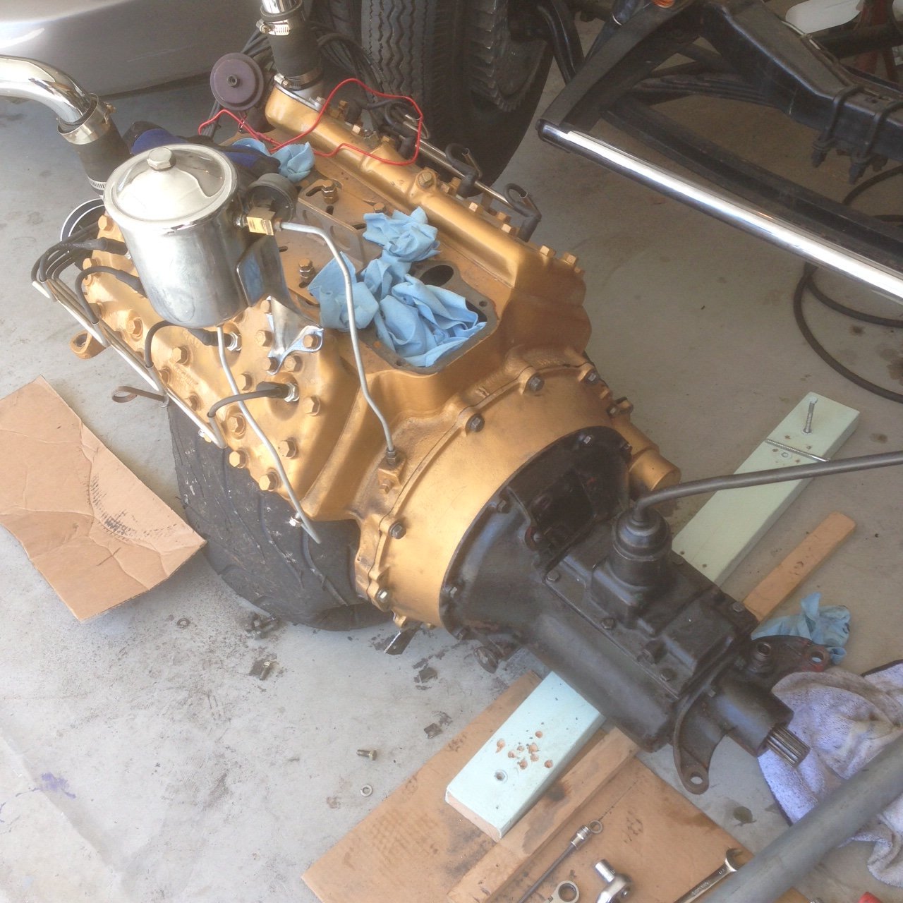

    so im hoping someone out there can throw some knowledge my way. I finally got my Roadster buttoned up and ready for its first trundle down the back lane under its own power since i replaced the worn out 48 flatty with a 53 Merc unit. put my foot on the clutch (all the way down to the toe board) and tried to put it in gear.....lots of grinding. the clutch was great before i swapped the mill and i have the correct bell housing adapter because the gear box and engine mounts all lined up perfectly. so afr my fault finding methodology has gone like this.
    turn off motor, select gear, kick starter over, car moves...gear selector working as it should, probably clutch issue.
    remove pedal assembly, remove access plate in bell housing, rotate clutch shaft...throw out bearing moves forward till it hits the three levers on pressure plate and jams solid....no movement in levers....
    pull motor and trans, remove gear box, take clutch apart...everything as it should be...check pressure plate levers, they move under pressure but are very stiff....the three screw in adjusters that throw out bearing hits are adjusted evenly (this is a brand new pressure plate and friction disk)
    swap in the pressure plate that came with the 53 motor, put it all back together...throw out bearing now touches levers and depresses them ever so slightly but still not enough to release clutch.
    I need to add here that all clutch components i'm using are new and torqued to spec....there is about 3/4" of travel before throw out bearing hits the fingers on the pressure plate (3rd photo below)...it just feels as though at that point it runs out of travel. in my mind there are two things that could solve this...either a deeper throw out bearing or a thinker flywheel. i gues my question to you all is....Is there a well known combination of clutch components used when mating a 53 Merc to 39 top loader? can anybody see anything I might be missing? sorry for the long winded post but i just wanted to make sure you all can see what ive checked so far...this must be a combo thats been used a million times before.... IMG_9681.JPG adapter.JPG clutch.JPG

    When was the last pic taken? Motor out? or motor in car?
    The reason I ask, is there is a country mile of space before the TOB touches.
    There only needs to be a slight air gap between TOB and fingers when diagnosing this.

    thanks guys. F&J the photo was taken with the engine out, this is with the preasure plate that came with the Merc motor (looks like pressed steel fingers rather than cast. the gap between bearing and fingers is slightly smaller than it was with the pressure plate for the 48. the adjusters on the fingers of that plate were screwed right out too....it occured to me this afternoon that perhaps there is a pressure plate available that is deeper than the two I have and would consequently move the fingers closer to the bearing. does anybody have an idea for a resource i could use to compare dimensions on different clutch components? anybody have a bunch of different flathead pressure plates kicking about to compare? its a 10" clutch

    Ok, went back and tried that to double check but the bearing doesn't get anywhere near the hub of the disc, what you can see in the photo is the smooth section of the shaft that the bearing slides on. The bearing hits the pressure plate fingers an easy inch and a quarter before it would touch the friction plate hub. it really feels as though it runs out of travel just as it connects with the pressure plate fingers. this makes it feel at first as though the pressure plate is at fault when in reality i think the bearing hits a dead stop. I'll pull the trans back off tomorrow so that I can measure some stuff...in the meantime it would be great to know whether there is a deeper pressure plate that would move the fingers closer toward the T.O. bearing.
