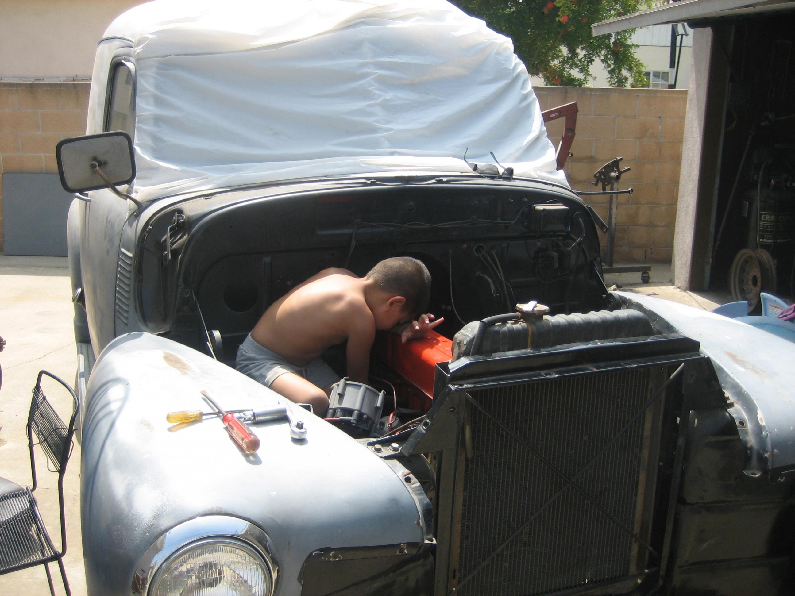

    My 8 year old upgraded my Panel when he was 5.
    Watch for oil leaks around the distributor shaft. Try putting an O-ring around the shaft
