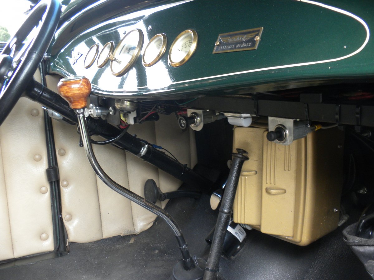

    The fan I have now that just died is only 4 blades and fan is only about 5" in diameter. It's some kind of old small heater

    I adapted a squirrel cage fan and motor from a late model into the Stewart Warner heater on our 38 Chev, I had to cut a hole in the heater body for about an inch of motor that protruded.....but it works way better than the four blade that was there.

    I'm using one, about 4". It works good but I made my own tube and fin heat exchanger that is a lot less restrictive than a regular heater core.
