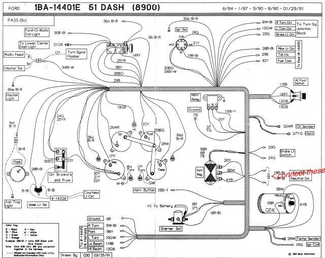

    This is a 52-54 Ford wiring diagram: http://www.jalopyjournal.com/forum/media/albums/wiring-diagram-52-54-ford.40980/ The problem with most aftermarket wiring kits is they are " GM friendly" and GM switches have two power leads and Fords only have one so they don't play nice with each other,you could install a GM style switch: http://www.ebay.com/itm/Universal-G...tor-/141013239716?hash=item20d50b47a4&vxp=mtr There is a section in this little book that shows a way around it http://www.speedwaymotors.com/Book-How-To-Wire-Your-Street-Rod,2824.html

  15. Definition of the letters on back of the headlight switch. I think I should be good with all that gather info. Only thing left would be how to tie in door switch to the circuit to turn on dome lights.
