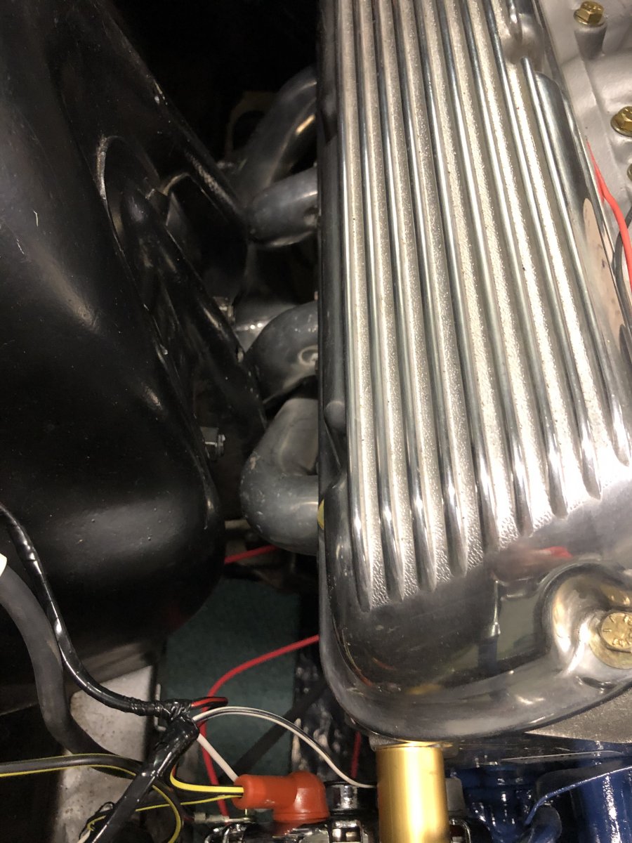

  4. Falcon has less room than a Mustang..I have Doug’s in my 65 Falcon..they fit well...weren’t what I’d call easy to get in..can’t imagine dealing
    with headers that don’t fit..I used the small bolts and ground a stubby wrench down in order to tighten them up...
  5. Dougs headers for the early Falcon; don't waste your time with Mustang headers. They're not cheap but do fit. The early Falcon/Comet engine compartment is 1.5" narrower than an early Mustang, believe me that makes a difference...
  6. My 65 Falcon with Dougs... D05E2775-6A07-4484-9F8B-CB17E8B2EE18.jpeg E806CAFF-2123-46D1-877A-C501F8EA2890.jpeg
