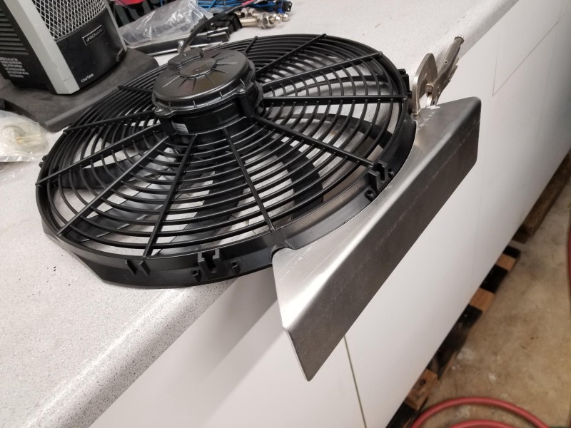

    Still raining, so can't do a whole lot with no room. Since I couldn't find anything I liked, the project du jour is making my own fan mounting brackets. Doesn't sound like a hard thing to do, but try bending a nice 90* with a hydraulic press and not a brake. Takes 20x longer than it should, but at least it's not an off-the-shelf piece that I just don't like. fan1.jpg

    Not traditional, but I can't afford to leave any horsepower on the table. These would have been pretty easy to make with a brake and a mill, but where there's a will, there's a way. Surprisingly, it even fits. fan2.jpg

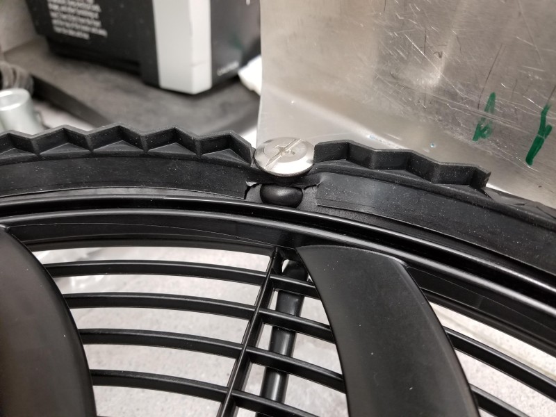

    Soooooo....... this is one of those little details I like to figure out (though it's not really that big of a deal). Since I'm mounting the fan to the radiator with my own brackets and not using the cute little feet Spal makes, there were a couple issues to handle. With there being a gap between the fan & radiator and the mounting bolt heads being on the radiator side, I thought I could kill 2 birds with one stone.
    Spal makes a cool rubber seal that will take up the approx. 1/4" gap but the second issue was how to bolt the brackets on without bolt heads wearing 4 nice holes into the core. I surfed Google and found something called Hurricane bolts with really thin and broad heads. I trimmed the seal around the mounting holes so the rubber would seal against the core but the heads wouldn't hit.

    Elevator bolts would possibly be another option for this job.

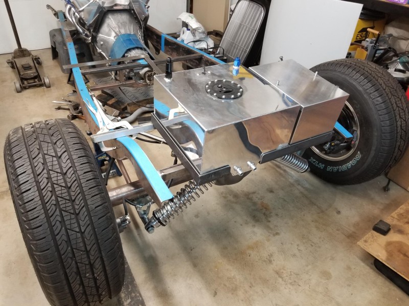

    Today's project is making feet for the cell/tray frame. The goal is to be able to bolt the cell/tray frame directly to the the frame rails. The floor where the feet mount tilts back, so that angle had to be matched so the cell sits level. The fronts can't be made up until the roll cage is in place as the rearmost points of the cage need to mount as far back as possible. tank2.jpg tank1.jpg
    loudbang, bchctybob and OFT like this.

    Hasn't been a lot going on lately with life getting in the way and all. This simple little project took weeks for me to make up my mind about. I modified the stock brake hose bracket but needed a way to hold it on the axle housing. Wound up making a threaded plate out of 1/4" and tacked it on the housing. One more simple little thing.....

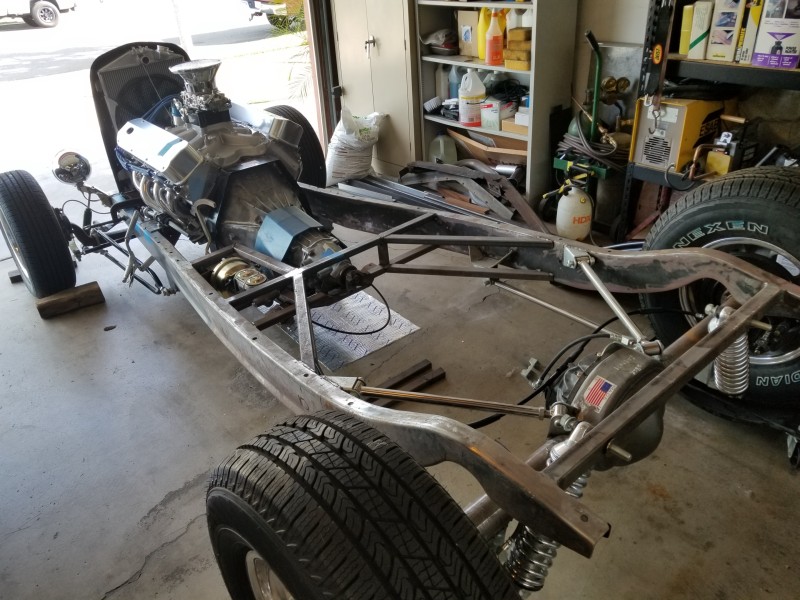

    So, things are moving along again. The '31 is moved and covered and the '32 body is off again.
    First thing is get rid of all the garbage frame work the PO did. I'll be re-designing it, but here's where the balancing act is. I've marked where the roll cage will be, but other things that don't have a flexible location need to be mounted.

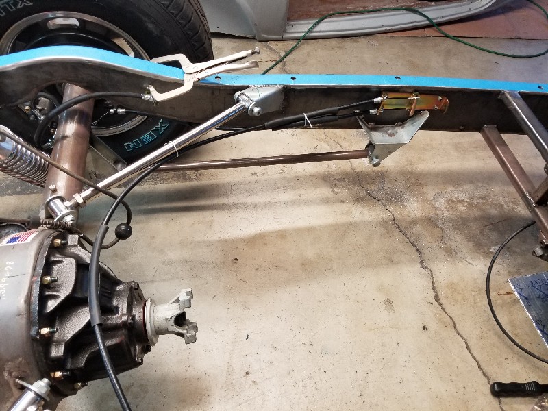

    Tonight, the parking brake cable bracket was mounted. Layed out the cables to locate the bracket, drilled and installed rivnuts so it can be removed later if need be.
    Next up will be moving the brake master/booster back the 4-3/8" the firewall was set back. When that's done I can then locate and mount the electric vacuum pump. At that point I can start designing the frame reinforcing working around essential components.
    Unfortunately, I also need to cut off and properly mount ALL the suspension brackets since the PO eyeballed everything and the closest he came to getting left and right equal was 1/4". That was only ONE bracket.... the rest are off up to 3/4".

    One more little detail. Since all the suspension mounts/bracket need to redone, I can't trust anything is where it should be. To lay the foundation, I have tape on the top of the frame rails and will be laying out a grid so I can mark locations and measure for square before tacking.

    God I hate those angled 4 bar suspensions. The steel of a rear end does not compress or stretch. The top bar swings in an arc and then go away from each other if the steel stretches. GM factory used with big rubber bushings to work. Try jacking rear up and down to see if binds. I know I will never use.

    I put the same style 4 bar in mine, squared it up, set the rod lengths to give adjustability. Tached it in, no binding and no panhard bar getting in the way of exhaust. Try to keep the lower bar parallel to the ground when installed. thumbnail (3).jpeg

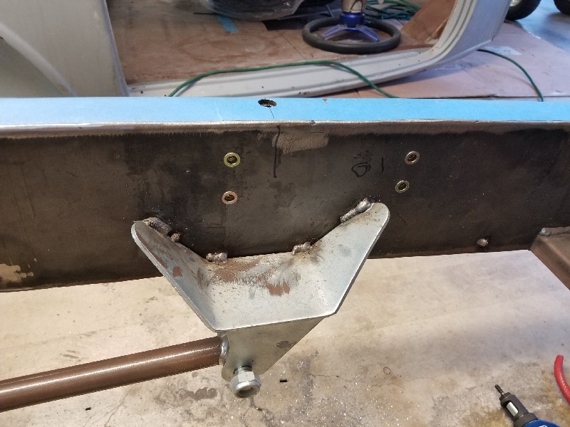

  13. Mr T body
    Joined: Nov 2, 2005
    Posts: 2,227
    Mr T body
    Alliance Vendor
    from BHC AZ
    I'll be honest, I have my doubts about this suspension handling the HP which is why I'll be rattle-canning the frame. Probably wind up going parallel 4 link but you never know 'till you try, right?
  14. Mr T body
    Joined: Nov 2, 2005
    Posts: 2,227
    Mr T body
    Alliance Vendor
    from BHC AZ
    I'm at a point where it would be easier to just go 4 link now, but there's that part of me that wants to know IF it'll work this way. I know I'll need the adjustability a 4 link gives when it's raced later, but I'm still fooling myself into thinking this will see much street time.
  15. AmishMike
    Joined: Mar 27, 2014
    Posts: 984
    AmishMike
    I see heim ends in “split bud” which help. Also dragged GM with angled bars. After stiffed bushings really stiff/bind suspension helped it hook. Still will use 4 bar + panhard rather then angled. Big rubber bushings for street & no maintence soft ride. Just my hang up & hate angled bars becoming more popular
  16. Mr T body
    Joined: Nov 2, 2005
    Posts: 2,227
    Mr T body
    Alliance Vendor
    from BHC AZ
    I hear ya. Hard to get my head around this geometry as movement in any direction will bind. Only way I can see smooth articulation is with heims top and bottom at the front. I can do that (and may), but there's a lot to do before that.
  17. Splitbudaba
    Joined: Dec 30, 2014
    Posts: 765
    Splitbudaba
    I seem to have been edited again! Heim end with a spacer on each side work pretty good! Let’s it roll a little! Won’t mention my El Camino again????
  18. Mr T body
    Joined: Nov 2, 2005
    Posts: 2,227
    Mr T body
    Alliance Vendor
    from BHC AZ
    Well my momentum came to a screeching halt tonight. I've been measuring to get the 4 link brackets in the right place and nothing's adding up. Started measuring diagonally and ...... frame's tweaked. Now I know why he eyeballed it. Looks like the frame's getting stripped down and put on the frame rack to see if it can be squared up. Only 1 word comes to mind and it starts with an F.......
    OFT and loudbang like this.
