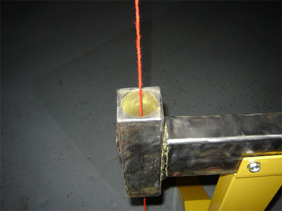

    Today we'll be taking the paint off of the top half of the frame to see what we are dealing with...

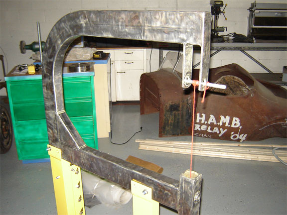

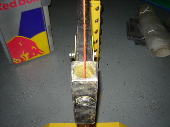

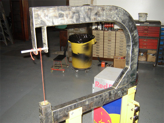

    So the paint is stripped off of the top portion...
    I have jumped up and down on it in an effort to get it lined up more accurately. It's better but not perfect. You can tell by my super accurate plumb bob. :rolleyes::D
    Maybe this week I'll get a chance to finish and reinforce it as it's a little flimsy in my opinion.

    if i may Zman...a little suggestion. i'd cut off the upper yoke, and the lower adjuster tube from the frame, weld them to some plates, and weld matching plates to the frame, the upper being oriented horizontally, the lower being vertical. this way you can bolt the yokes on, and shim them if necessary to get wheel alignment right instead of trying to bend the frame back into shape. with the plates located this way, one vert and one horiz, you should be able to adjust out any misalignment you encounter.
