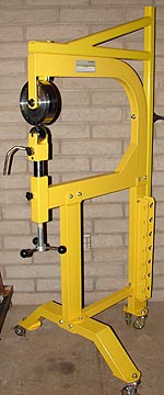

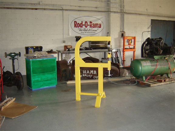

    So I hate Harbor Freight. You can read about it in multiple posts on here. But I caved. I knew it was going to be a piece of Chinese crap but yet I ordered one. I figured that the cost of steel and the anvils made it worth it. Now I'm setting on the path to fixing the damn thing. I'm gonna track the hours and the amount of material I use to fix it. And we'll see if it's really worth it or I should have bought a good one off the get go...

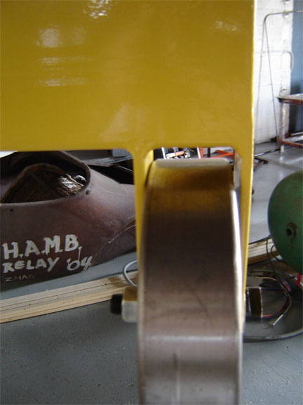

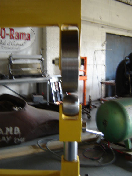

    There are definately some issues with it... The wheel and the bottom anvil are way out of alignment. The frame flexes way to much. The quality of the welds is questionable at best. It's gonna take some work.
    First thing I'm gonna so is to document what is wrong with it. Then get to fixing it....
    You can see some of the issues from the attached pics....

    Much better, actual constructive post... I'd be much happier with some adjustability right now. Look at the pic with the straight line to see how much these things are off. It's gonna take some work, but I think it can be made better, will it be worth it? Depends on time and materials... Plus it's a learning experience for a couple of others to show them how much it takes to fix crap...
