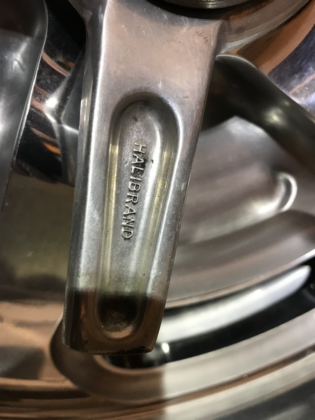

    I learned to "tighten" knock offs by this rule of thumb Down in the back! DSCN3699 (2).JPG

    Haven't taken the wheels off yet. Waiting on the tool to see if it works.

    It looks like you can see enough of the last thread exposed to tell if they are left or right hand threads.

    That is the way ET wheels are and I have had them off many times. Passenger side is LEFT hand threads.

    That makes passenger side LEFT hand threads.
