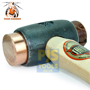

  29. 940869CE-572B-4BC4-A990-C42B8164865B.jpeg 532CEFAE-BD0B-472D-8372-7CABEA6CA358.jpeg
    when I worked at Jaguar we had a THOR hammer
    Rawhide on one side lead on the other
    and a wooden “ wrench “ to pound on to save marring the spinner or knock off .
