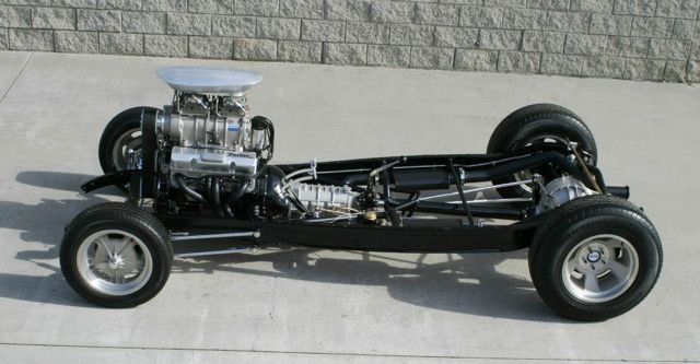

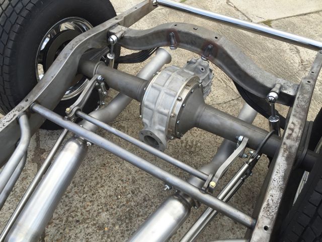

    $400 for the Halibrand pictured is a "STEAL" for the unit if in good shape. The side plates bring more than that in the US. I use the Champ in 34's because I like the strength and have a heavy right foot. In the 80's Halibrand offered the champ with some new side bells and Brizio put them under many 32's and I thought they looked great. Use the 40 bells, have the unit media tumbled and you will love the look. Here are some Deuces that feature the Champ QC…look good to me. Buy the unit.
    IMG_0045.jpg ImageUploadedByH.A.M.B.1442536157.087898.jpg ImageUploadedByH.A.M.B.1442536084.923250.jpg
