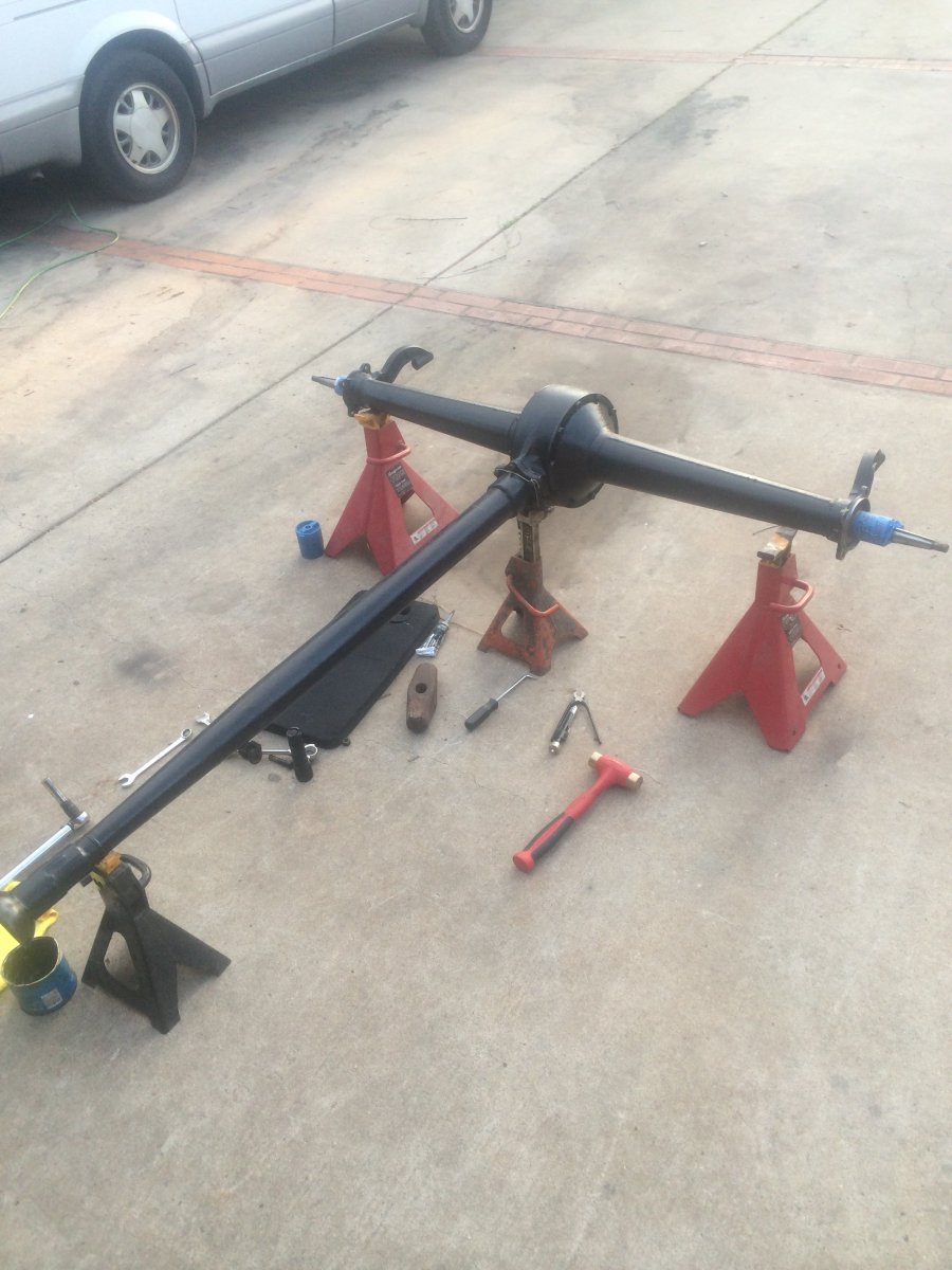

  2. image.jpg image.jpg Sorry for no more pictures me and my employees are hard at it with yard work. :D:D:rolleyes: Elves are working on the car since im working so hard on the lawn;) Man if only you guys could see what the elves are doing.... :p
    Cyclone Kevin and jerseyboy like this.
  3. They almost got it back on the ground. One crawled all the way up inside the axel tubes and hammered in new seals for me.

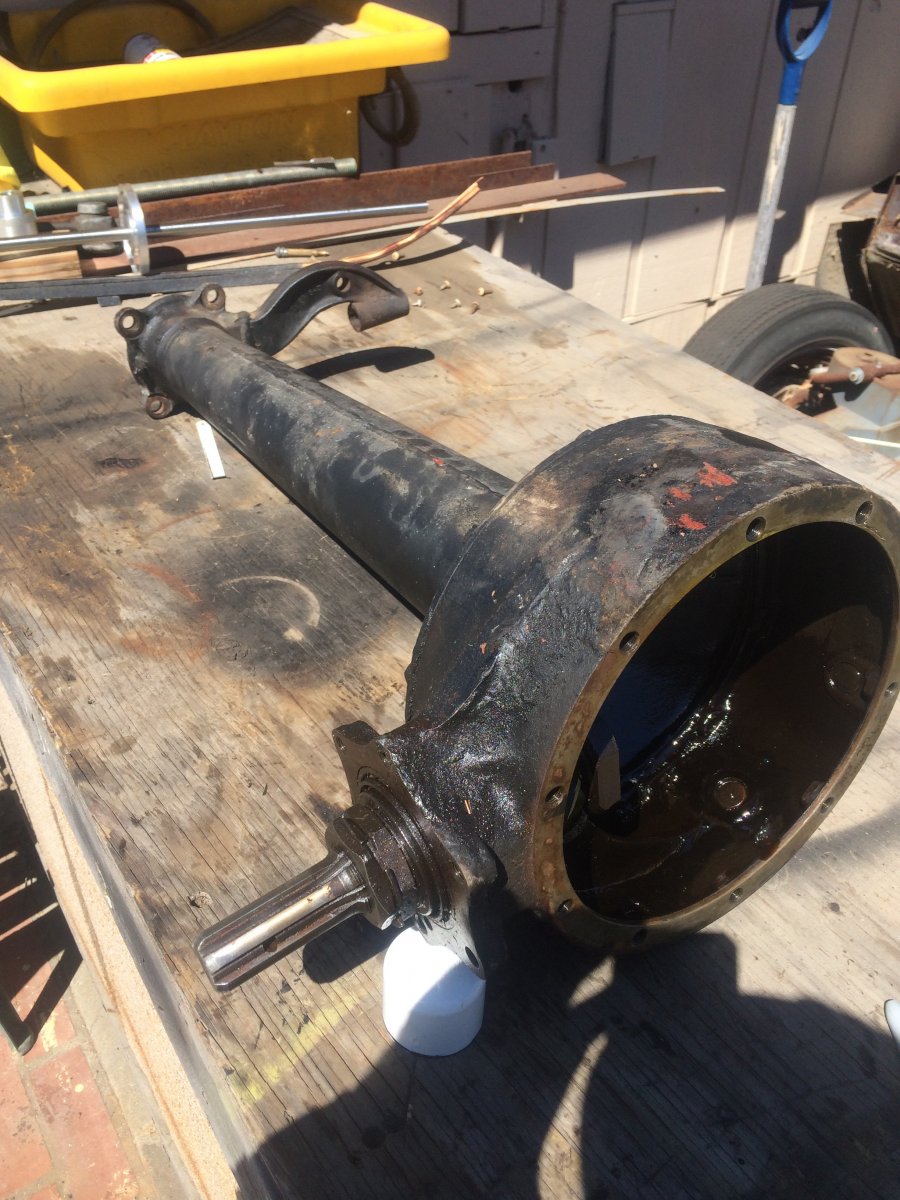

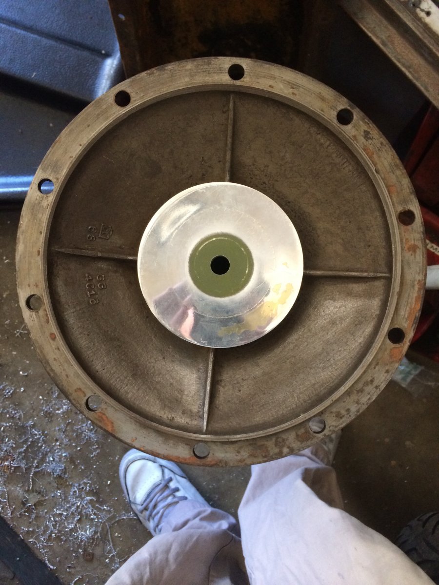

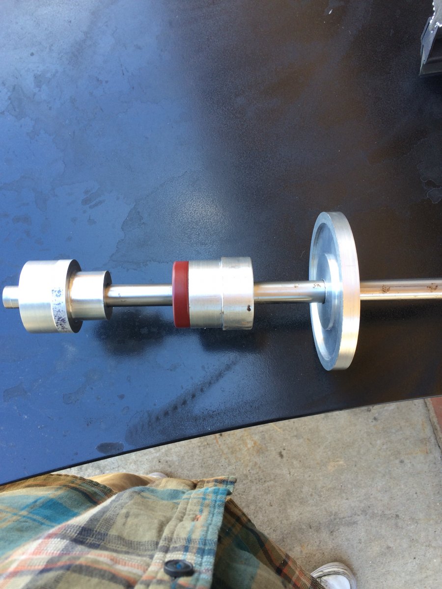

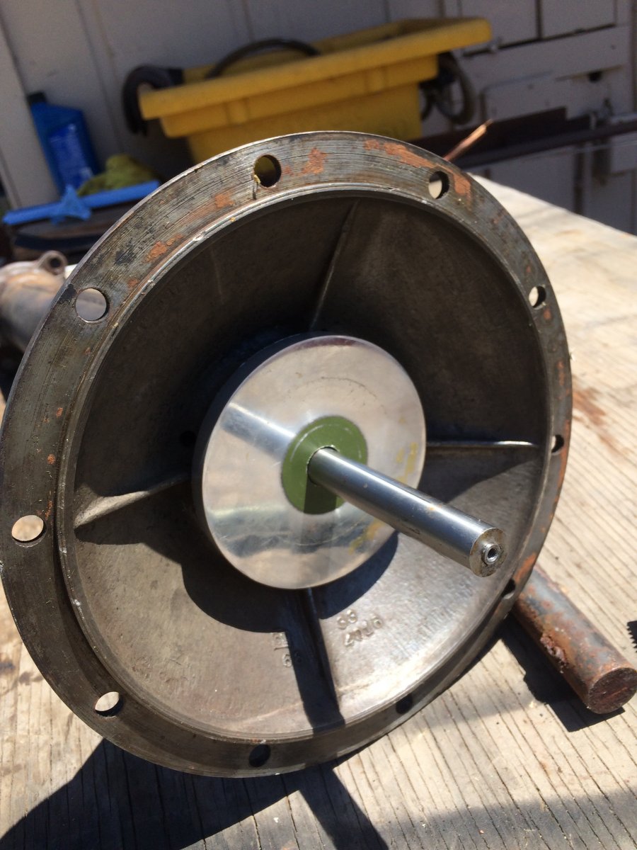

  6. image.jpg image.jpg image.jpg image.jpg image.jpg Well iv been thinking hard for a few days on making a seal installation tool for the seals that go all the way deep inside the rear axel housings. I couldent find one so just like back in the day I have been putting a few hours in on my lathe. Kinda of cool I'm using my 1946 Logan to make tools to work on cars older than my lathe. I have no idea of what a tool to do this even looks like as i could not find one on the internet. Someone said macs sells them but could not find one on their web site. So I hope y'all will like mine. I should have it finished up here by noon. So I made a guide that fits snug to the pinion side of the tube and a guide for the brake side. Then I made a holder the same size as the axel to hold the seal in place so it won't fall off in the tube. Then I machined two end mill holes in each side of the seal holder to press in a 5/8 bar of stainless. So front of seal holder and rear will have pressed in bar stock. Line up guides and press in seal all done. Where's my trophy....
    Okie Pete and bengeltiger like this.
  7. image.jpg image.jpg image.jpg image.jpg So it's 11:30 and tool is done. Time to go get a burrito... Works really good too. Just a little tap tap with the ol lead hammer and set her home. I also thought about putting threads on the brake set of the tool and then drilling and pinning the seal retainer. Then make up a nice large wing nut style nut to use the thread to pull the seal in insted of hammering it. I will probly do this to it later. Lunch time

  10. Nice Job! You're kind of like me - I just have a small lathe and milling machine . . . nothing special at all - BUT, they have sure saved me a TON of times in making up stuff just like this. Keep the work going and update me on what you've decided to do with the engine build?

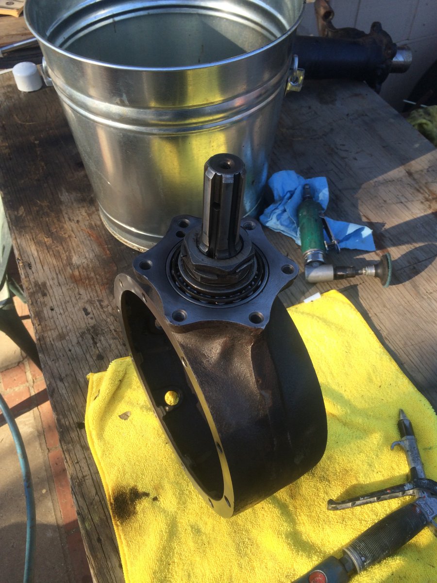

  11. image.jpg image.jpg image.jpg Now that everything is so fresh and so clean clean. I will put it all back together tomorrow bright and early. I can't wait to get it back under the car. I still have not seen the car outside of my garage and I'm going crazy. I need to see how it's gonna sit. NOTE: if you have never tore apart a banjo rearend and you are gonna do it yourself DO NOT CLEAN the threads with a tap, or a thread clean up tool. Ford and many other car parts that have holes with threads tapped into fluids, the threads have a lot tighter tolerances to help stop the fluid from leaking past the threads . If you run a tap into them you could cause leaks. Just thought y'all would like to know that. Learned that long time ago from wise ol man.... He told me only if the threads are beat up to do that but then clean clean clean and use RTV silicon. Use should use alittle RTV anyways.

  12. Thanks dale yea my lathe and mill are small but you know what they say, it's not how big the tool is, it's how you use it:rolleyes: I will be talking with you soon. My goal is to finish up the rest of the car by the end of June. And then have July and August to finish the motor. You know machine shops and their time frames. Lots of work to do. I'm talking off the hole week of the la roadster show so I will have sat-Thursday to get a lot more done then it's on the trailer for the show. Swapmeet area that is:D Not for sale of course just so friends from all over can take a look. It will be good times..

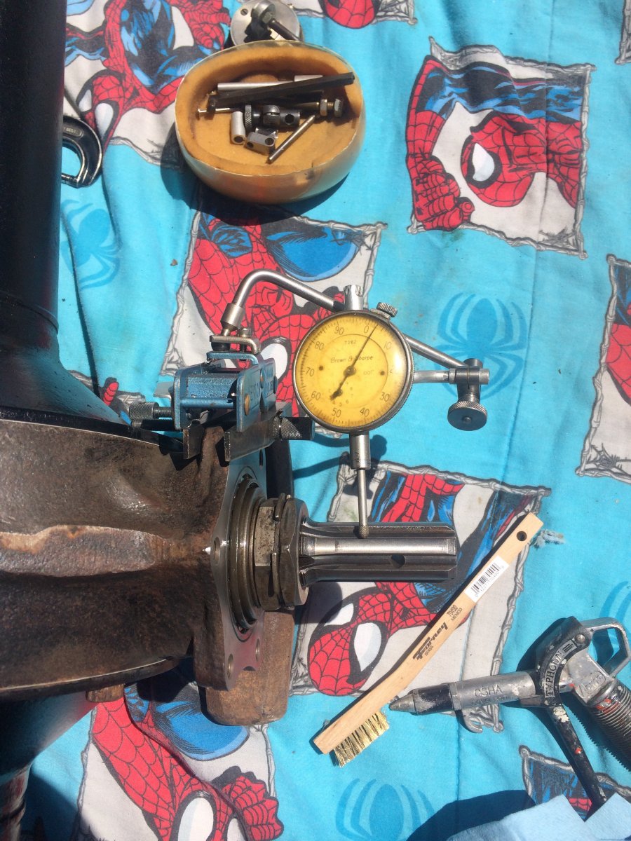

  14. image.jpg So with .005 axel housing gaskets on both sides I end up with .006 pinion to drive gear backlash. So now I can take it back apart and seal it up. I have to be careful here to get the sealant in the right spot so it does not mess with my backlash. I will post pictures of where to put the sealant.
