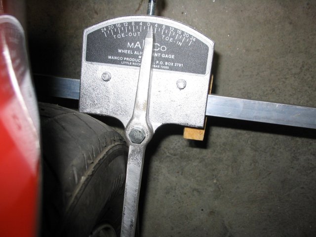

  5. #7....Toe in guage.
    Saw a big version of this for use on semi-trucks at work so I decided to copy it for my own use. It works great because on alot of rods you can measure the front of the tire but the engine or radiator interferes with the tape measure on the rear side of the tire. To use it the car would be jacked up just enough so the front wheels would rotate. Then you could mark the tire where the pointer points, roll the tires 180 degrees and measure between the marks. You would have to know the measurement between the pointers before you put it in place.

    Not homemade, but I got it as a gift, so...was cheap for me at least! I think Eastwood sells 'em, but it would be simple enough to make one. The dial is on one end, the other end just has a 90* fixed bar on it.
