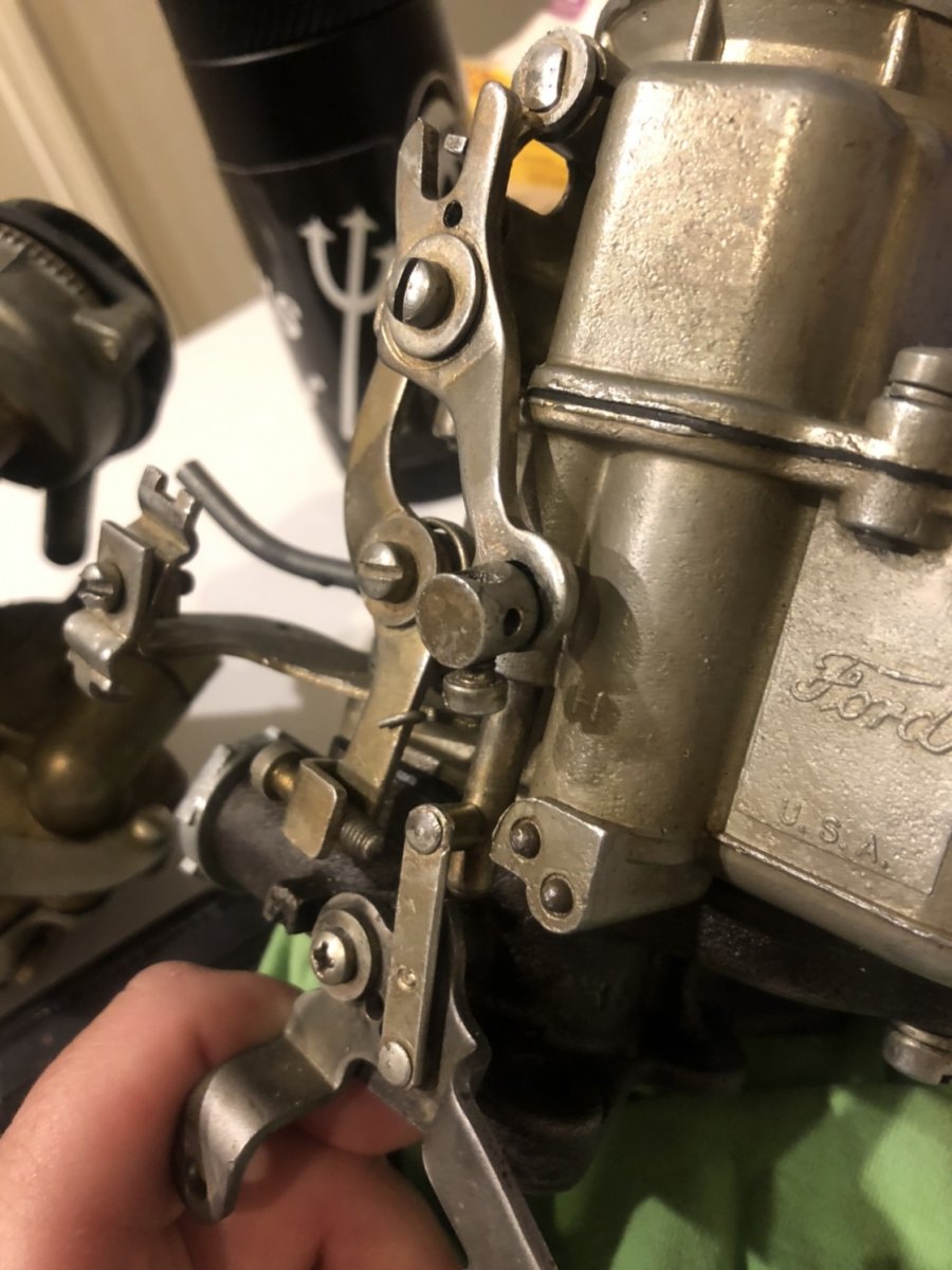

    Yesterday I went and made the stop for the idle, I used some washers and Jb weld to fill in the center since The circumference was too large for the post. I also decided to take the choke control attachments off of the old carb and put it on the ‘new’ carb. Basically she’s a Frankenstein monster of the two carbs combined lol I haven’t got a chance to try to start her, I’m going out there when it’s cooler tonight .

    ^^^^^ Recheck your manual choke. Cable needs be at horizontal as compared to the 45 degree as shown above. Inner cable (solid wire) it's self needs to be straightened as well.
  15. Yes, I just put it on to mock it up for the pic. Still need to adjust it and tighten too. I’m so excited, you all have no idea! It’s been over a year since I’ve driven her. So thank you!!

    Last thing...please rework that manual choke cable so it is horizontal with the intake manifold as others have said. It's not going to work in the configuration you posted.
