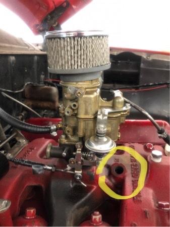

  1. [emoji47] it’s missing a part on there?!? [emoji37]
  2. I took out a plug there to check on the vacuum, just didn’t put plug back prior to pic

    True, but you can still set the idle with one. Problem is all choke and fast idle cam is missing, among other things so idle screw is useless

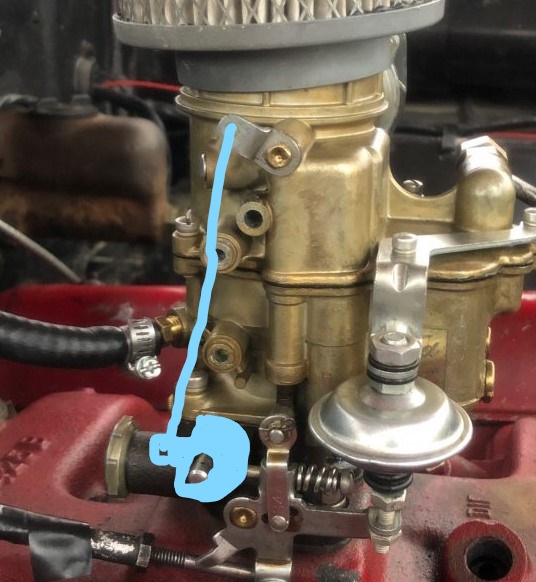

    @Christie here are a couple of photos I've drawn on, one I stole from the internet and one is your carb. The first photo is of a carb with no choke so it doesn't have the black plastic choke cover on it, but I drew an arrow pointing to a disk that the idle speed screw touches. The idle speed screw takes the place of someone sitting in the car and holding the accelerator pedal slightly down, which is what you have to do in your car to keep it idling. When you let off the accelerator your carburetor is cutting off all air flow and the engine starves. The second photo is one of your carb which I have also drawn on. There is a rod from the top of the carb which is attached to a lever on the choke. At the bottom of this rod there is a part that is not round, but rather has an increasing radius on the side that the idle speed screw touches. When the choke is closed, this "cam" is moved to a position that holds the idle speed screw open a little further, so that the car idles faster when the choke is closed. As the car warms up and the choke opens, the cam rotates in sync with the choke and lowers the idle speed. You are missing this fast idle hardware.

    This is the original carb I had on her, it had a issue with always running rich and leaked at the intake manifold. When she stopped idling for me I bought the new refurbished carb thinking that was my issue. But apparently it’s not. Lol it’s a vacuum leak according to most of you guys. I’m still confused As to why the vacuum gauge read appropriate numbers but I still have a vacuum leak. Wouldn’t it go into the red zone if there was a vacuum leak?? Ty bunches guys
