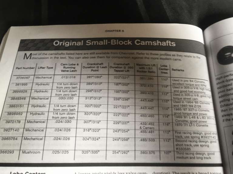

    Another source, showing GM "off- road" cam specs
  5. 2OLD2FAST
    Joined: Feb 3, 2010
    Posts: 5,996
    2OLD2FAST
    from illinois
    This helps to explain some of the confusion surrounding these cams , thank you !
