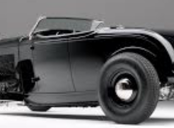

    Looks great
    That’s how this one is sprayed

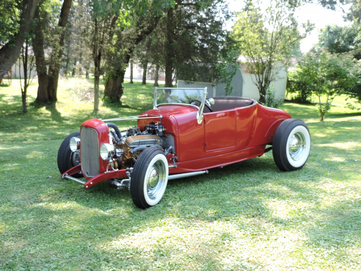

    This ones single stage with hardener sprayed in my 2 car garage and cut and buffed. No clear, I just don't like the plastic look I think clear gives. DSCN1235.JPG

    Absolutely looks great
    The cocktail clear/single stage doesn’t look plastic either
    That’s why we do it. Looks very deep in black
    Not a big fan of newer high solids clears

    I agree with jimgoetz above about the look of most clears. They usually make the colors look too fake or plastic.
