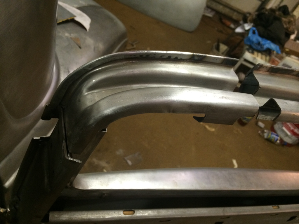

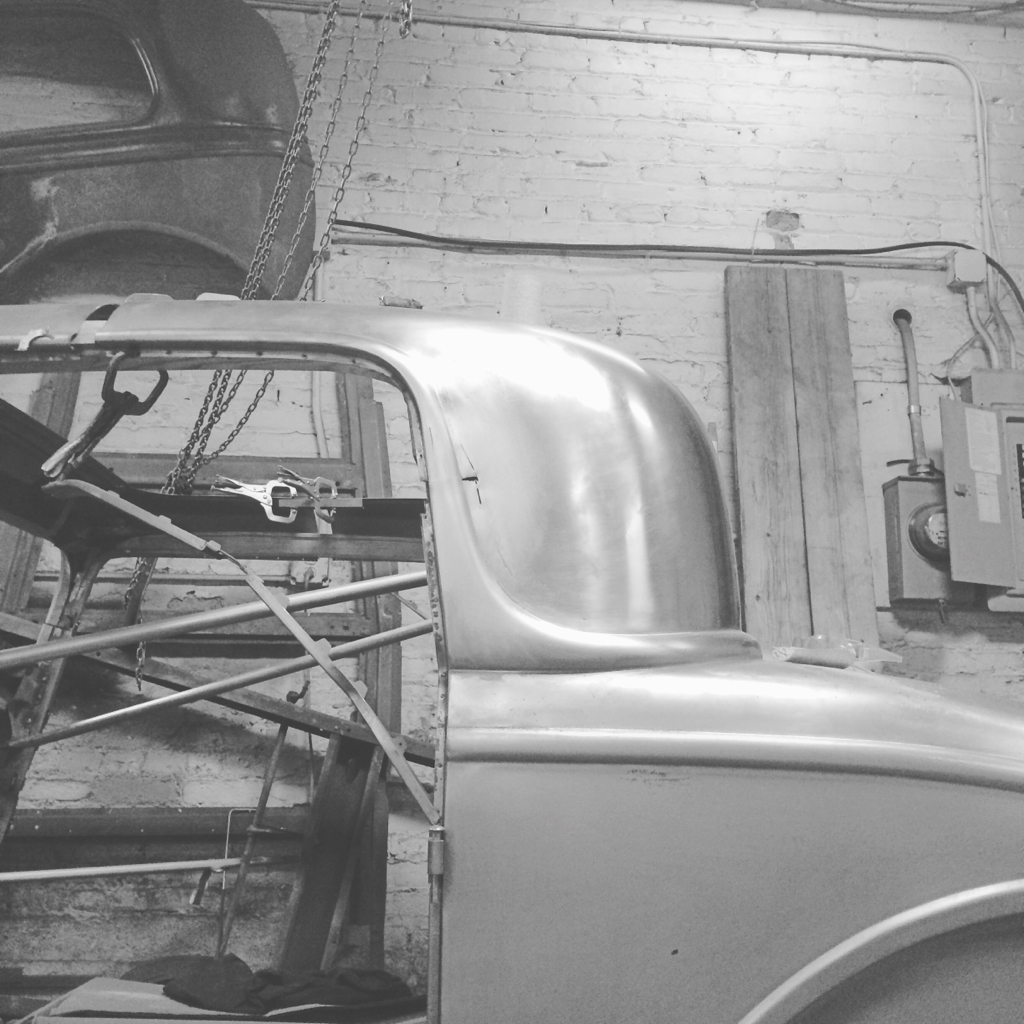

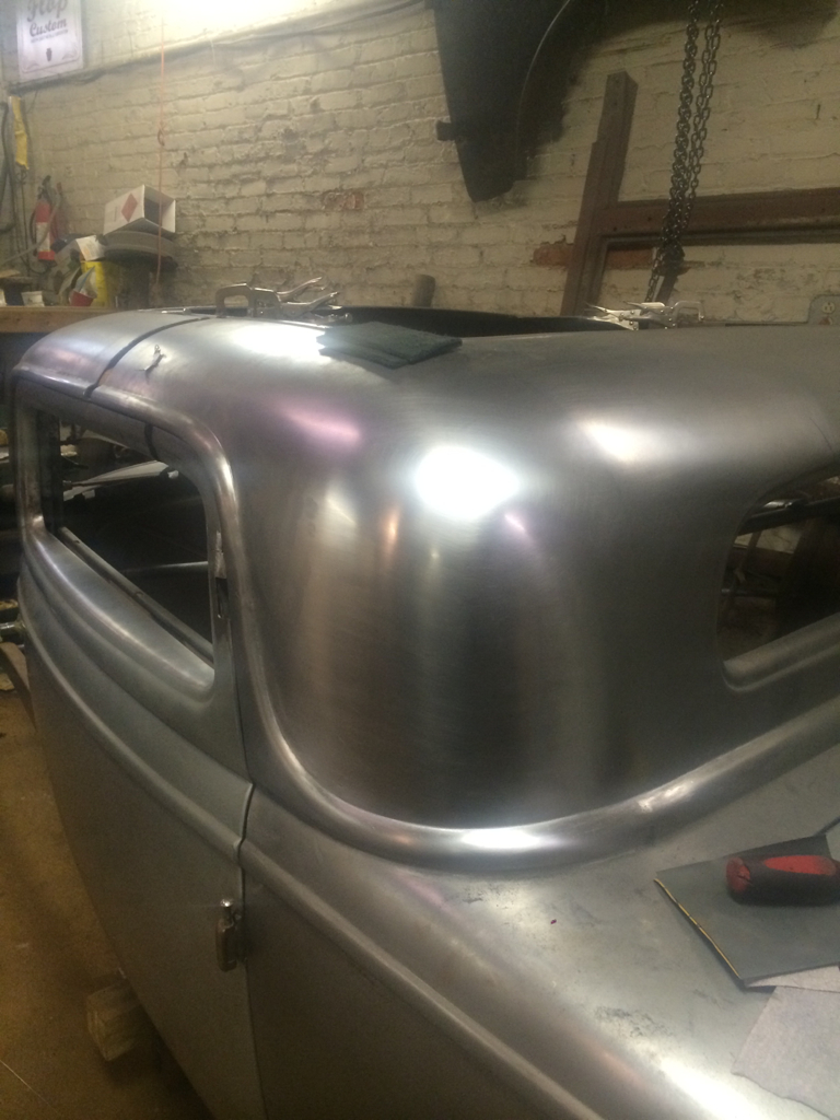

    Thanks guys . I think there is a place for both leaned pillars and a sit roof . Bonneville styled lean em . Hot rod split the roof .
    Before the reveal was reshaped
    Reveal is in . Little more welding to do . Whole lot of work to get that area lookin right .

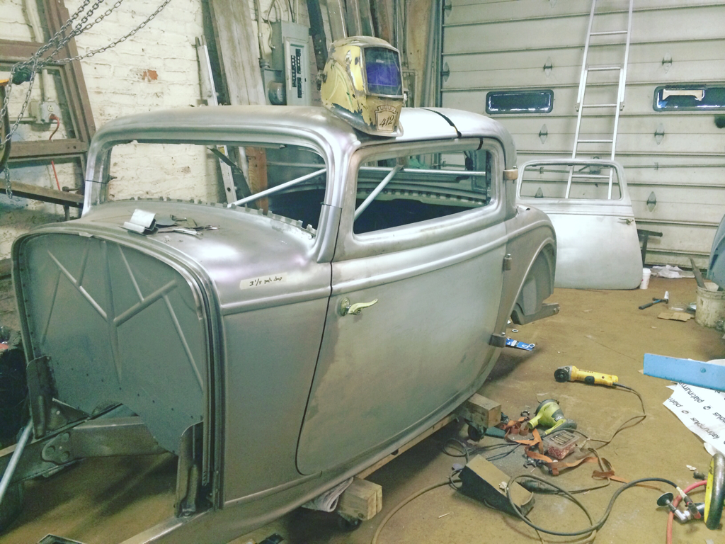

    I would add, regarding the leaning back of the windshield posts, that there was so much effort already expended in cherrying out the cowl, that it would be wasteful to cut it to lean the posts back. Hence the decision to stretch the roof.

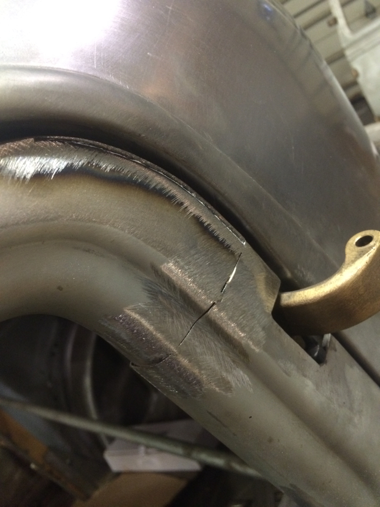

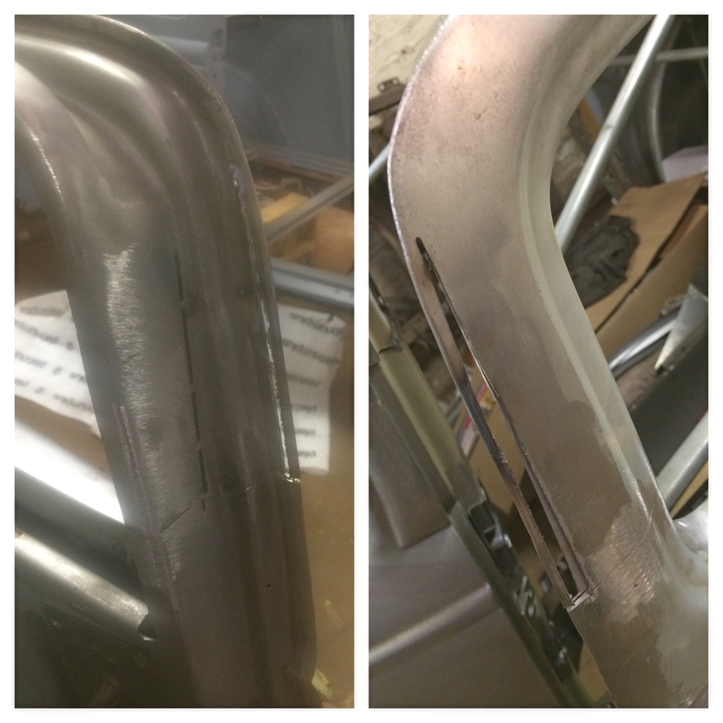

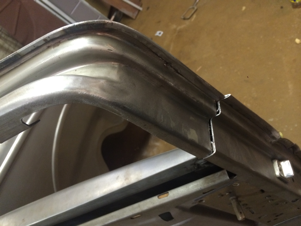

    Fantastic attention to detail. The quality of your work is inspiring. I've been struggling with the decision to lean the A post or stretch the roof of my 32 3w chop. You have helped me make the decision to stretch the roof. Do you have more pictures or sketches of the cut lines to fix the reveal? Most chops I have seen cut the top straight around from the top hinge area to the back window. I like how you cut lower. Seems like a better way.

    Flop, are you using mig or tig??

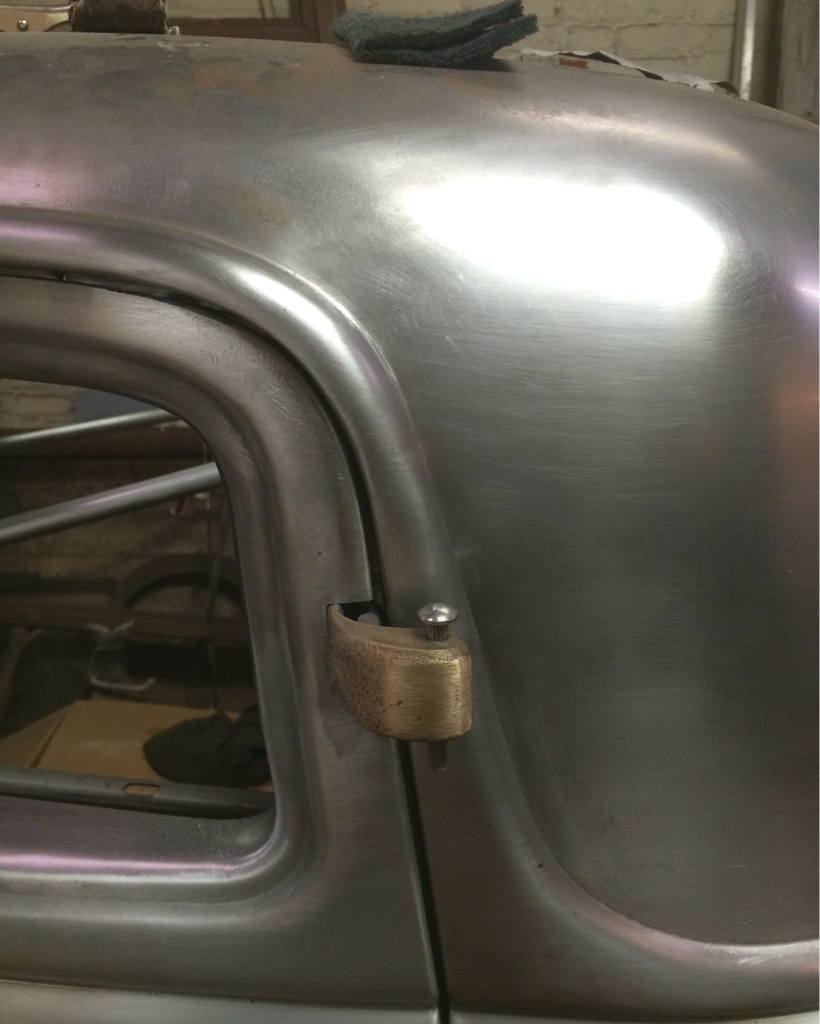

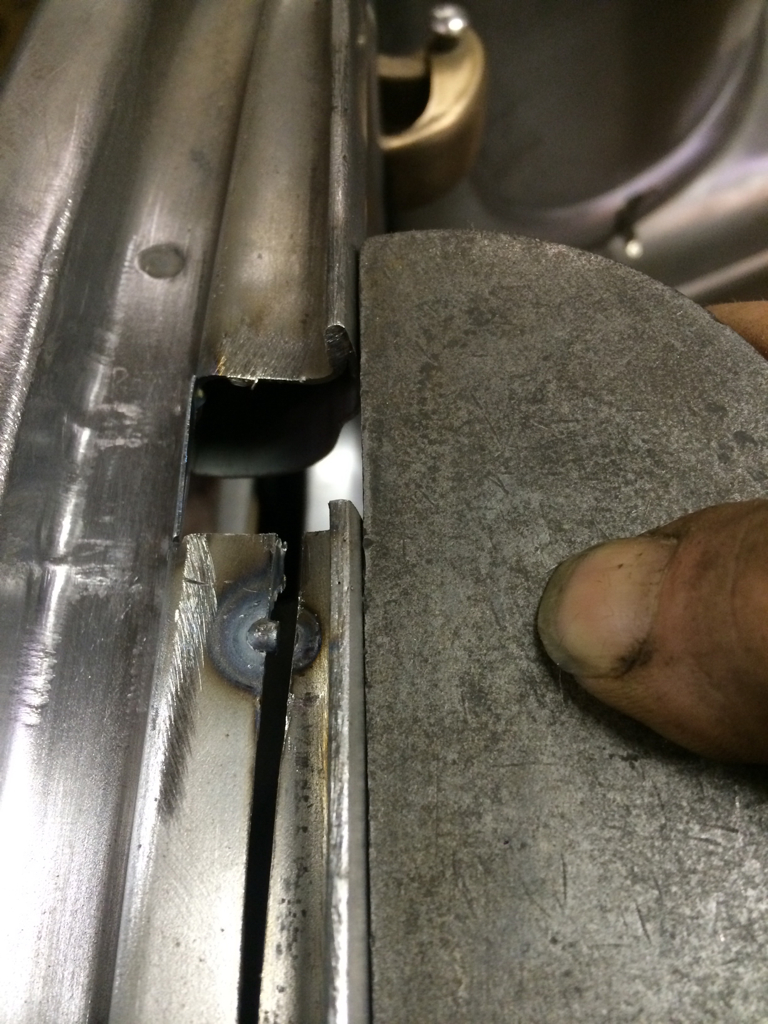

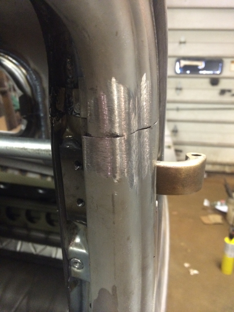

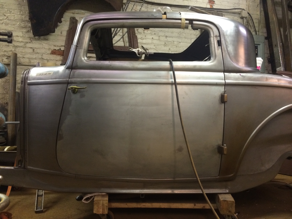

    Reveal is finished .
    All to be covered by a hinge

    I think I would loose that top hinge it ruins the lines a bit
  15. alchemy
    Joined: Sep 27, 2002
    Posts: 20,524
    alchemy
    Keep the hinge for strength. The wood post already compromises durability.
    Baron and Als27T like this.
  16. Flop
    Joined: Jun 8, 2006
    Posts: 3,886
    Flop
    Yeah that hinge isn't going anywhere . There is about a 1/4 inch of play without it . You could probably get away without the middle hinge .

    Function in this case beats form. The 3W doors are very heavy and need the support of the top hinge. Every time I have moved a 3W body the first thing to be removed are the doors.

    Would you consider posting a step by step with pictures of your welding and metal finishing technique?

  25. Yes, indeed! Particularly interested in the magic part!

    Curious why your doing the door and not the A pillar first ?
    ls1yj and loudbang like this.
  30. Flop
    Joined: Jun 8, 2006
    Posts: 3,886
    Flop
    Thanks 31
    Bcap hope you chopped some stuff before . Serious chop
    Baron ... Doesnt make a difference . Back of the A pillar is lined up .
