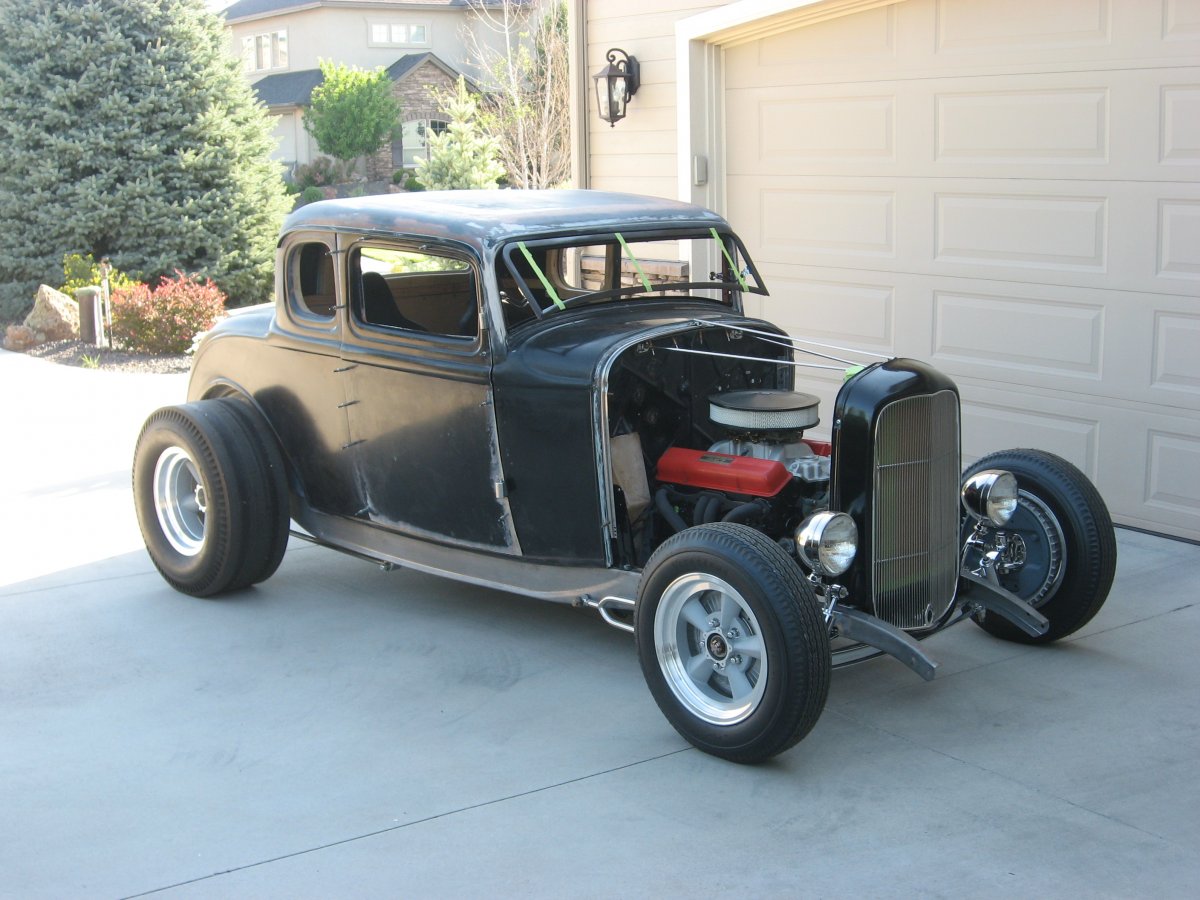

  3. Splitbudaba
    Joined: Dec 30, 2014
    Posts: 874
    Splitbudaba
    What size did you order? Mine are 15" x 4.5" and 15" x 8.5". I also have a set of 15" x 7" for fun. Are you taking the fenders off ?

  4. daveh1932
    Joined: Apr 10, 2013
    Posts: 280
    daveh1932
    from UK
    I'm going 15" x 4.5" and 15" x 7" wanted to go 8.5"s at the rear but didn't quite work. I'm staying with the fenders but want to lower the back end a few inches. The 7"s centralise the tyres better in the fenders than the current wheels and should give a little more clearance

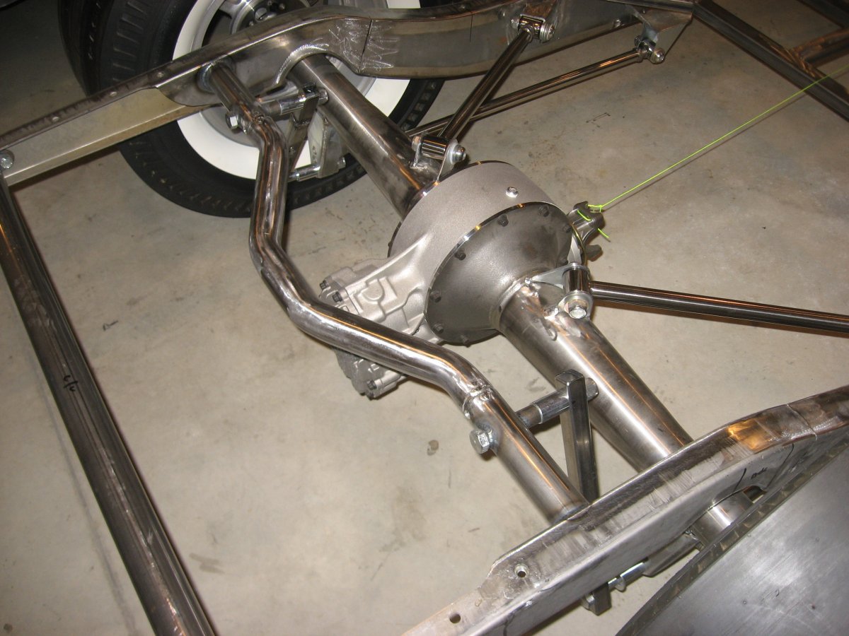

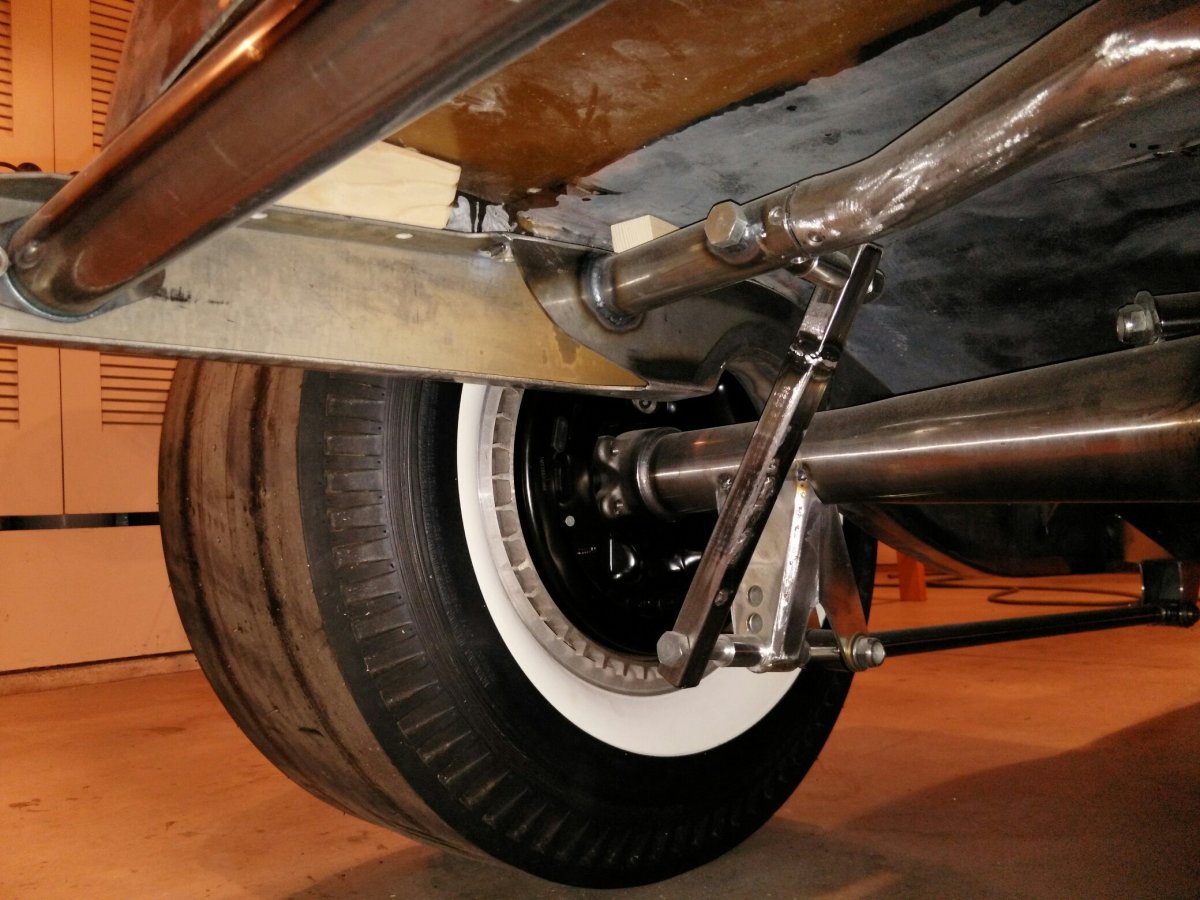

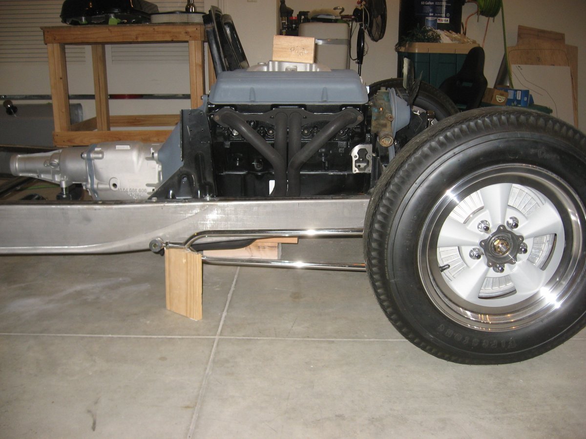

  8. Splitbudaba
    Posts: 874
    Splitbudaba
    IMG_2443.JPG IMG_2439.JPG Found more pics of the frame and suspension. IMG_2426.JPG IMG_2431.JPG IMG_2423.JPG

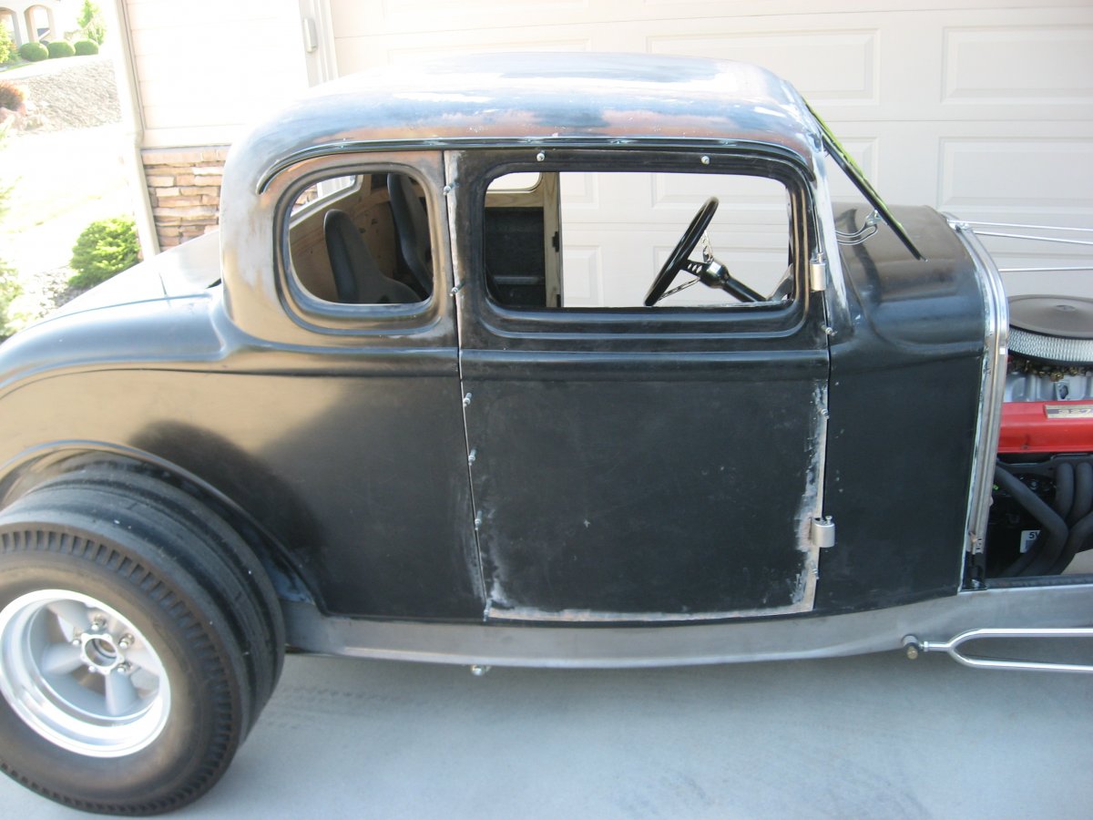

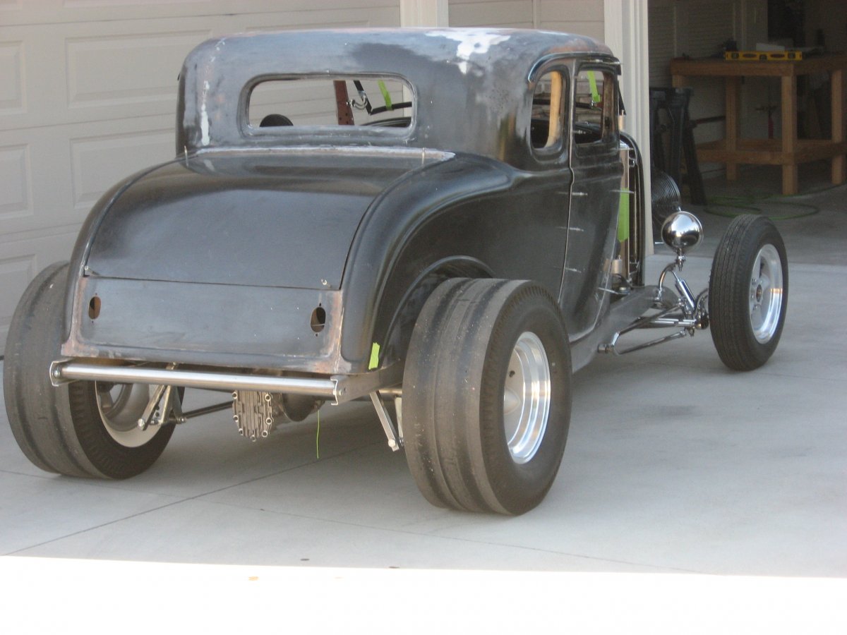

  10. Splitbudaba
    Posts: 874
    Splitbudaba
    IMG_2561.JPG IMG_2562.JPG View attachment 3579835 IMG_2555.JPG Got some work done this weekend, right door is hung after much cutting and reshaping, still needs final trim after latch and window gets installed. Now for the left!

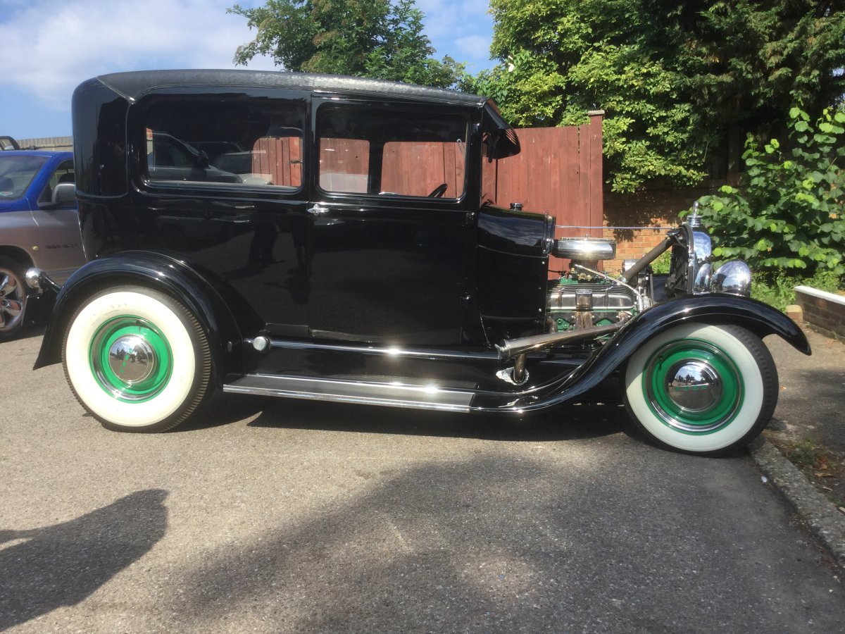

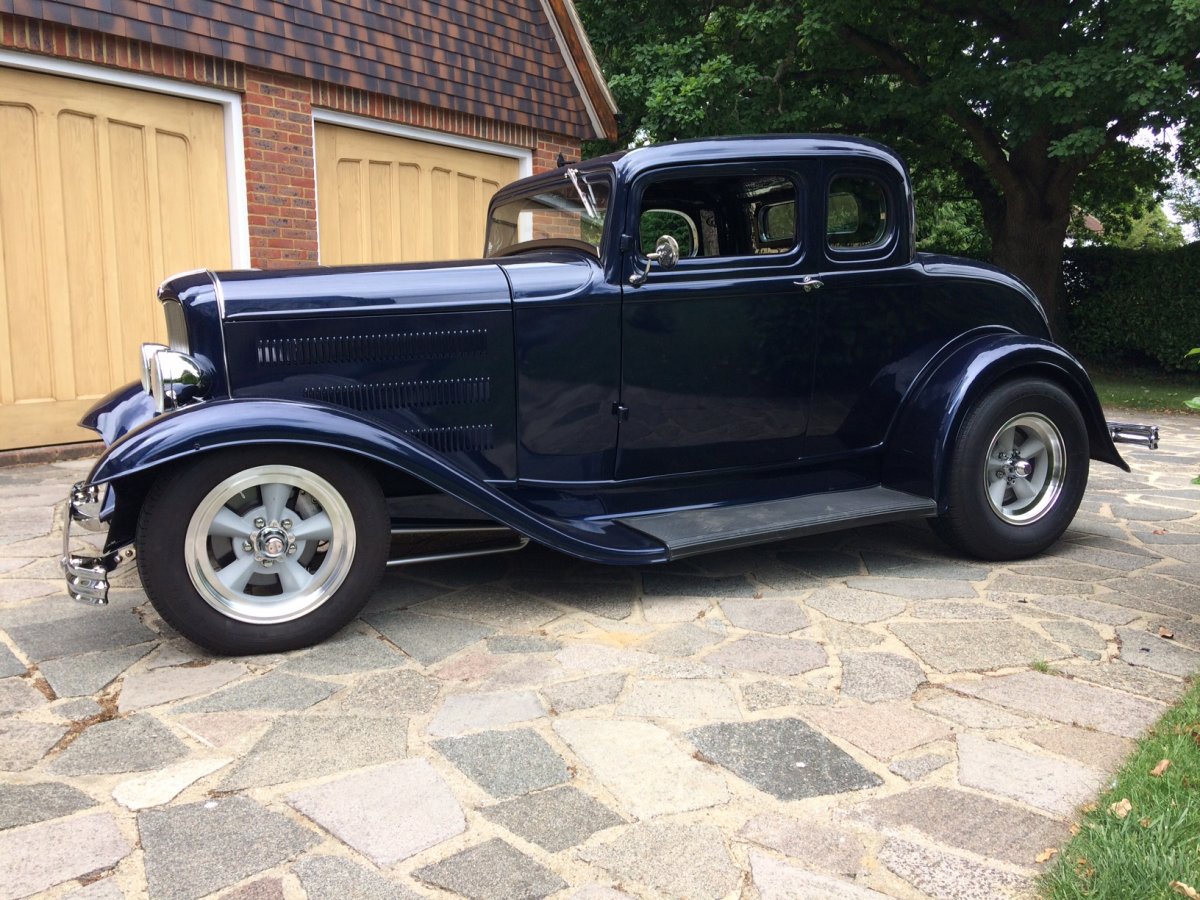

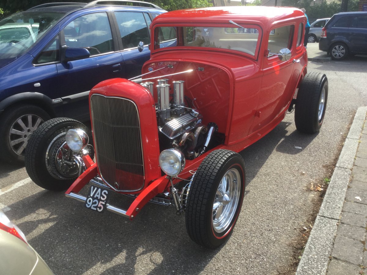

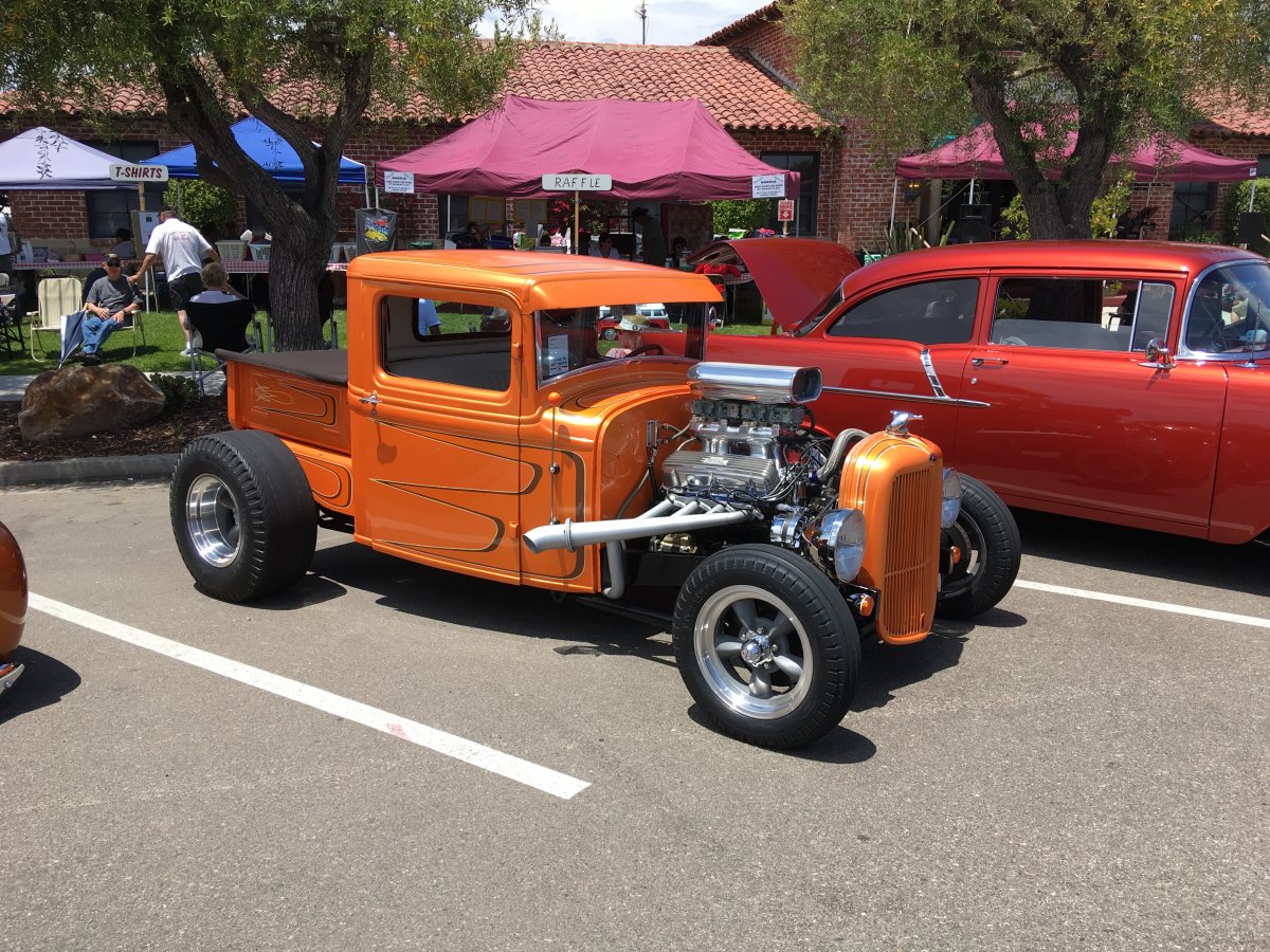

  15. daveh1932
    Posts: 280
    daveh1932
    from UK
    That would be very cool! I went to a local breakfast meet yesterday nice to see this one there:
    Also very nice '28 Tudor (sorry to hijack your thread again!)

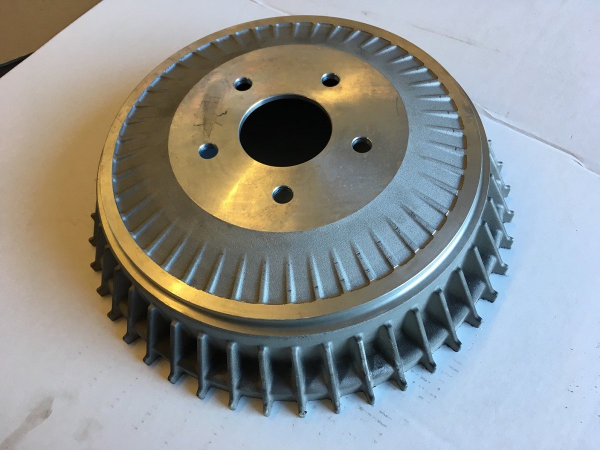

    drum.jpg Getting back on the coupe, just ordered a rear Buick style brake kit from John's Industries. Nice folks! Should be a straight bolt on deal. Kit matches my quick change back spacing, register, big ford outer bearings, and bolt pattern. Looked at using real Buick stuff, but since I have a glass body (the horror) and don't give a rat's ass what other people think, I took the easy way out, not to mention the safest. Here's the drum, looks a lot like the original!! A trip to the glass beader and it will match the fronts perfectly.
  24. daveh1932
    Posts: 280
    daveh1932
    from UK
    They're gonna look very cool through the spokes!

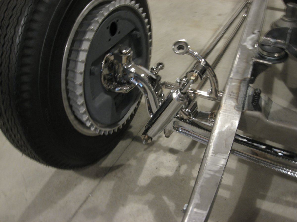

  25. Splitbudaba
    Posts: 874
    Splitbudaba
    Yep I made them send me that pic before I placed the order. Here's the front, very close to original. How's your ride? IMG_2413.JPG

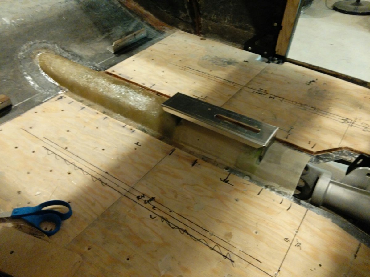

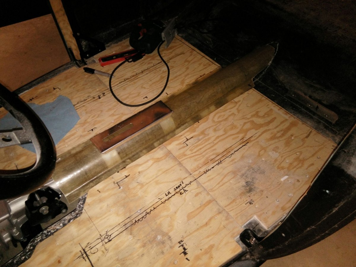

  28. Splitbudaba
    Posts: 874
    Splitbudaba
    c.jpg w.jpg Decided to make a trans tunnel, with a parking brake mount over the weekend. Used 4 1/2" plastic drain pipe to make a mold, and laid up a tunnel panel. Used a steel driveshaft loop to contain the driveshaft, weld to the frame crossmembers and give me a good place to mount the parking brake handle (Lokar). All went well, three coats on the aft section so far. Will put 4 coats on the entire tunnel.
