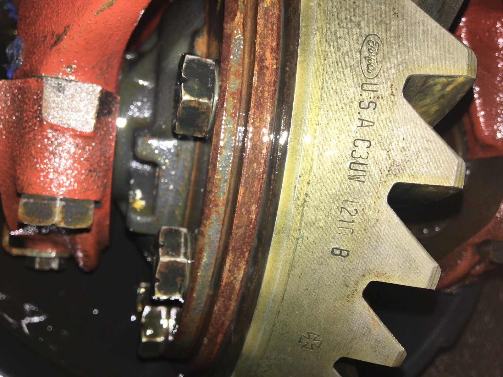

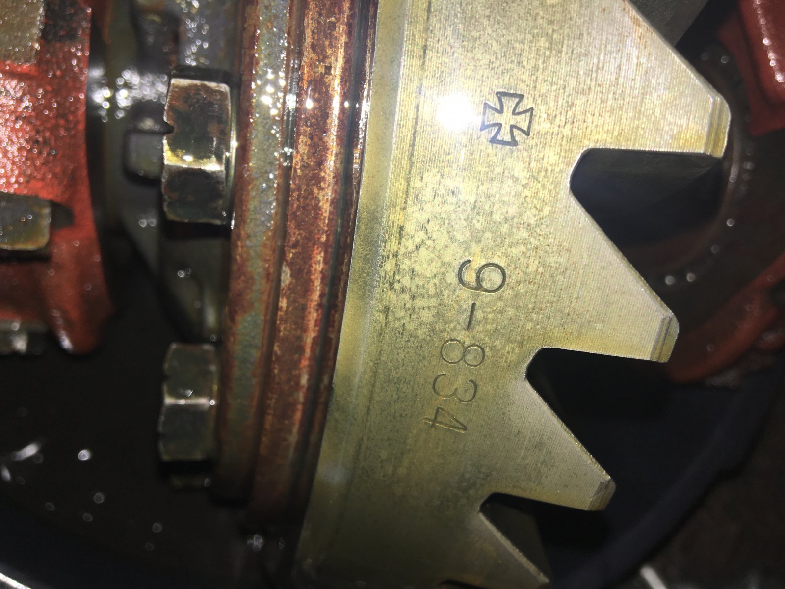

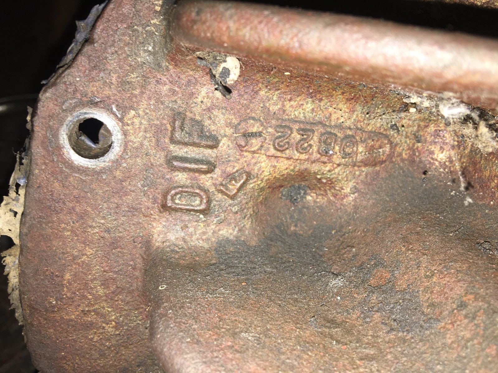

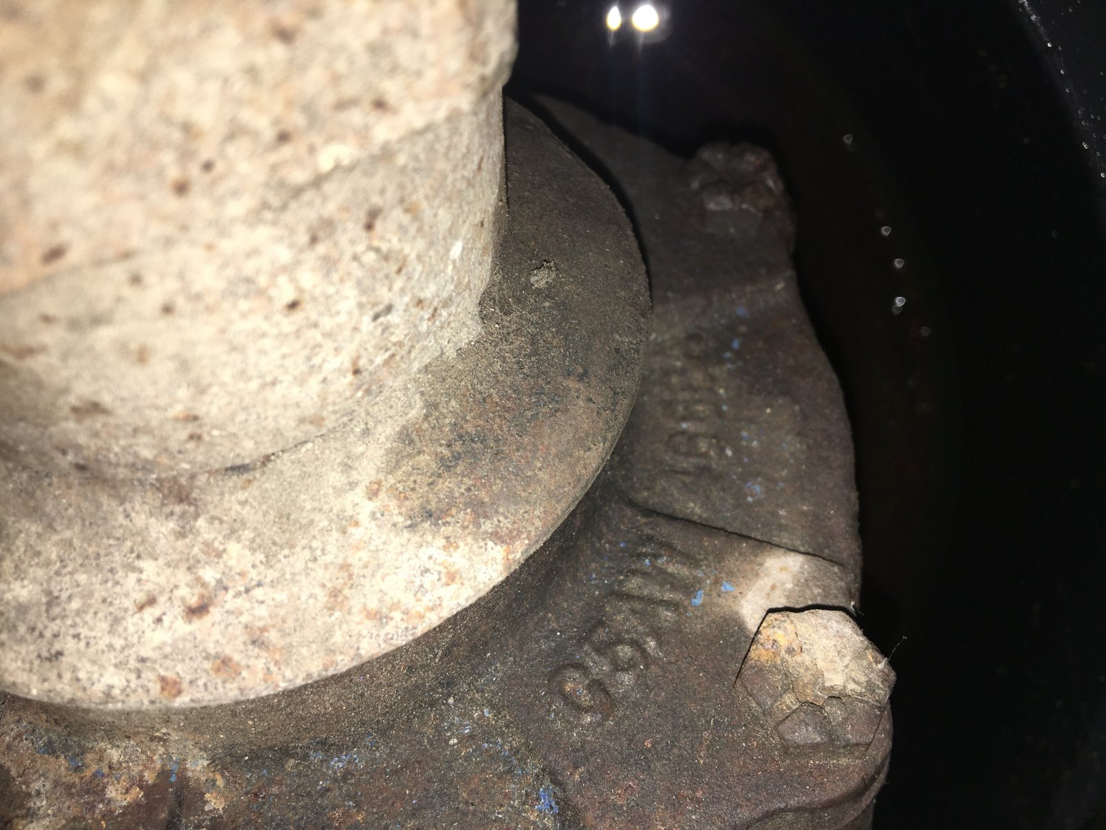

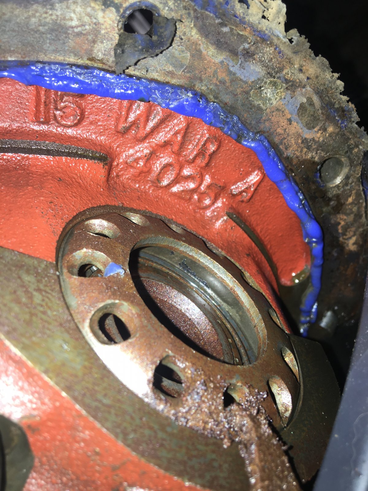

    Pulled the differential out of my Comet. Here are pics of housing and ring gear.
    Anyone decode this? C910EFF7-A84F-4D20-82A0-D45B6C76E7C9.jpeg 7D71DC90-68A8-4667-B680-3A6E15EC697D.jpeg 91BA1D92-44F8-45FF-9525-A6F43FE1C143.jpeg 6422EFD5-5F93-4A2F-AABE-FA9B8FAF4A92.jpeg 3A3D4813-B360-428D-96B4-8A859448809F.jpeg 94F01AE5-AF56-4D8B-8F95-0CF841703869.jpeg

  3. The front pinion support is a 1965 casting revision 'A', which would probably extend into 1966 unless engineering changes took place, then it would be 'B'. The ring gear is 1963 design. The WAR case was used for a number of years, and that one cast either February 22, 1960 or 1970 (if that is a zero, which it appears). The actual assembly date would be on a tag that was on one of the bolts holding the center section in.

    The code on the ring gear is not 1210, what appears as the initial 1 is a shallow stamped 4.
    The code is C3WU 4210 B. That is a Ford ring gear part number, from the C3WU 4209 B ring and pinion set, which I think is 3.25:1, but that can be confirmed by counting ring and pinion teeth, and math. If that is the correct ratio, there will be 39 teeth on the ring gear, and 12 on the pinion. 39 divided by 12 is 3.25. Substitute whatever counts you find to get your ratio.

    Very close- the date like C4 actually refers to the year model vehicle that the casting was designed for, so a C4 casting would probably actually go into production sometime in 63 for installation in 64 MY vehicles. C= 60's decade, 4 is consecutive year. The car line code tells you which car line paid for the engineering for the casting, A is full-size Ford, M is Mercury, Z is Mustang etc. Last is the division, E for engine etc. Base numbers, as you said, refer to the type of casting, 6015 is always an engine block, 9425 an intake manifold. Last is the suffix that tells you what exact casting design it is. DIF was Dearborn Iron Foundry. OB22 is the date it was actually cast, Feb 22 1960. The casting number would not change unless there was an actual revision in the casting, then a new number would be generated

    So who's going to explain the WAR code, and all those similar ones that were used well into the 1950s?

    Some of those were used into the 70's. I think they may have been data book codes. I remember rear ends having WAR and WDC, but it really didn't directly relate to the parts system. However, you may need that code to get a correct part. Ford's part numbering system made sense since you could tell what a part was by the basic number. The rest of it didn't always make sense. Casting numbers and engineering numbers look just like parts numbers but don't directly relate to a part.

  11. And if you look at the number on the ring gear C3UW 4210 B it would actually indicate 1963 Econoline.
