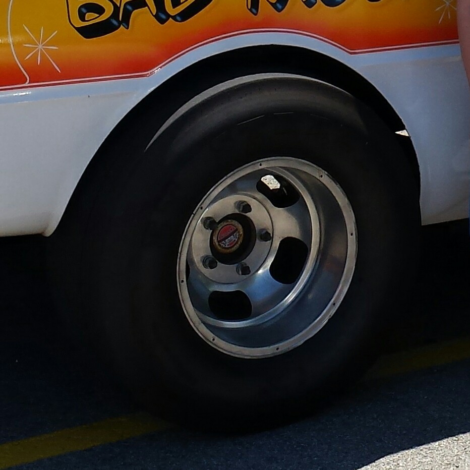

    Take Blasphemi for example, there has to be no down travel in that rear suspension, but it is street driven. Maybe the coilovers are cranked for street duty, or swapped out?
    Is it typical of drag cars to run with no suspension travel? I have ordered some books on chassis design, just wondering on stuff while waiting for them to come.
    When I built my model A, I went with a triangulated 4 link and coil overs. I get about 2" of suspension down travel and feels like they would be the min you'd want on the street.
    The picture below looks it would have 1/2" at the most.

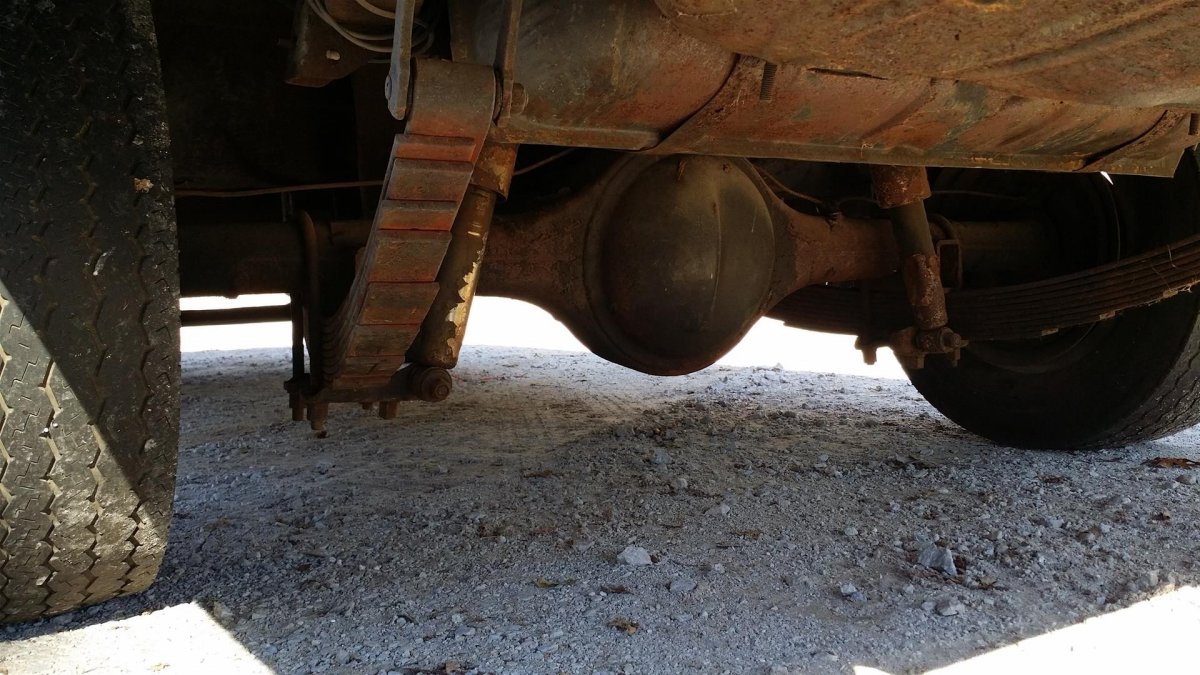

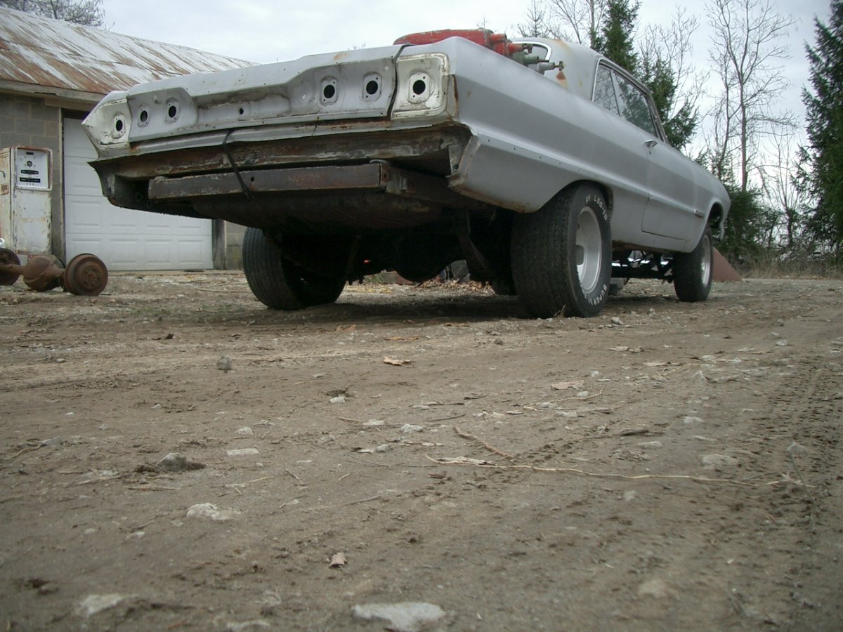

    I have a 63 Impala that was turned into a drag car in about 1966. Has a beam axle front end, Olds rear, leaf springs at all four corners. Very little rear suspension travel. The back of that car is STIFF.

    Someone went to a lot of trouble to get the Impala to set on 4 leaf springs. Hope it was worth it. Looks good , but that's a x frame car with coil springs on all 4 corners. Maybe they sit it on a different chassis.

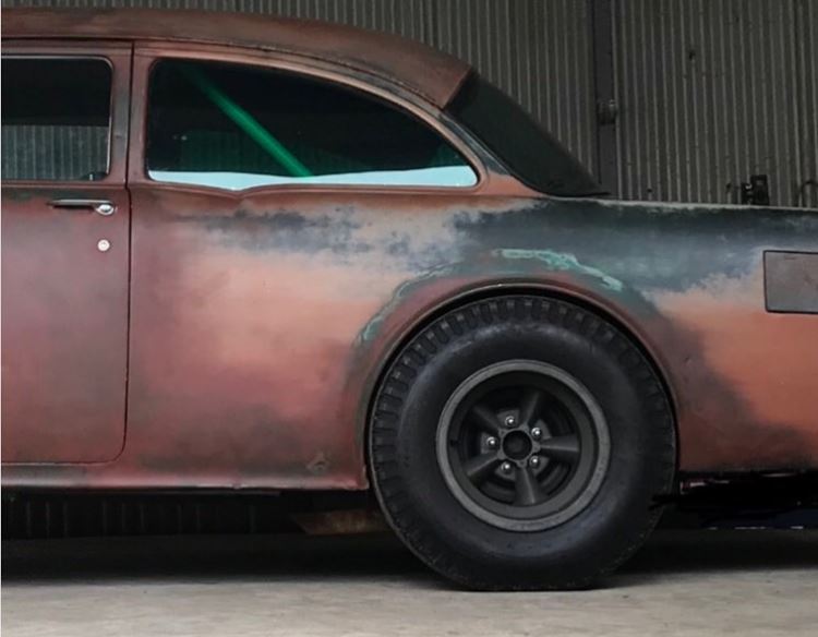

  10. This is where I ran mine without issue, but it looks better a little lower 20140712_135643-1.jpg 20190601_010727.jpg
    This is where I think it looks the best, but it's really a trial and error process with springs settling over use.

    It is on the original 1963 Impala frame. Leaf springs were added to it.
