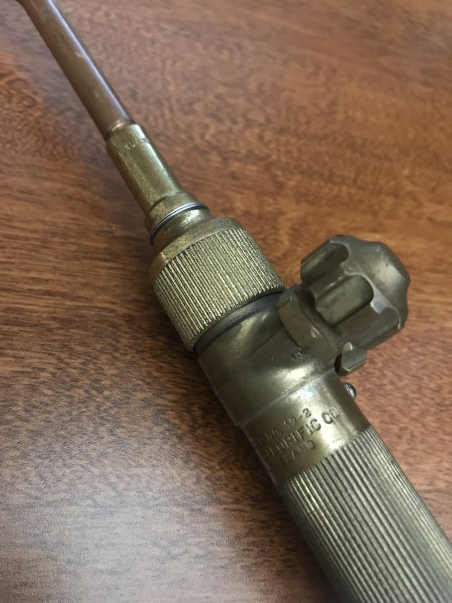

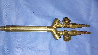

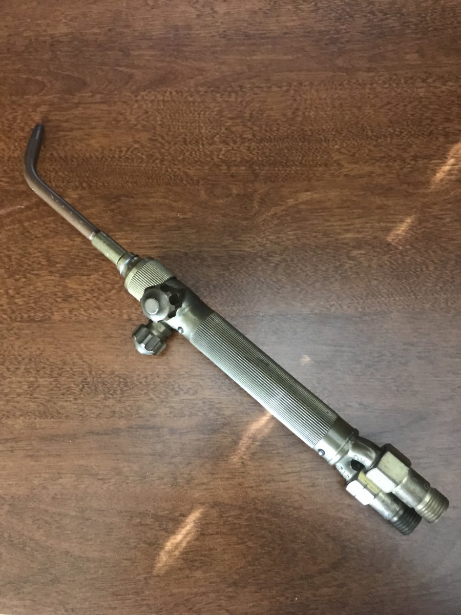

    1B1B25BF-F5F9-4914-A2FE-116EA8701F34.jpeg 695C8983-AA5F-4C60-9526-4FF556E62ED3.jpeg View attachment 4124738 My 50 year old Craftsman set still serves me well, but I did pick up a smaller handle along the way.
    The Harris Model 19-2 is 12” OAL with the check valves and I find it much more handy and less tiresome than that old Craftsman.

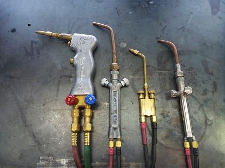

    I have Vector's and a Meco Aviator Jet
    This picture give a good comparison.

    Damn.... That's an impressive demo! Never seen one... But I sure think I'll be looking into that setup! I have a nice hypertherm 600 plasma, But Geezuzzz the consumables are about $75. A set of 5/5 a complete set....

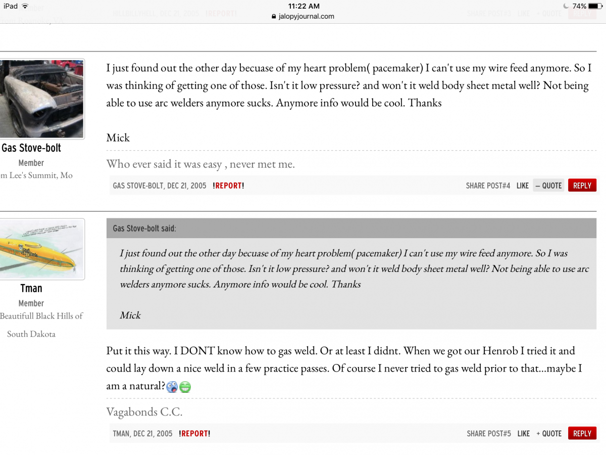

    image.png Gary, took this from another thread about heart and electric welding stuff. The thread title is " Anyone have or use a Henrod 2000 torch?". I think they are now called a Colbra DHC 2000!
