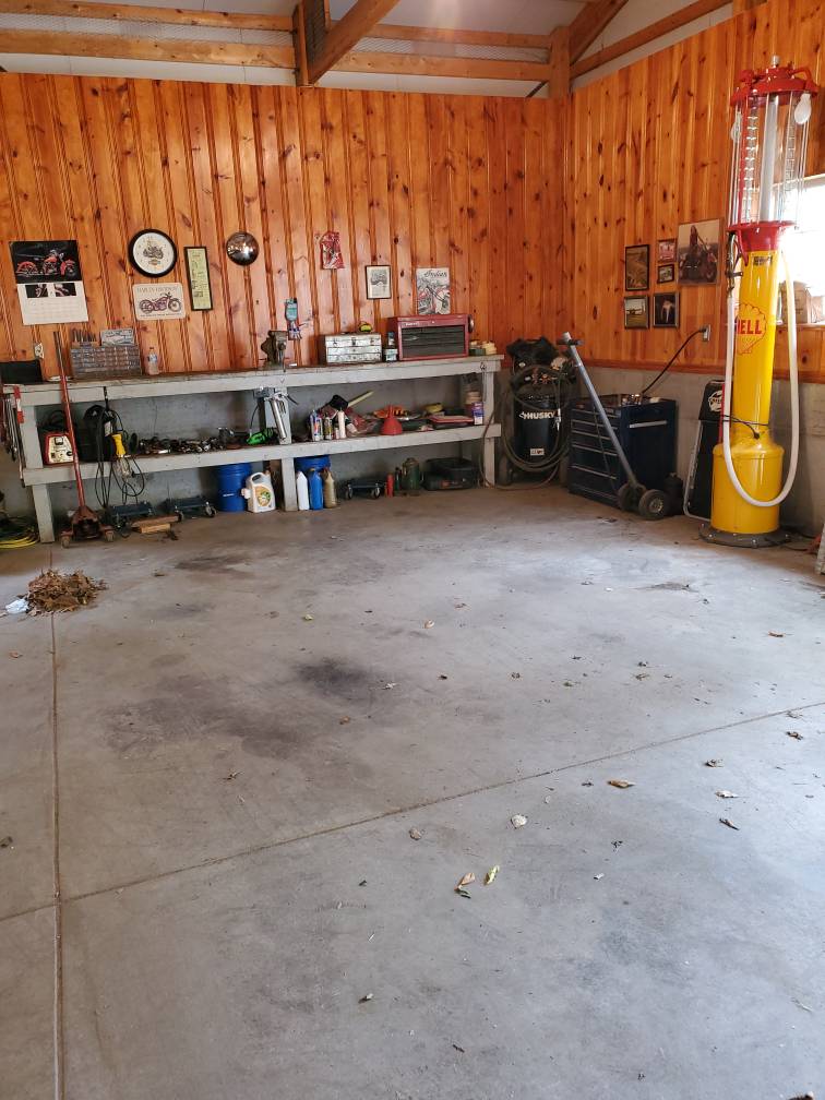

    I'm thinking of putting tile down on my garage floor in the corner where I park my hotrod and dirt champ car. What is a good durable tile? My garage walls are already done in knotty pine, so why not put tile down in part of it? 20200809_121437.jpeg

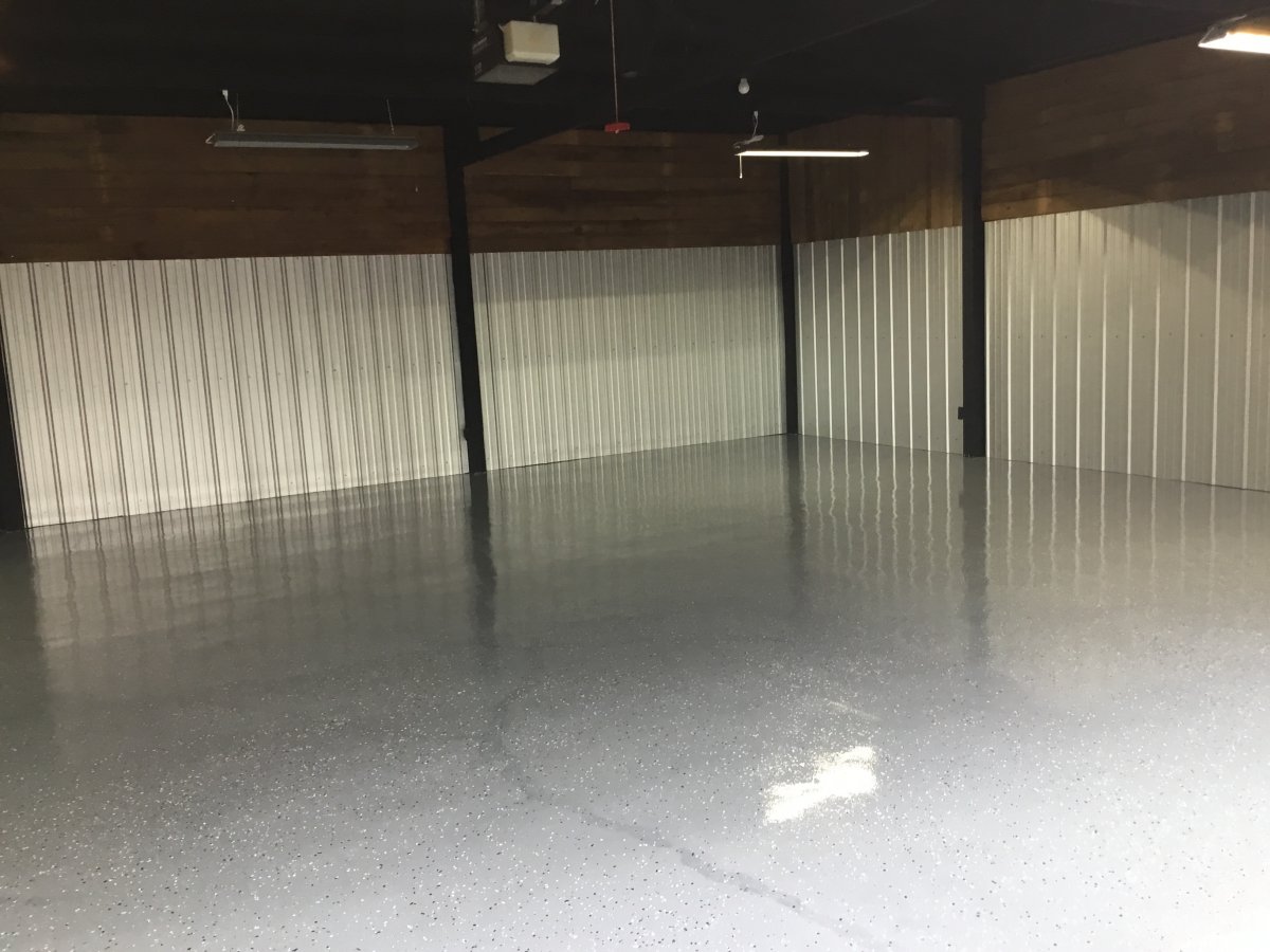

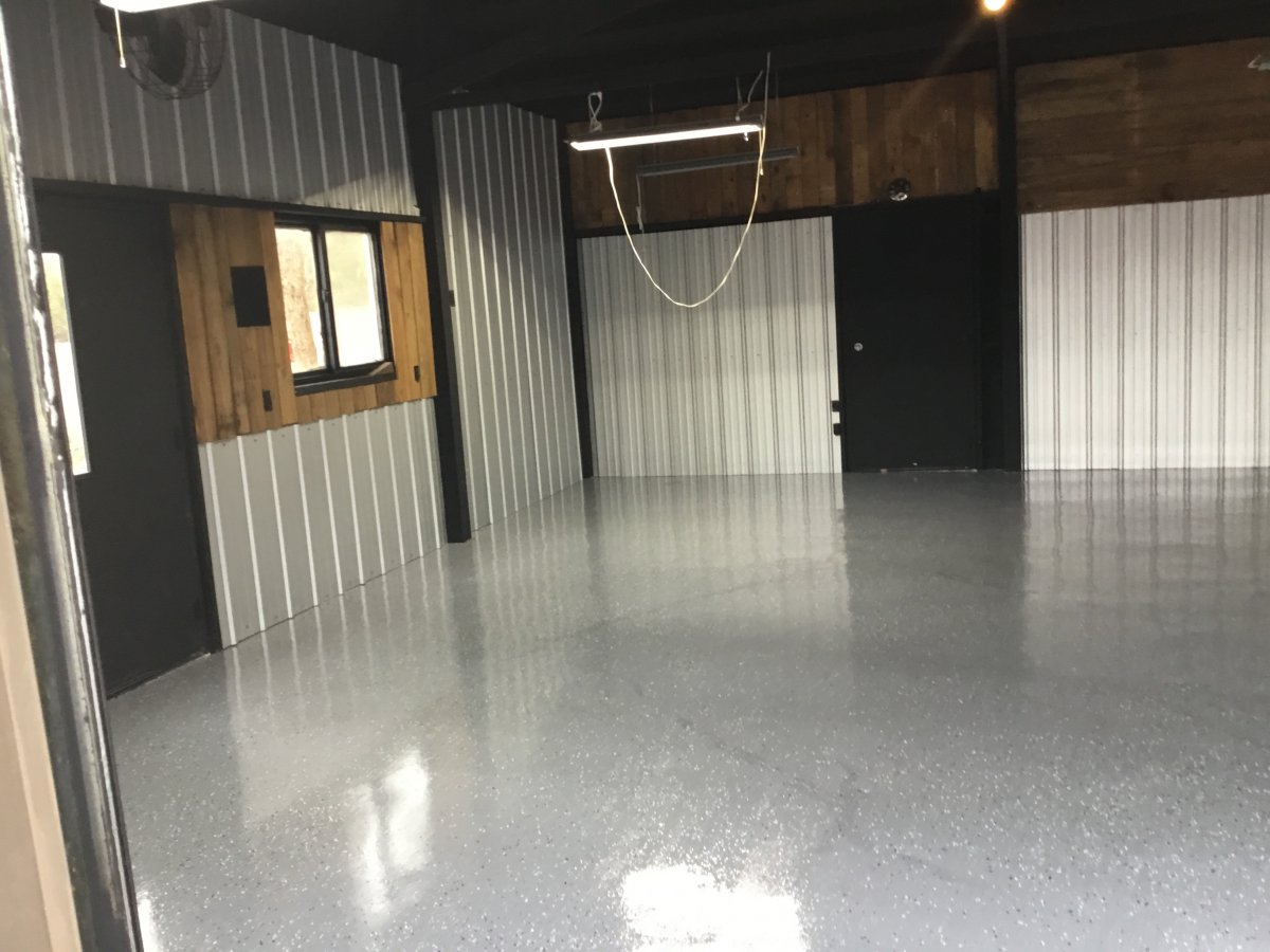

    Not tile, but easy and cheap to do! And looks great, with his wood trim! FBD016AE-EC9F-4DC0-B5B3-B421B759D123.jpeg 9DFCF0A6-DC76-465C-881D-AFB1585289C9.jpeg This is my friends garage. He got it at Lowe’s and it comes in two parts and a multitude of colors.
    Bones

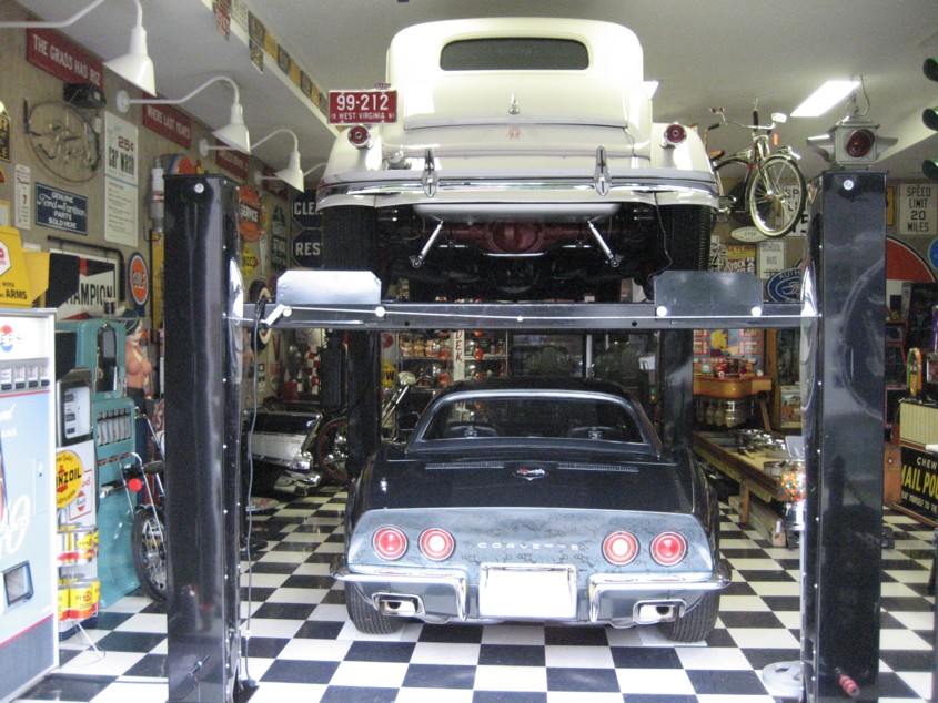

  24. I installed Armstrong commercial VCT in The Hot Rod Grille when I built it 12 years ago. Since then it has had gasoline, oil, antifreeze and other liquids spilled on it with no major damage. I did put three coats of wax on the floor after the installation. When using jack stands I place a piece of plywood under the stands to avoid damage. This is a hobby shop/garage and does not get the abuse that a commercial shop might get. If I'm planning a social event in the garage, I damp mop and run a buffer on the floor tiles to bring the gloss back to the tile. FWIW, I originally put epoxy in the area under the lift and was very disappointed with the look, so I removed it and put VCT in that area. My garage is 1350 sq. ft., so ceramic tile was out of my budget but would have been my first choice.
