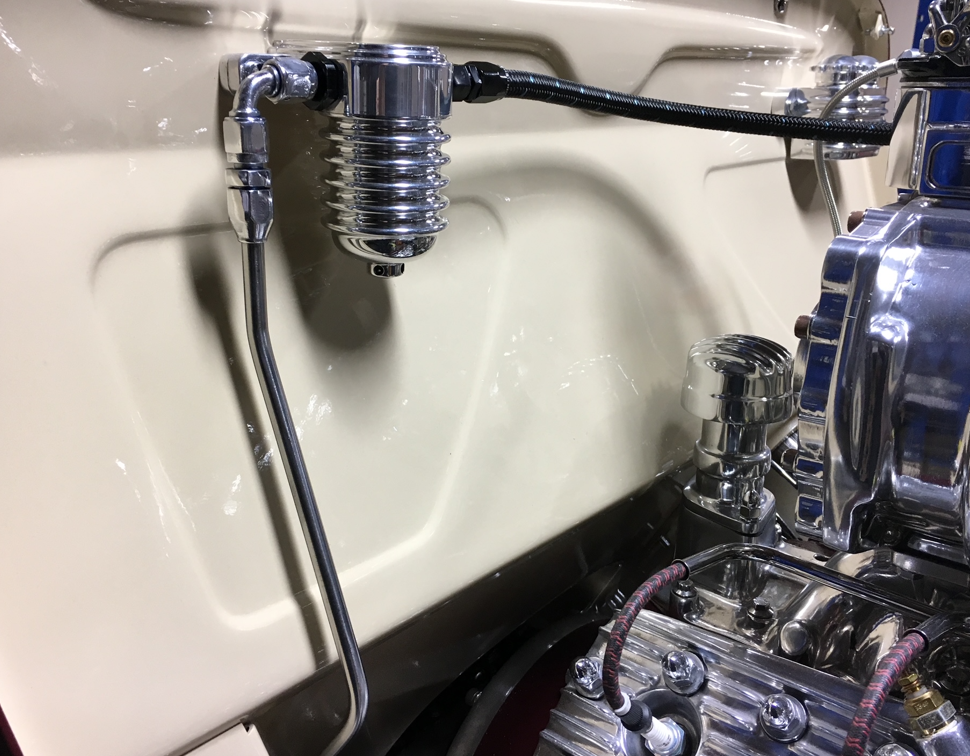

    I use an inline filter on the frame rail before the regulator to protect it...
    Another filter on the firewall to protect the carbs.
    Pump is in tank on all my cars.
    Just Gary and bchctybob like this.
  8. H.M. Murdock
    Joined: Oct 8, 2015
    Posts: 1
    H.M. Murdock
    What fuel filter is that you have on the firewall? Pretty cool.
    Bandit Billy likes this.
  9. Bandit Billy
    Joined: Sep 16, 2014
    Posts: 15,272
    Bandit Billy
    That came from OTB gear. They have some cool stuff on their site.
