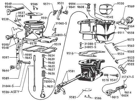

  9. Going through 97 is relatively easy if you have the correct tools. Like was stated earlier get a jet wrench, but don't for get an emission tube puller. I fought with the 97's on my T for quite a while to get them to idle right. I had tanked the carbs several times to try to get them clean and they looked great inside but you can not clean the crap out that is stuck around them in the carb body without removing them.
    They are #9534 in the illustration.

    On the tubes, you just thread a small tap into the bottom of the tube and pull or if really stuck add a threaded rod and a nut and washer to make a simple puller. From memory, possibly defective, a number 4 tap is loose but usually works, a number 6 is real tight but works, and I've never hunted down a number five. Make sure little holes in tubes are round--overtightening jets crushes them. Carefully clean associated air bleeds.
