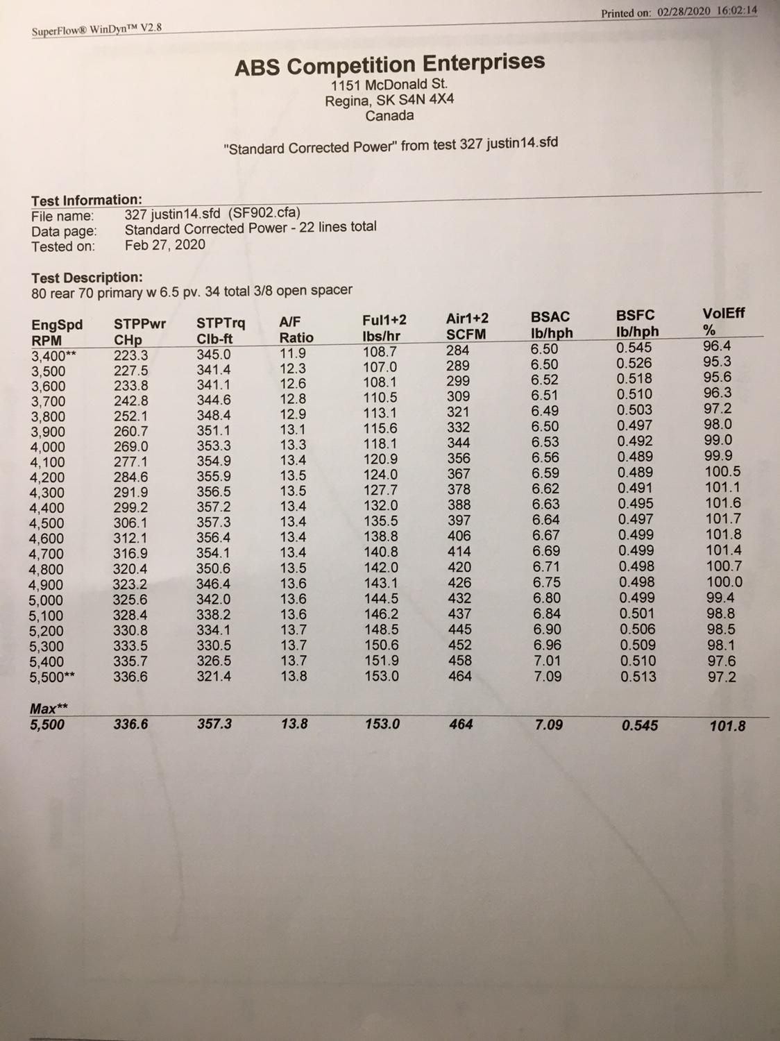

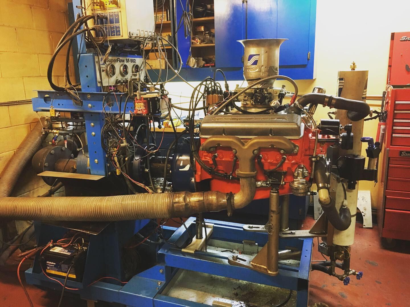

    So it was dyno day today! Picked up my 327 and got to watch it run on the dyno after being tuned.
    Pretty happy with the results, just over one hp per cubic with it bored .040.
    With the new gears it should be a handful.
