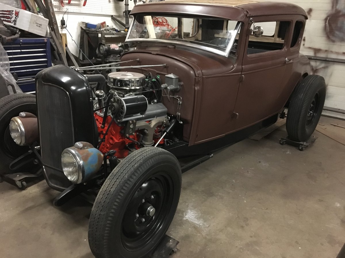

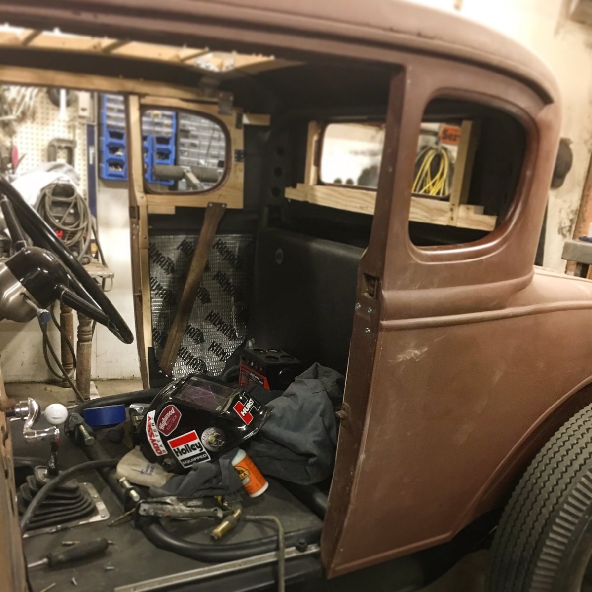

    I finished the body wood kit and chopped all the mouldings.
    95C46484-16AA-4055-BD03-1099E1CD1D8E.jpeg BB0FAEFC-A5A9-4E6C-BC07-40EB4ECB8CB2.jpeg
    I also finished up installing door latches and some body work.
    I gave it a second coat but didn’t like the results, so I wet sanded it and tried to polish out the scratches. Then I rubbed it down with some comet cleaner to try and dull it again. Kind of ended up with a cool look.
    I really only have a few small items to tend to and send the window templates down. I think I’m going to have a break from the car for a couple of months and finish it up in the spring.

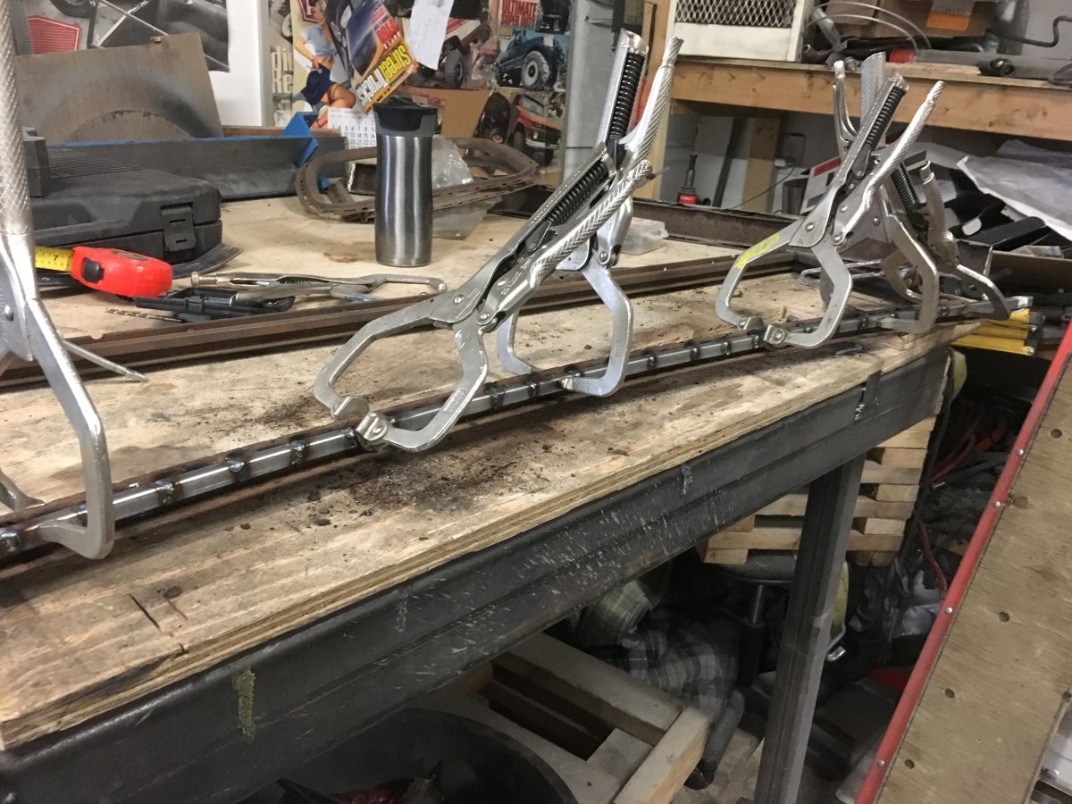

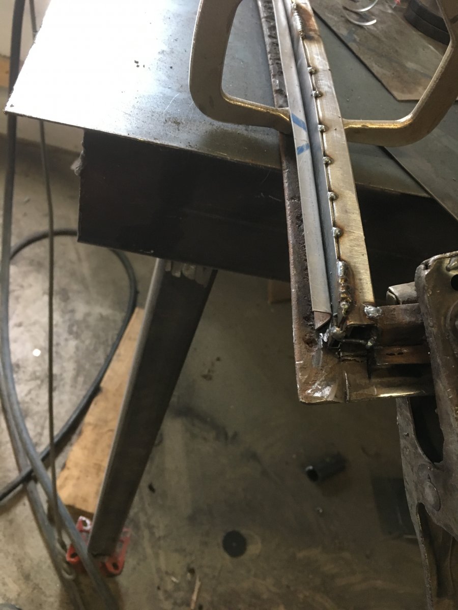

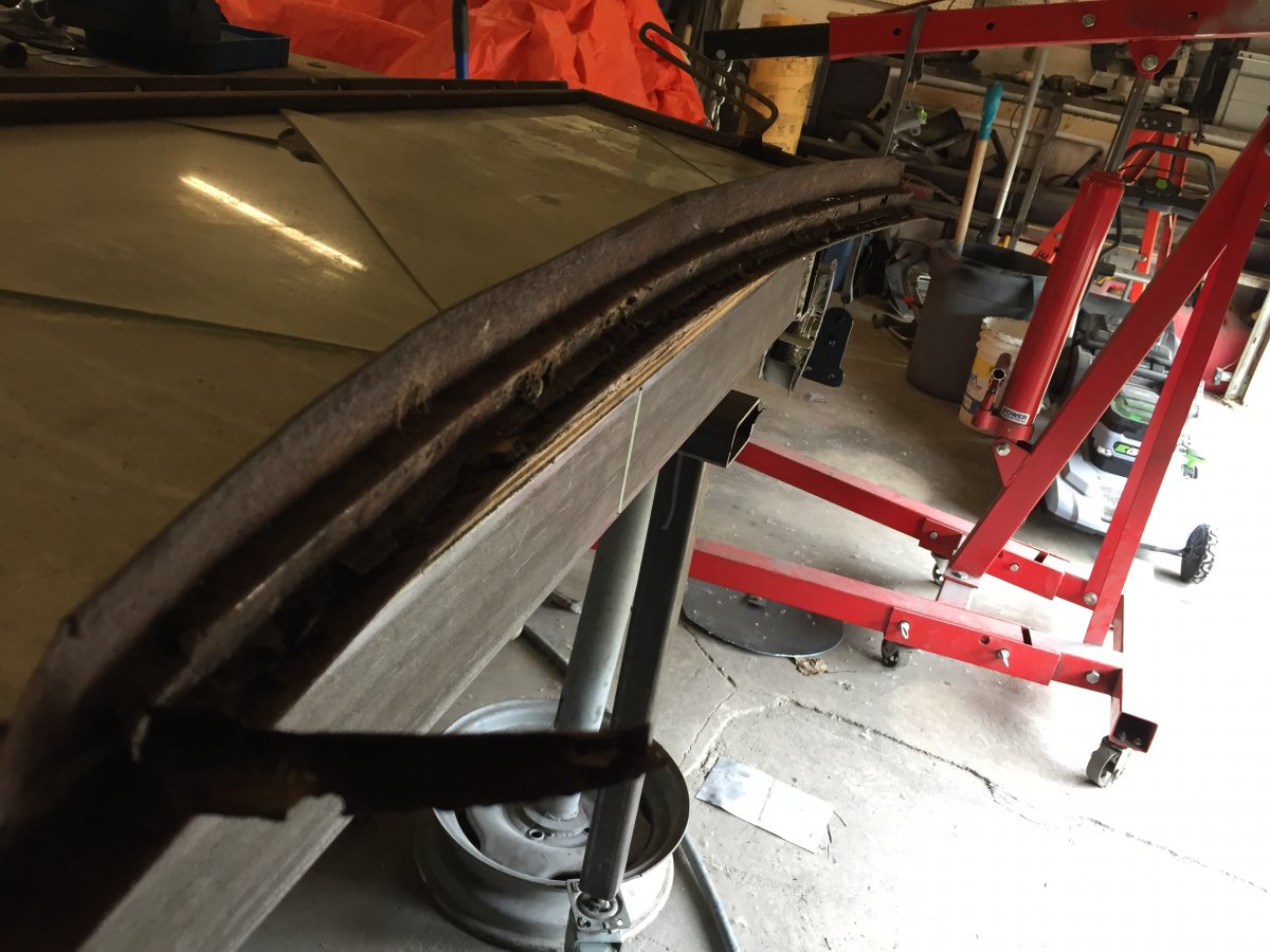

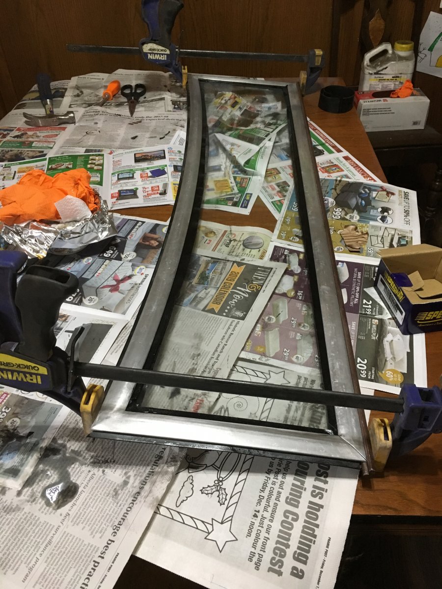

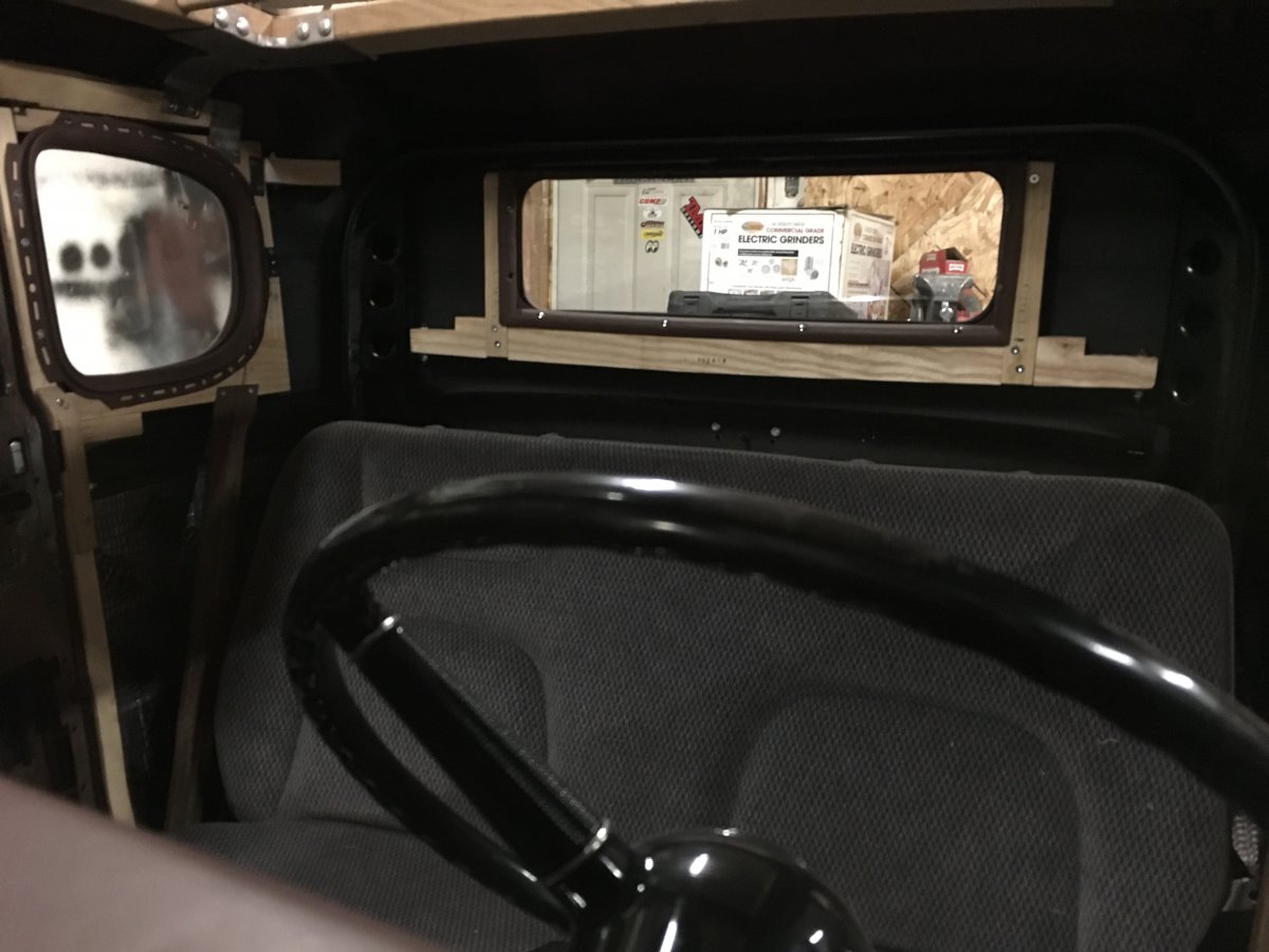

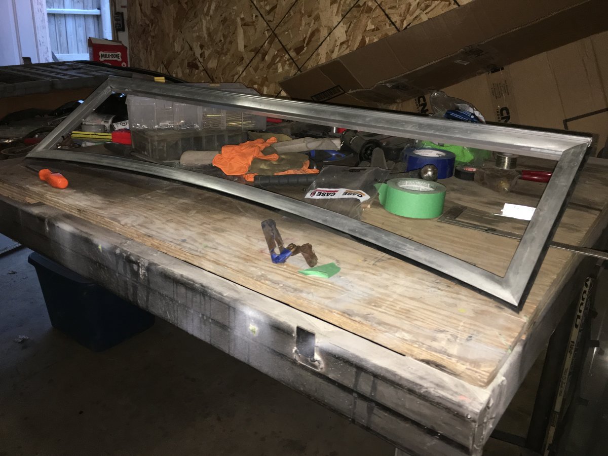

    Minor update,

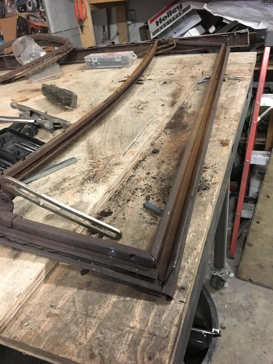

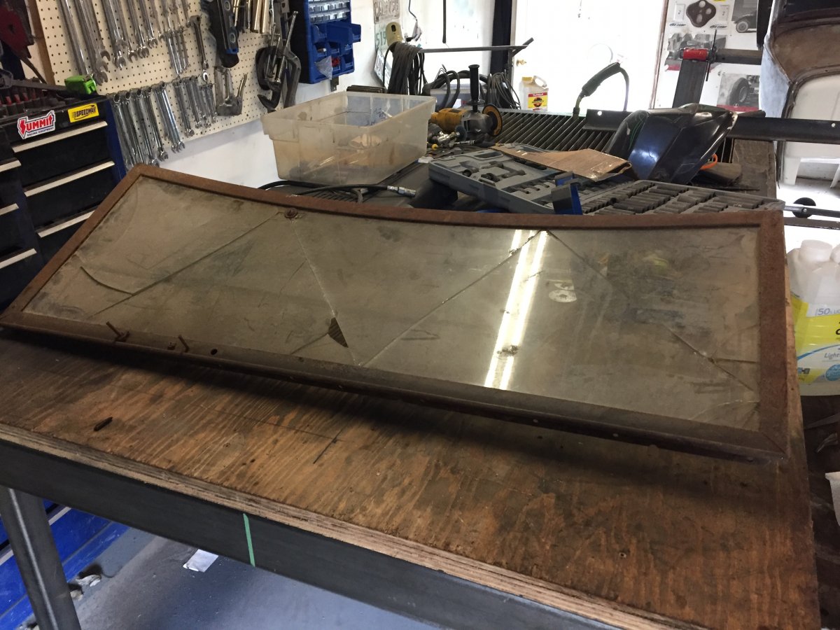

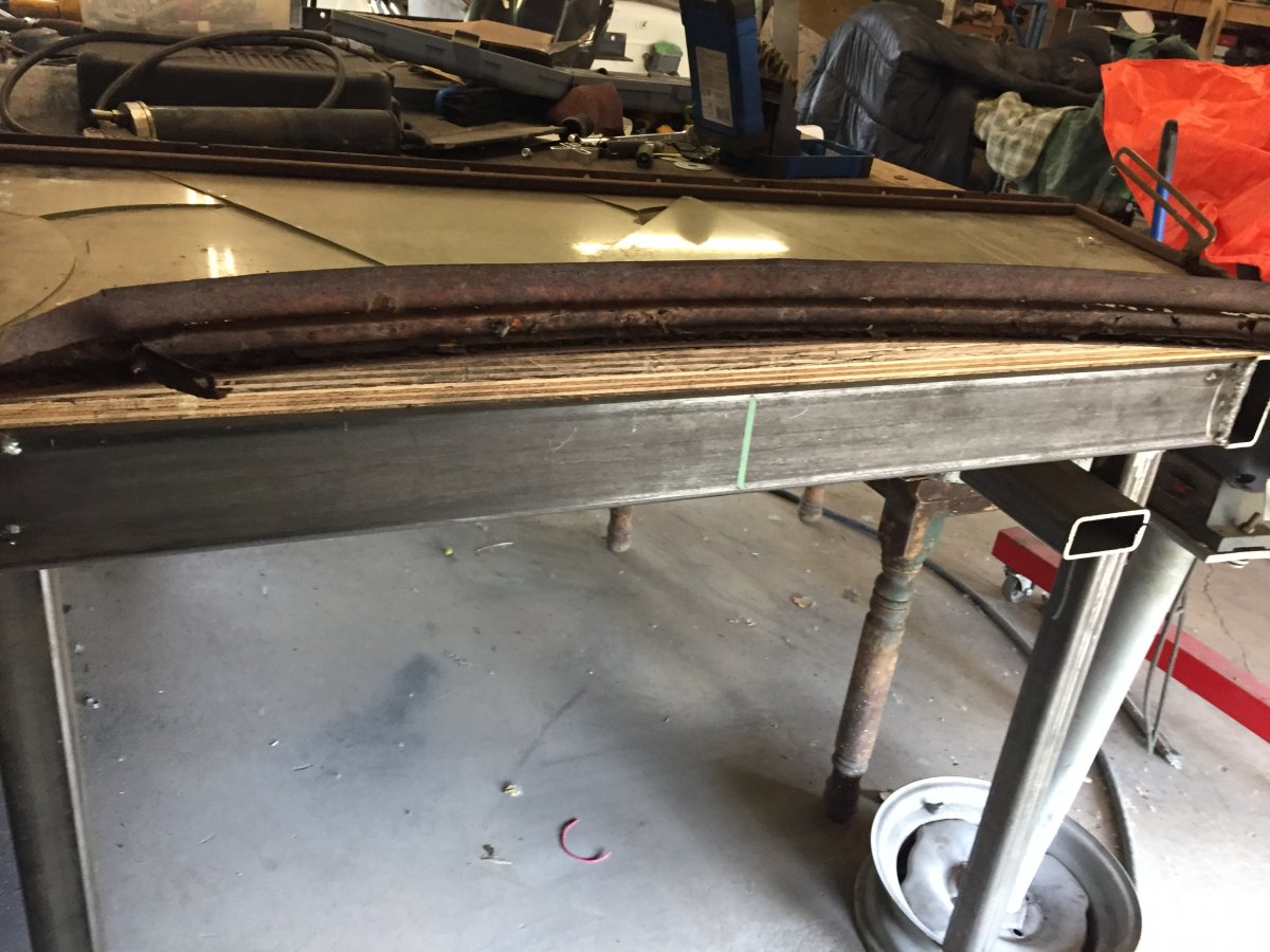

    I had this old windshield frame, it wasn’t bad other than the bottom was rotted out.
    I made a new bottom channel, chopped it and cleaned it all up nicely.
    Made a template and just couldn’t get glass in there without cracking. So out of frustration I bought a new frame.
    Once chopped and fitted I made a template had my glass cut and it fits like a glove. I really wanted to save the old frame, but it’s just tweaked enough.
    I’m not sure if I should polish the aluminum or paint it. I’m leaning more towards trying to trying to polish it, though it might stick out as there isn’t much bling on this plain brown car.
    On a side note, all the rest of the glass is getting tempered and should be here next week. After the glass is in there isn’t much on the to do list.

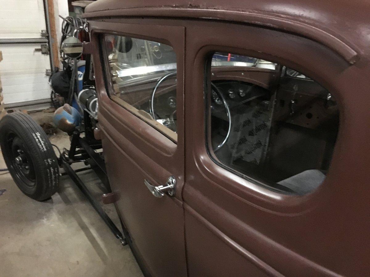

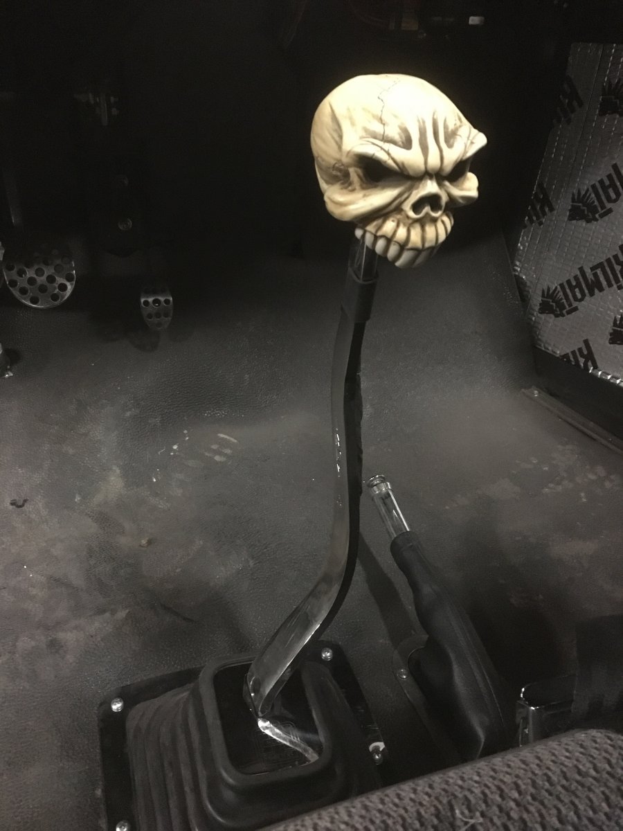

    00E22DB3-FE83-45F4-8839-7B8DD5574118.jpeg 3D67A0CB-EE7A-4E2A-B0F6-437573642DBF.jpeg 44C1BCB3-DB30-4BD7-8F45-0B464EB360D8.jpeg Got my tempered glass back and installed. A bit of monkeying around for the rollup windows but they go up and down marginally well.
    The shifter position was bothering me so I found a old hurst Indy shifter on my shelf and modified it to fit. Apparently it’s quite a bit different than the comp plus so it took some welding and grinding to combine both. Heated it and bent it to get it better centred in the cab.
    Feels great now.
    Surprising I just used a propane torch and didn’t wreck the chrome heating it up, worked great.
    I had this shift knob for awhile. My buddy who got me into hot rods bought it for a hot rod I tried building that didn’t come to fruition like 10 years ago. Thought I’d try running it. I liked the all business hurst ball, but a few skulls here and there never hurt anyone.
    Sometimes I try to hard to separate myself from the rat rod crowd that I try not to keep the car low key without accessories, but I’ll let this slide.
