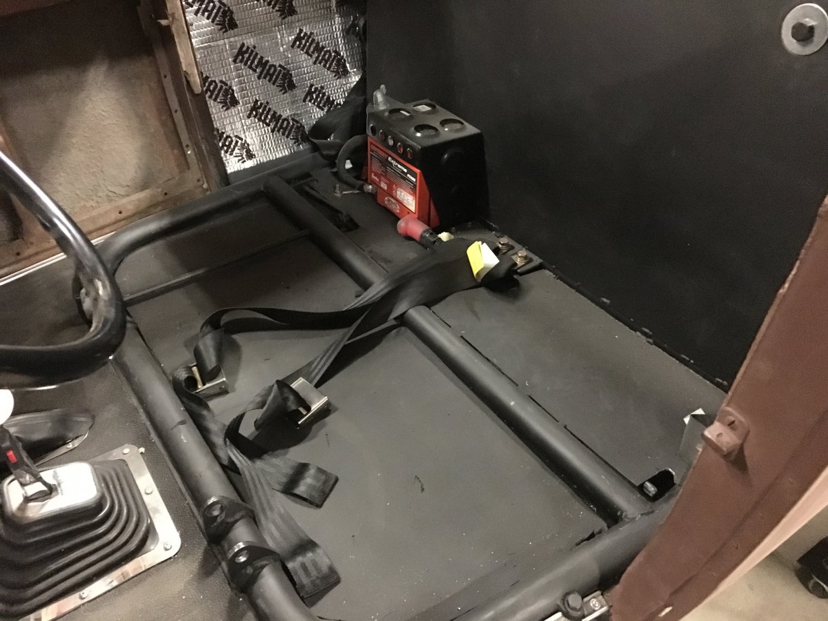

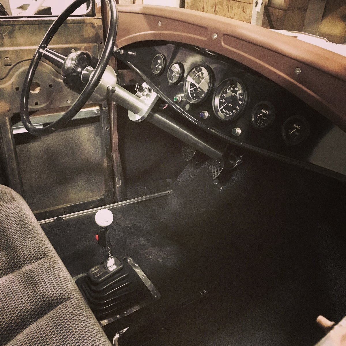

    The interior is super simple.
    Once again cheap amazon rubber flooring, lokar e brake, and I used this old stainless trim I had laying around from my old 75 K5 blazer. It has a cool filigree design in it that I always adored.

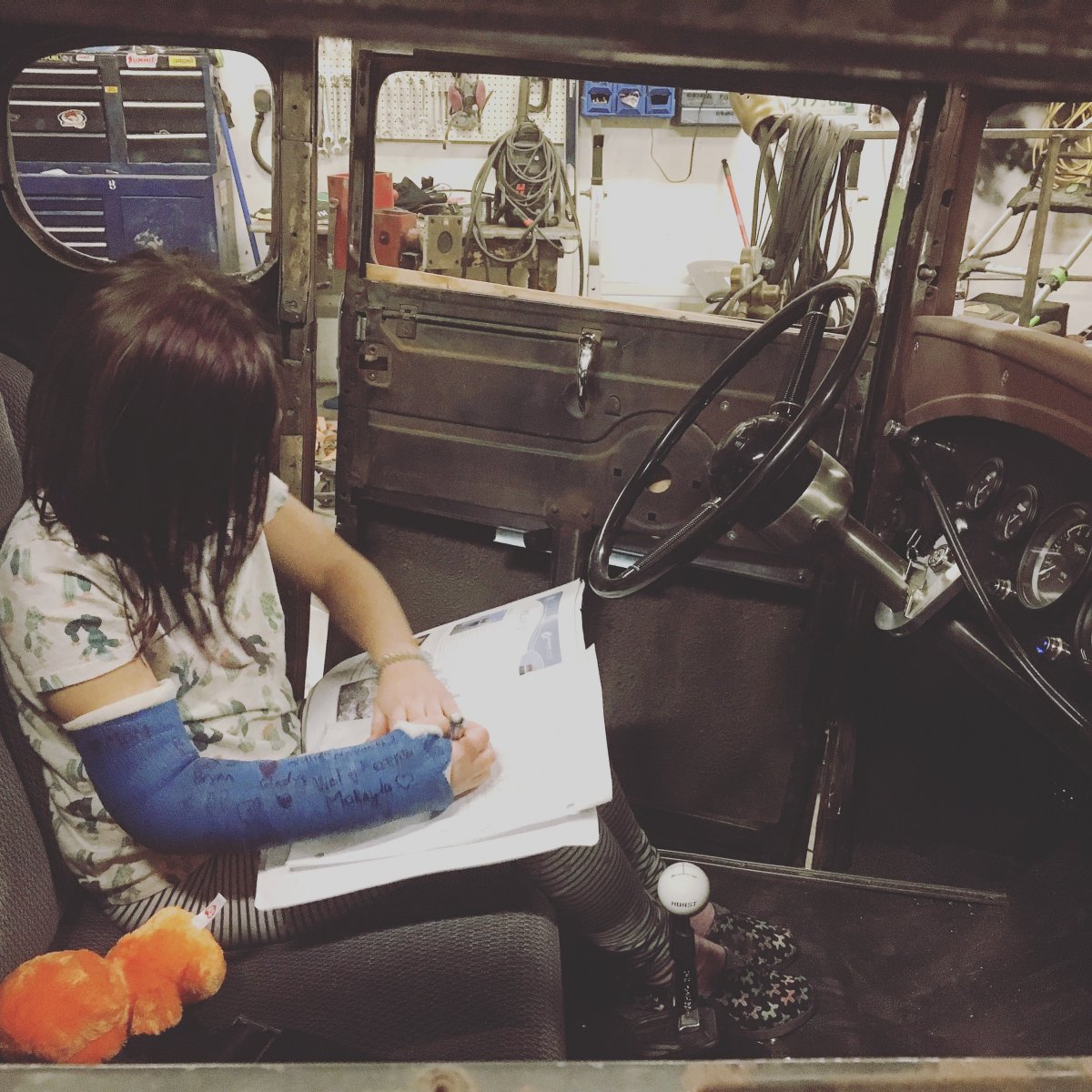

    The daughter joins me every now and then in the garage at nights to do her home work while I'm working.
    Yes, more cheap stuff from amazon. I know but honestly being in Canada shipping and US market stuff just kills me. With their free shipping it just makes it too easy.

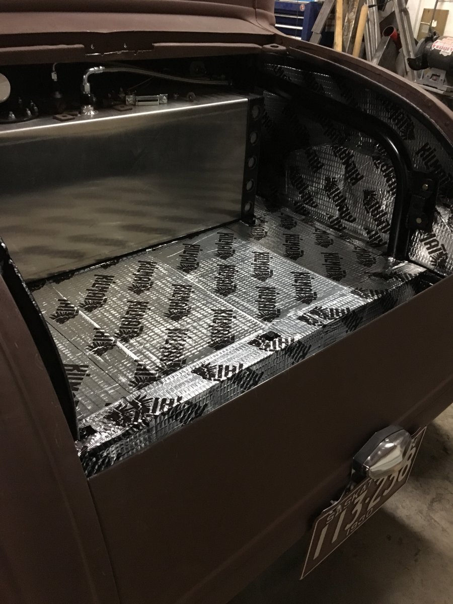

    This is some knock off, wannabe dynamat sound deadener. It was super easy to work with and nonscientific tests that I've done show that it makes a huge difference.

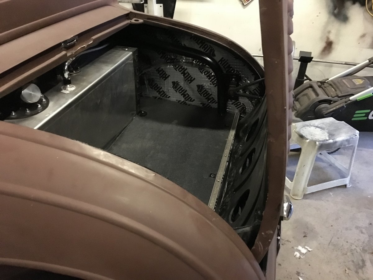

    Added the left over mat and trim to the trunk as well. It isn't perfect but I'm not concerned.
    Edit, I never talked about the fuel cell. Its a RCI unit, 15 gallons, and I custom made dimple die brackets to hold it in.
    Also, a close up of the filigree trim. I like this kind of stuff
    Heres another picture of the fuel cell. I modified the neck to fit tuck in the way I have it.

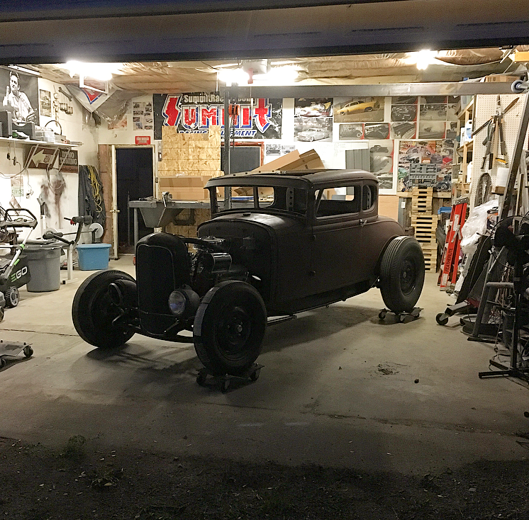

    Another picture I've dug up of the wiring and supports I made.
    Also I made stainless lines up to complete the brake and clutch system. Bled them and somehow had no leaks. I lightly polished the lines, I used summit racing stainless annealed lines. I double flared them with my summit/k tools/eastwood brake flaring tool. It went like butter. I would highly recommend one.

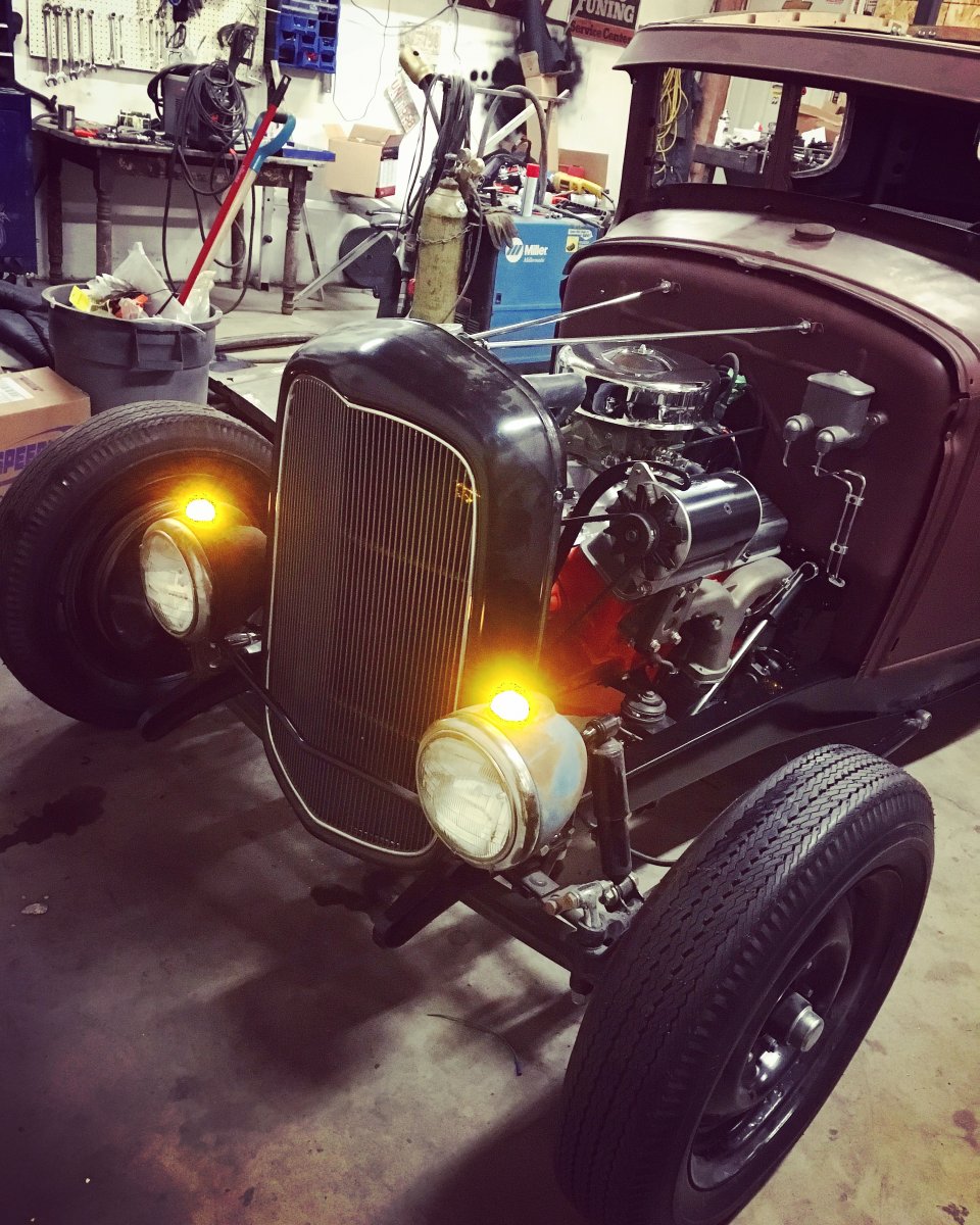

    This is the new signals, the old glass was a bit broken so I needed something new. Found these "replacement" leds. They worked ok but required modifying to fit.
    Also made up rad support rods, just hardware store 3/8" zinc plated rods that I threaded and polished.
    The grill insert was painted a cast iron gray to tone down the bling factor.
    I mounted the steering column permanently here as well. Made up a snout to keep the plug wires from getting caught in the u joint.

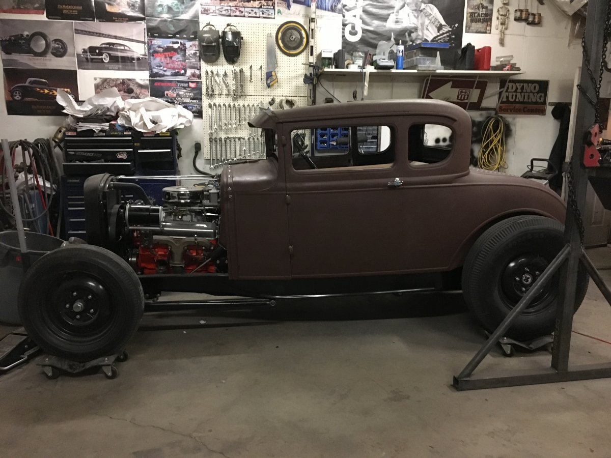

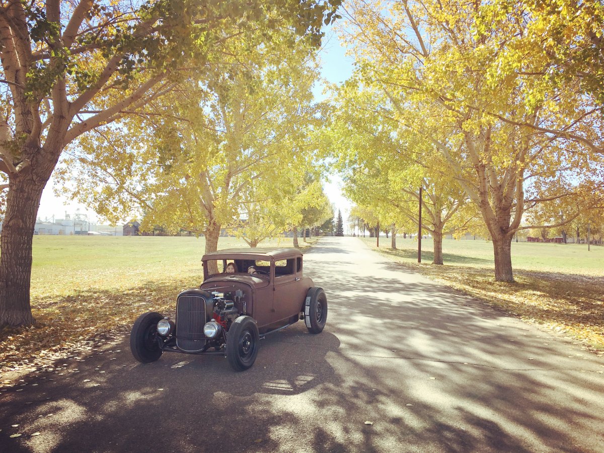

    So this is pretty much the end result.
    This is the body on the frame after painting

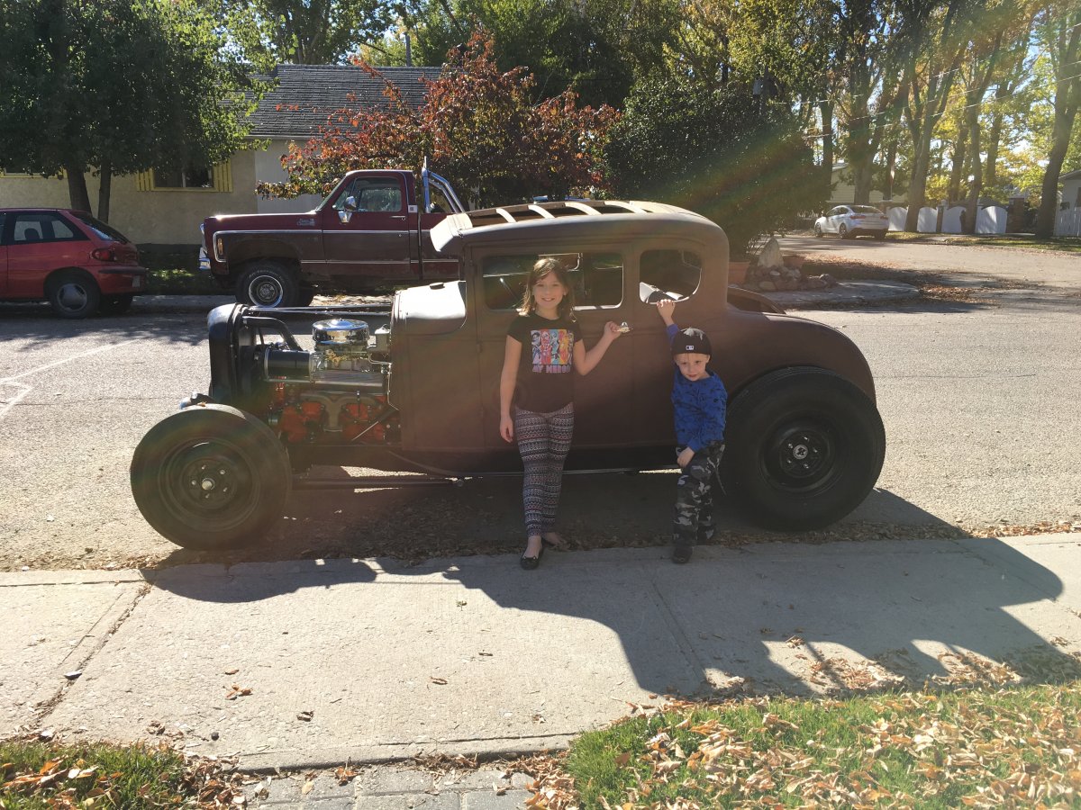

    First day out of the garage under its own power. The kids came with me for my first drive.
    Stopped for a photo op..
    Walking in the garage and catching a glimpse almost gives me goose bumps..

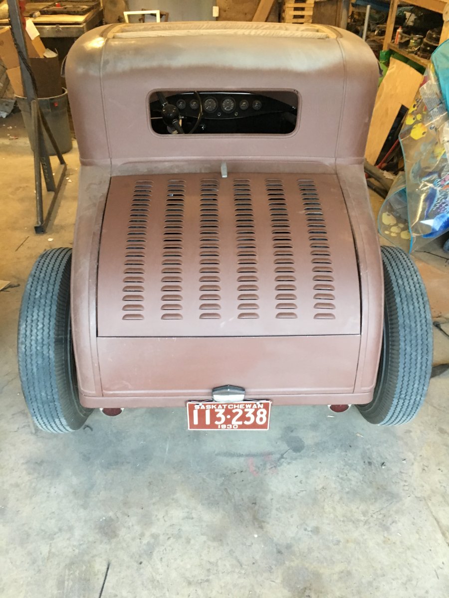

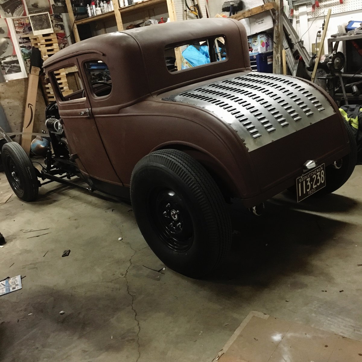

    The last thing I’ve done on it is fill the hole for the trunk. Original rumble seat car and the deck lid that came with it was rough.
    It also turned out to be a 28/29.
    I really wanted a replacement brookville but it’s just out of the budget for now.
    I didn’t have anything to make a new skin so I patched the original inner structure and had a guy punch louvers on a flat sheet for me.
    I just bent it over and welded it on. It’s not perfect but will work for awhile until I get a better setup.

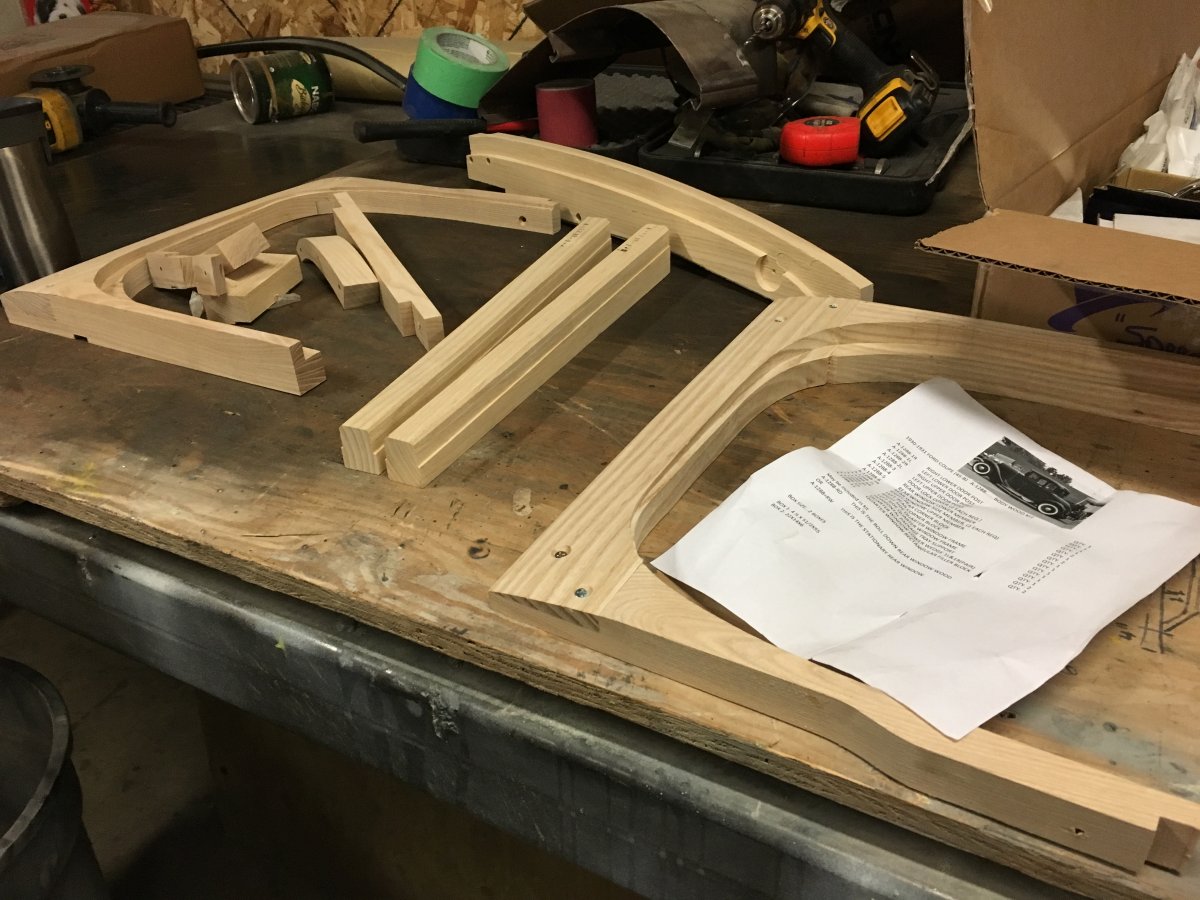

    Body wood day today.

    Picture of the battery mount. I wanted to put the fuse box beside it but was easier and cleaner under the dash.
    I used a oydessy pc925 and just moroso bulkheads through the floor.
