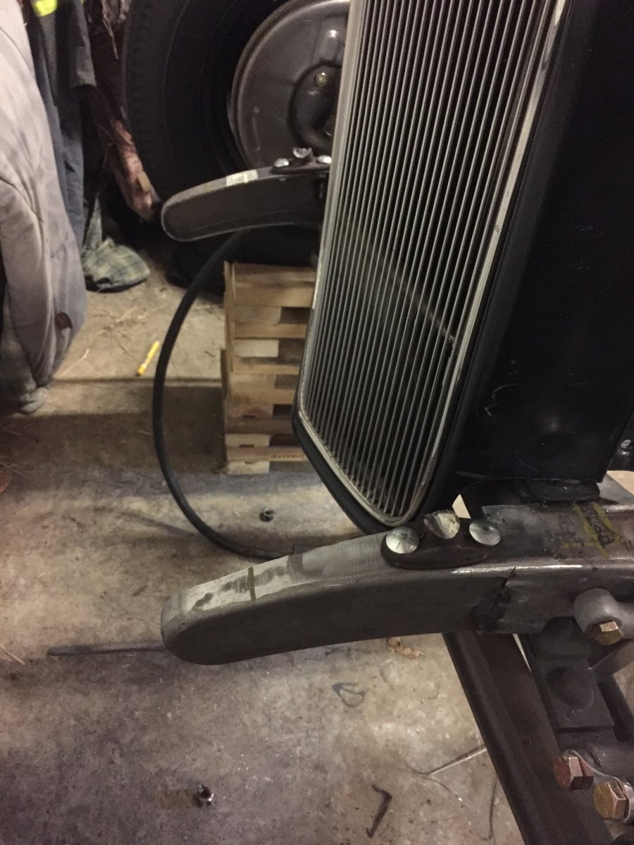

    Pretty much the only thing I accomplished for the rest of 2017 is in the following pictures.
    I cut up an old original headlight bar that I had lying around.
    Old mounts ground down with a spot to accept the bar.
    Also keen observers would have noticed on the original frame build I had the factory 32 frame horns, later in the pictures I had them cut off.
    I don't see many 32s in real life so to me the frame horns looked really crappy as I'm not used to them. I preferred the look of the model A horn. So I installed the at this time and blended them to match the 32 frame.
    Originally I was just going to bend the headlight bar but didn't like the look, so I cut it in half and V'd it the opposite way to match the grille. Not sure how most do this but it looks pretty clean.
    Bought some old guide lights, they look cool but are a little rough.
    I also played around with the grill height to get it just right.
    The shock towers got mounted at the same time. I made a piece of flat stock with two holes and nuts welded to the that I could slip inside the frame to attach the bolts since I was already boxed and didn't want the hassle of trying to weld in threaded inserts.

    Awesome build. Love the frame horn swap. Most A's you see with the 32 rails have the horrid horns sticking way out front and look rather ugly. Nice work.
    winduptoy and Fry like this.

    Thanks, I agree. They didn't look right, especially with my pinch they looked like they were bending out the wrong way.
    It's funny, I'm not really a huge details guy but I hate stuff that's distracting from 10'. A car has the look or it doesn't, it needs to flow as a total package.
    I wasn't concerned on this build about period correct hose clamps or anything. I wanted the look, and a functional hot rod that wasn't too nice. Something you can drive hard, not worry about scratching or polishing, just a good old fashioned hot rod.
