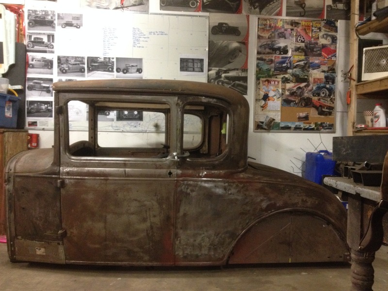

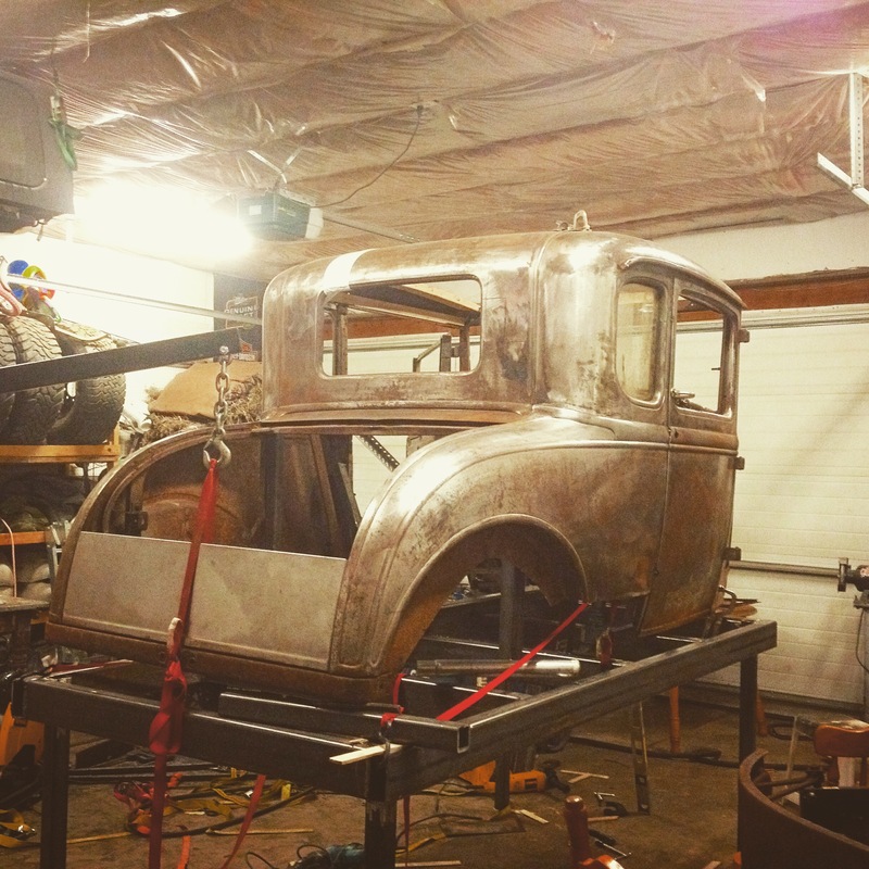

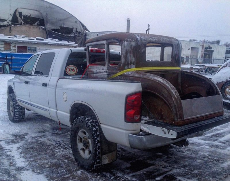

    So lets start with this, Dec 2015
    I picked of this body 5 hrs away as a project from a hot rod shop owner.
    The body is decent, it had no subrails was just a shell with a half installed top wood kit.
    When I got it home I built a frame table and straighten the body and re-braced it so the doors where as good as I could get. It took a good bit of pulling and twisting, its not perfect but I'm ok with that on an 85 year old.
    Sitting and waiting for the frame rails to show up.

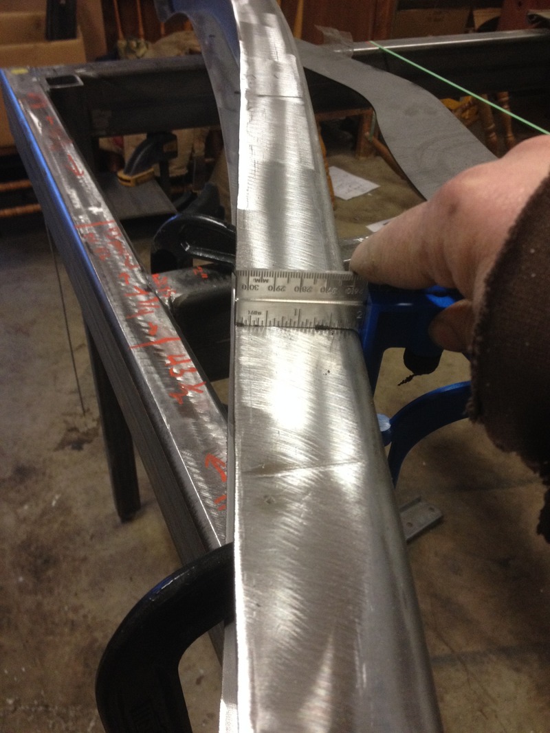

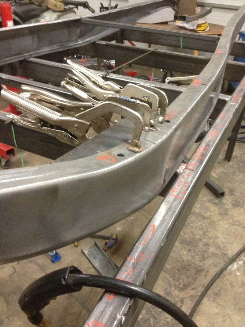

    I ordered ASC rails which took forever to get here.
    They needed a good amount of massaging to make them look good, and I also cut them down to a consistent 2" top and bottom.

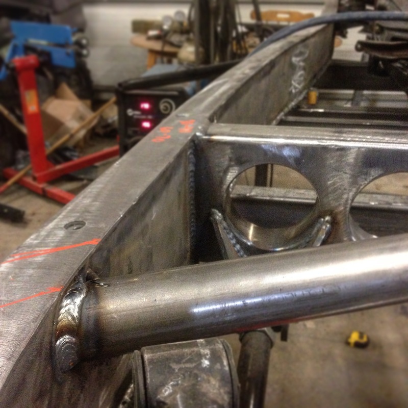

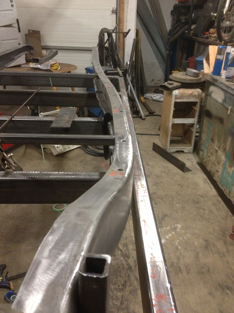

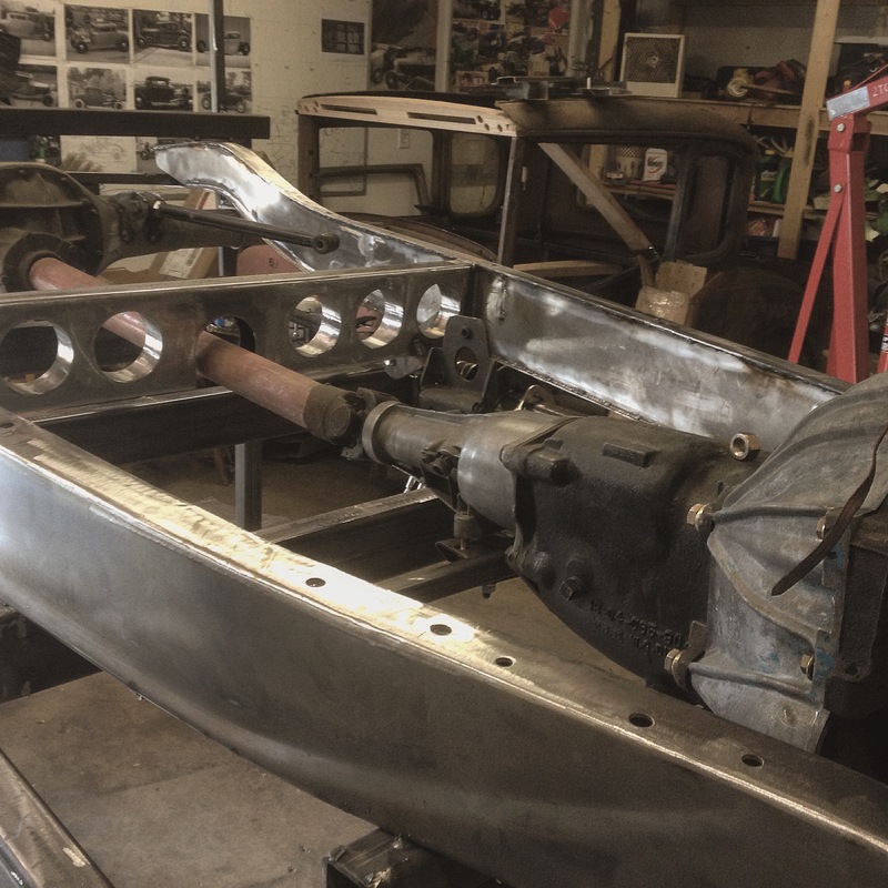

    I pinched the rails front and rear

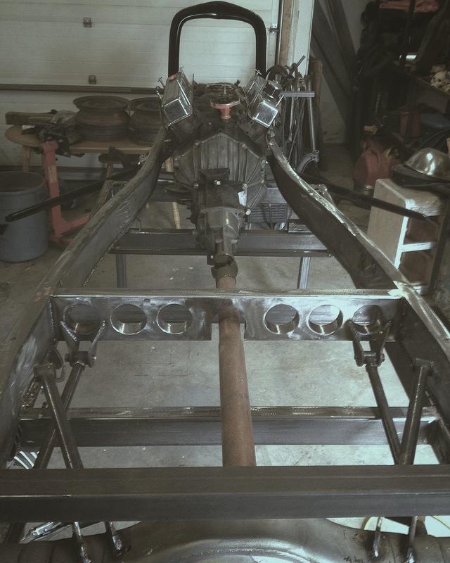

    I boxed the rails, I set the boxing plates in a little so it didn't look so modern.
    I also made up a center crossmember and added some exhaust holes through it.
    I didn't want anything hanging below the chassis so I wanted the exhaust tucked up close.

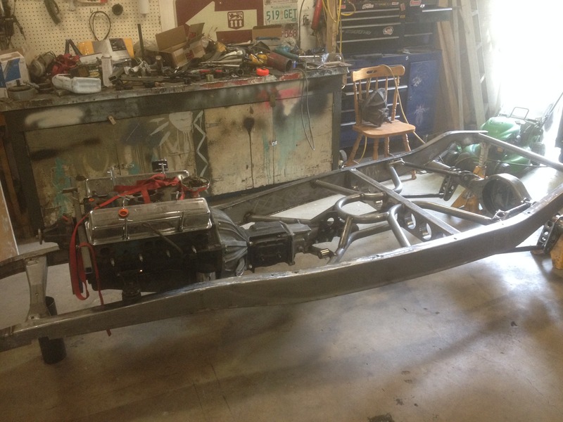

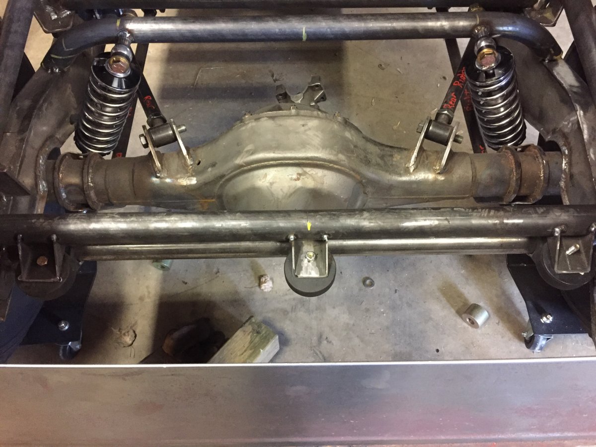

    I also picked up a narrowed 9" and used old left over 4 link bars to locate it.
    I hand cut the mounts with and angle grinder, and bent them to a V with a torch.
    Lots of parts picked up in this step, I have the 16x4&5 wheels, borg warner ST10, front axle, wishbones, etc.

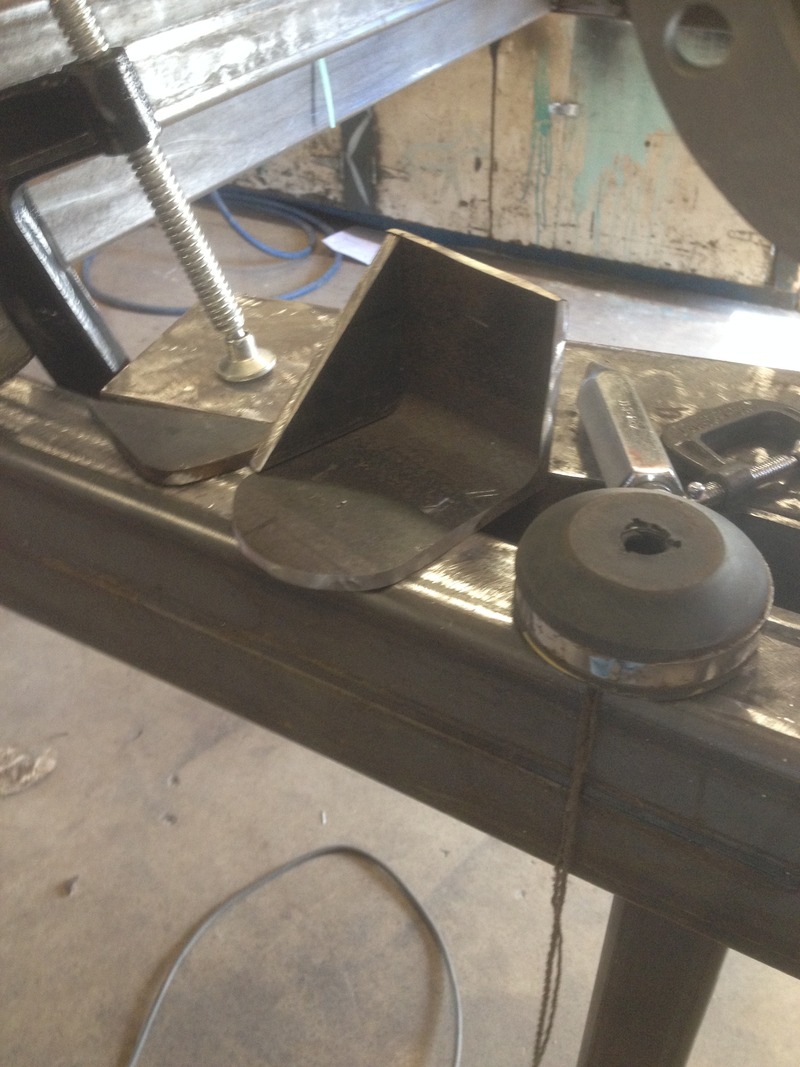

  5. Fry
    Joined: Nov 14, 2002
    Posts: 988
    Fry
    from SK, Canada

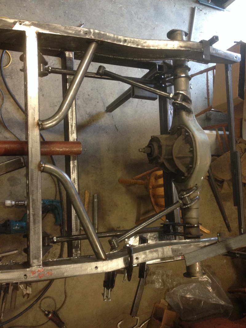

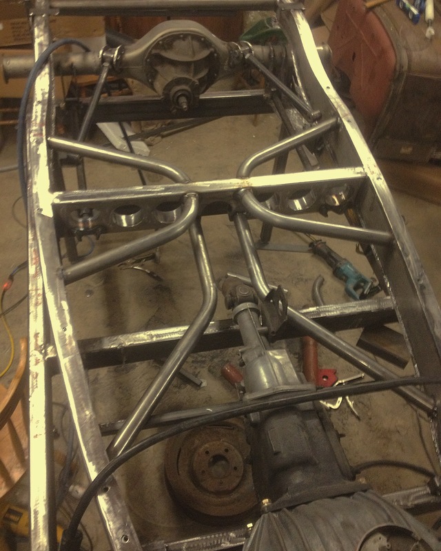

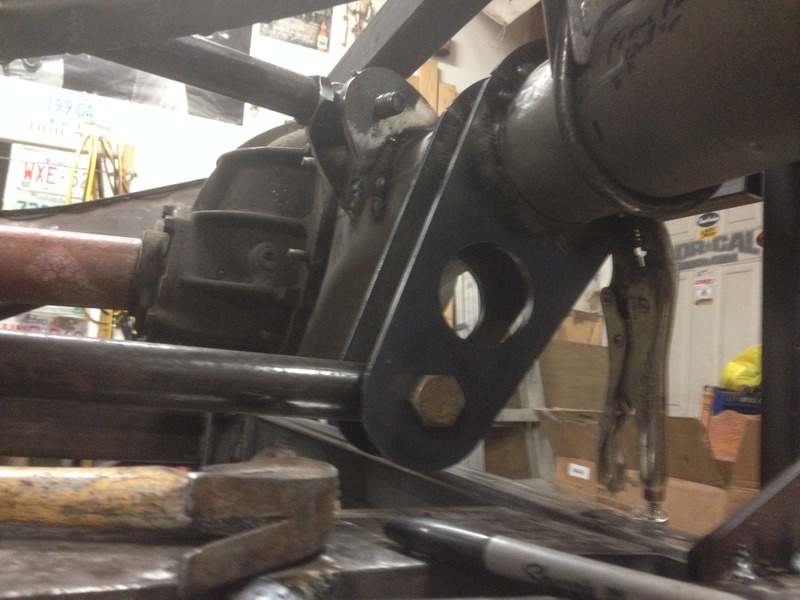

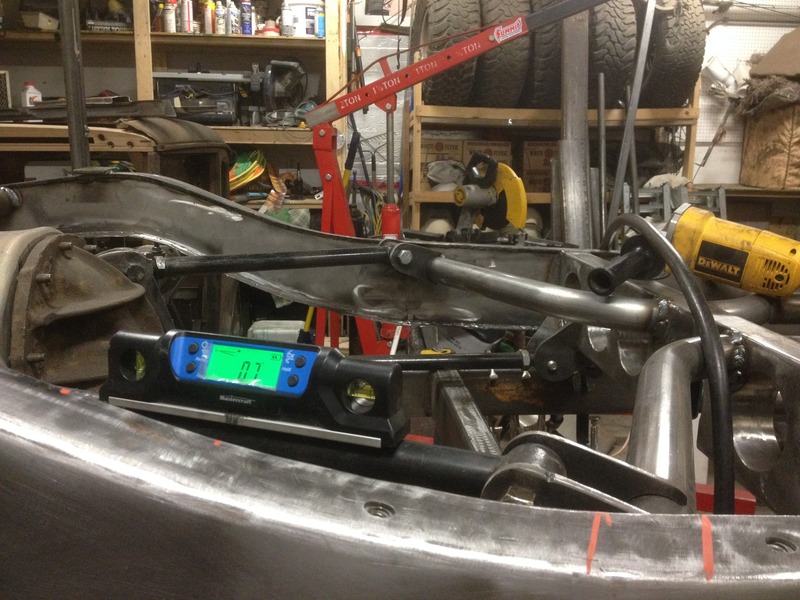

    I wasn't sure how to attach the upper bars, so I bought a tubing bender and made this K-member type setup out of 1.75 DOM tubing.
    A lot of research into 4 link and vehicle dynamics went into my 4 link. I found that the bars are supposed to have mount points closer to the same axis as the pinion. I did a lot of drafting and calculating to come up with what you see here. I think its pretty ok.
    I ditched the magentic dial type angle finder for a digital, way better idea.
    I had these laser cut locally, which was stupid expensive but the hang a little low for proper geometry so I wanted them nice.

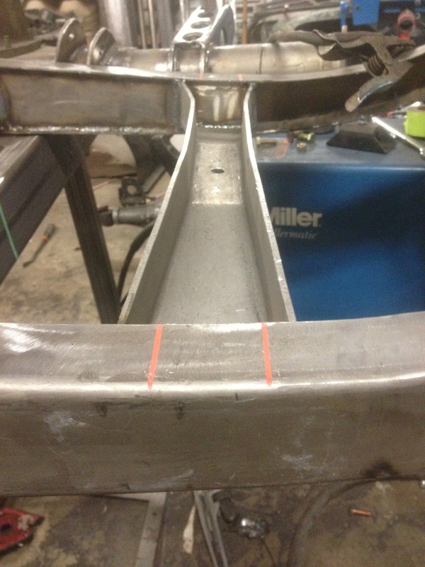

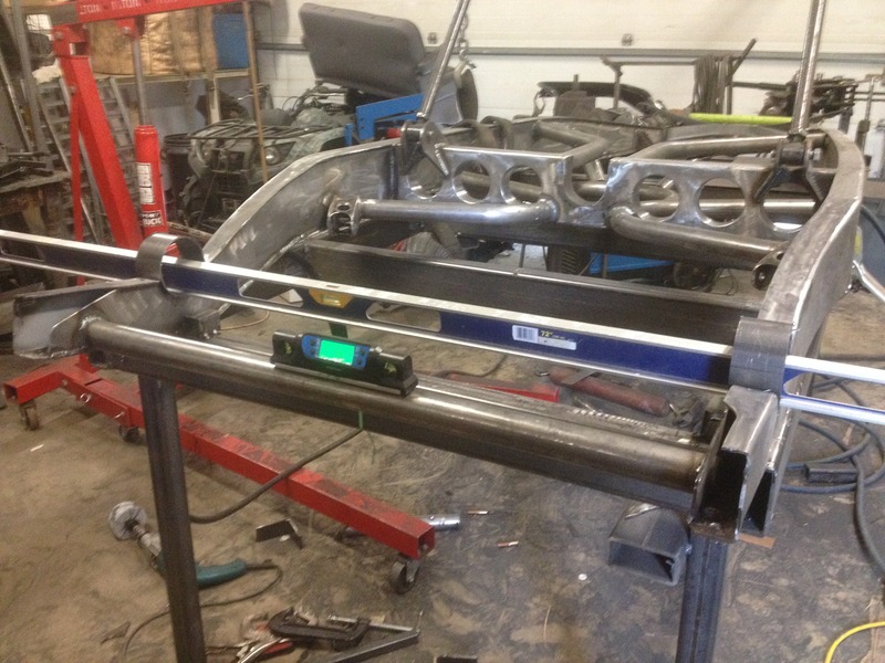

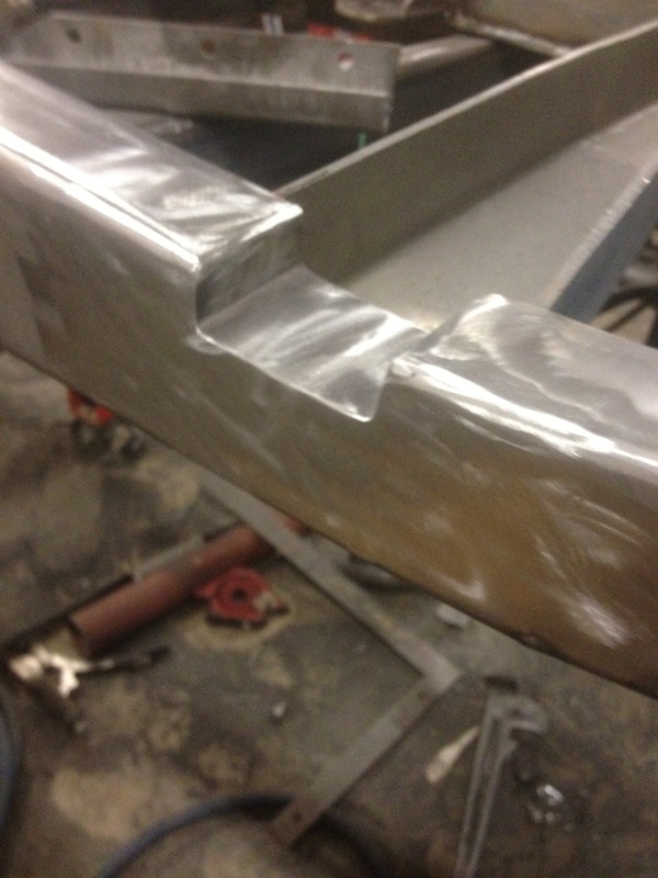

    This was my method to make sure I was getting proper the notches in the proper spot.

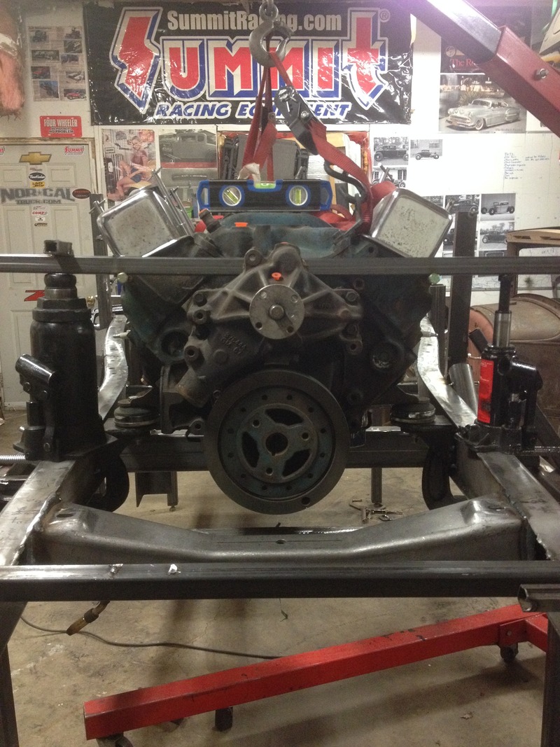

    simple, effective engine mounts..
    I bent some tubing, cut a notch into it and made a mount for the trans. Like i mentioned earlier I wanted nothing hanging below the frame and the stock mounts were just to low and ugly.
    Clearance, I added rod ends for cushion/flex.

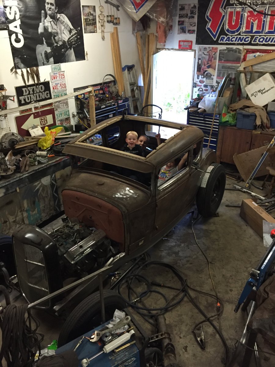

    Kids thought the crossmembers looked like a skull and cross bones so I made it a skull and cross bones. A little rad rodish, but whatever... rolling bones can get away with skulls why can’t I. Haha.
    f19.jpg f22.jpg This is a little out of order but I had the body on and off a hundred times, which is a lot of work by yourself.

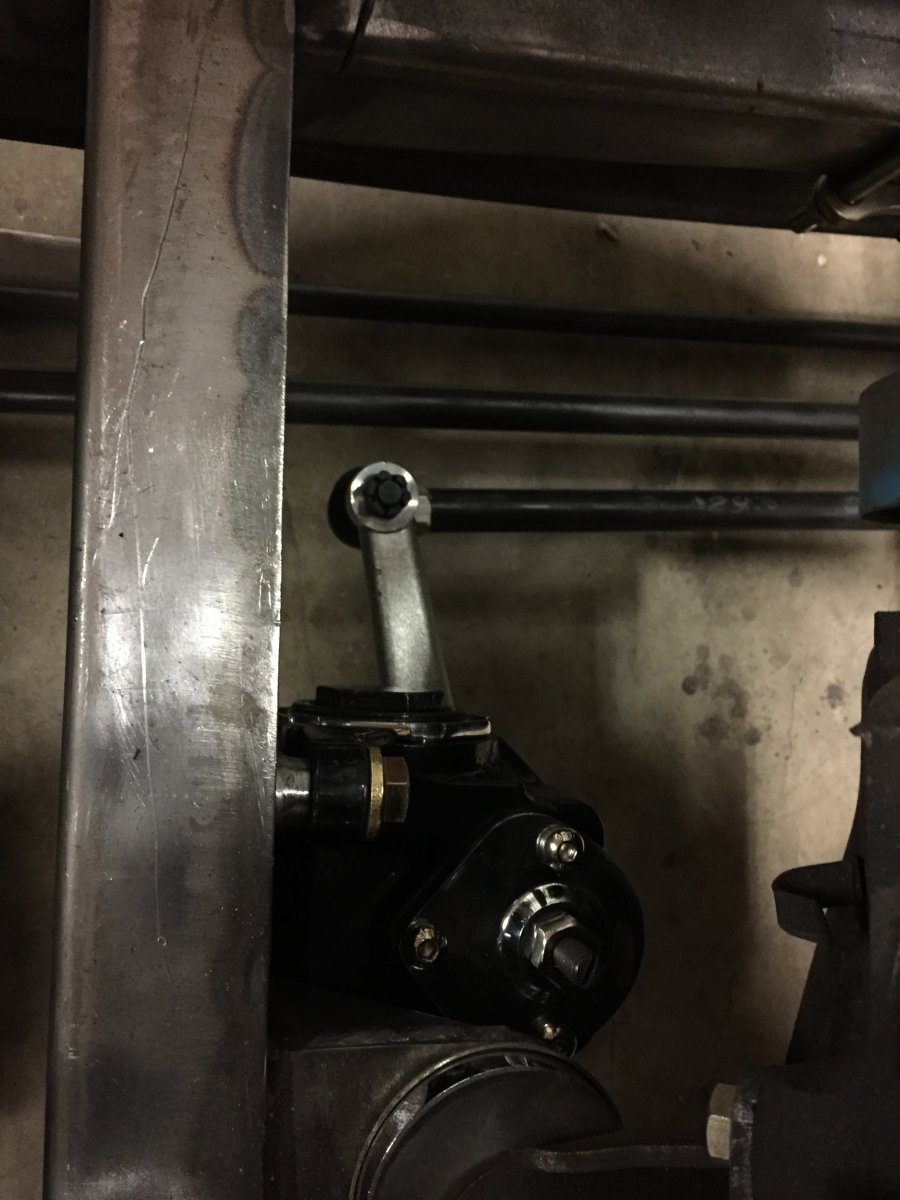

    Got the vega box mounted and gusseted I'll see if I can dig any more pictures of that stuff up.
    fr28.JPG The f1 shock mounts modified. Thats about all I have sorted for today. I'll see what I can dig up and post some more progress tomorrow hopefully.

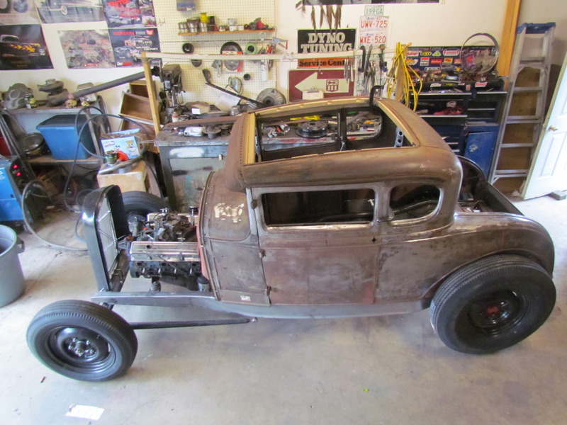

    Speaking of TV, I kinda ended this episode with a poor ending..
    So this would be the cliff hanger..
    Off the table, body test fit again, grill shell chucked up and front end together.
    Really getting the look of things to come.
    This would be spring 2016.

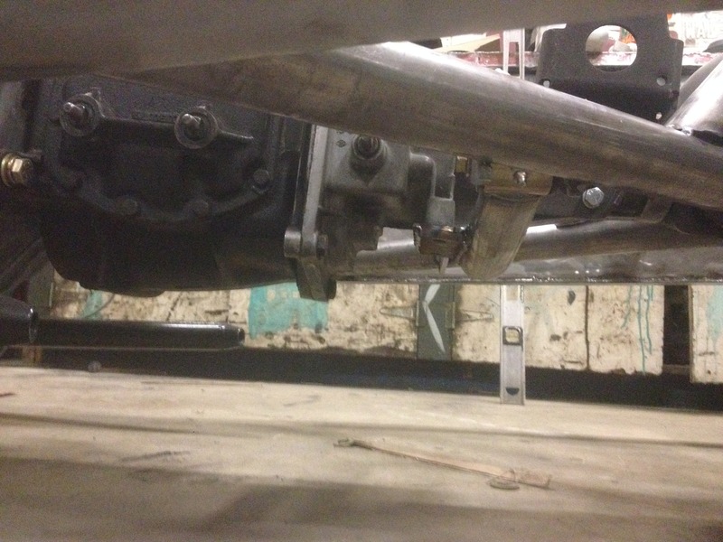

    raven

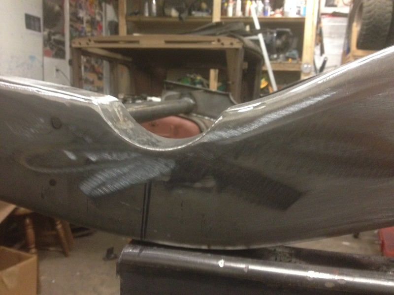

    Beautiful work shown so far. I do have one concern, the cross member where the driveshaft goes through does look like it would allow much rear suspension travel before the driveshaft hits it. Am I jumping ahead?
    r
  22. Fry
    Posts: 988
    Fry
    from SK, Canada
    The picture probably look like that but bottomed out on the c-notch it still has a lot of clearance. This was just a telescoping set of tubes to simulate a driveshaft and wasn’t sitting in the center of the pinion.

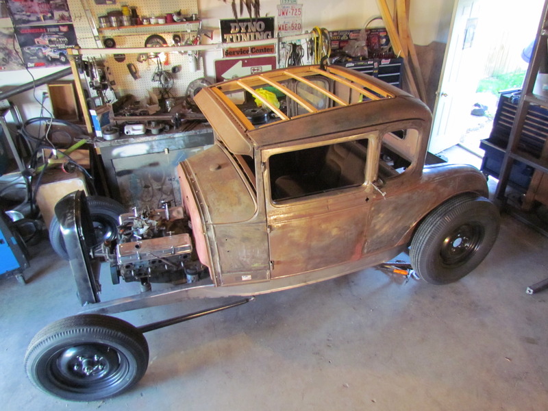

    Then I got my tires, 5.50 & 7.50s, early ford wheels.. I believe fronts are 4" and rears are 4.5 or 5".
    Set up at ride height, waiting for money to finish the front end.
    Glamour shot with the front end rolling, still no axles for the rear.. This is where you really start getting excited, seeing everything come together. It looked kinda cool unchopped, but didn't stay that way for long.

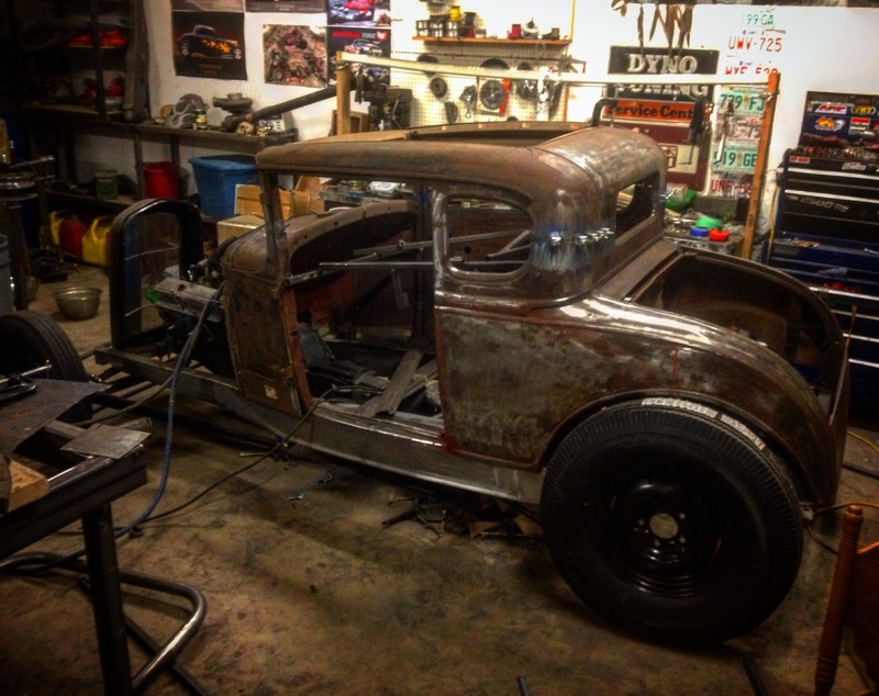

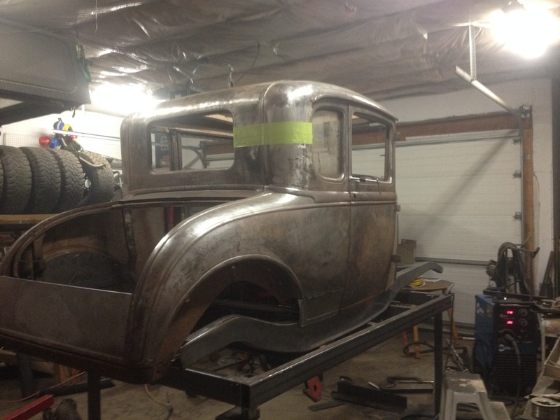

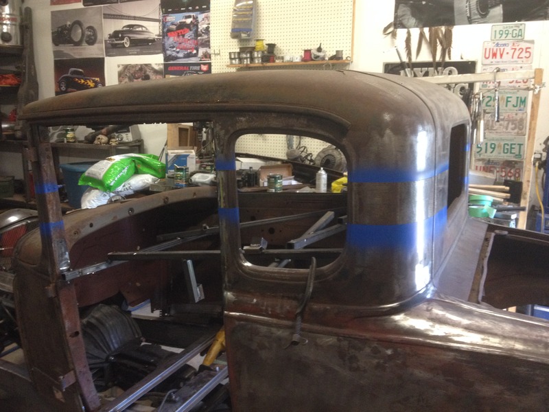

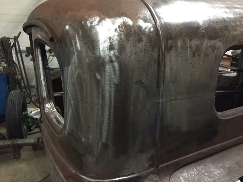

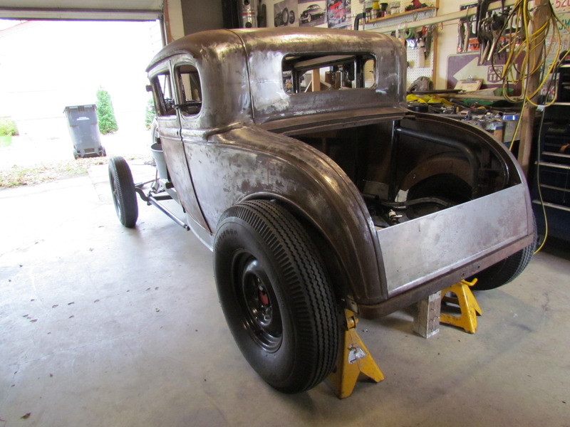

    I had initially planned on having someone else to the body work, including chopping.
    I'm not a body man, and really lack the knowledge and skill to pull this stuff off, but no point being a coward.
    So before I actually welded on the body I took the old cut out pieces and practiced on. Sometimes I find this old tin is hard to weld, but this stuff actually went pretty well.
    The wife and kids are very encouraging with the project.
    My son told me at this point "dad, if you hurry up we can drive it tonight".. haha, kids..
    Finished welding, didn't turn out too bad. I was pleasantly pleased that I did not wreck it during the process. I took my time, tacked, hammered, cooled and went to the other side and repeated. I didn't end up with any warping.

    I cleaned it all up, cleaned up the garage as those other photos sure make me look like a pig..
    bf1.jpg Still no axles and floor past the subrails. So not a roller yet. Thats the hardest part on building on a budget, learning patience.

    The chop was 4", well 3 & 11/16" or whatever masking tape works out to nowadays.
    You can kinda see in these pictures that I built a rear subfloor to follow the frame rail curve. I later decided this was stupid and changed it all up. I think thats probably whats next on the list as it was mostly labour while I was waiting to save up some cash for parts.
    Kan Kustom, 1927graham and brEad like this.

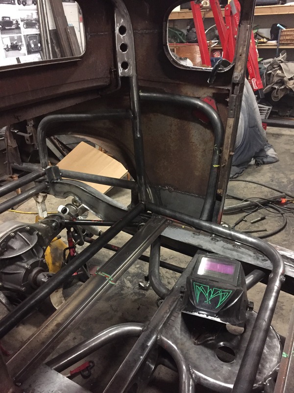

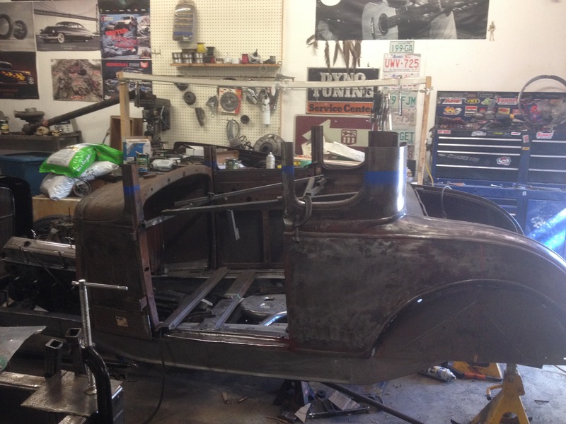

    Like I mentioned earlier, I had built a rear subrail assembly that curved around the frame. Then got to thinking about mounting a fuel tank or fuel cell and curved floors. Then I started thinking that I have no way to build nice rounded floors so I scrapped the whole idea.
    I wanted a roll bar, I thought the doing a dimple dies tie-in would look pretty gnarly. I wanted it to stay classy without going overboard on that kind of stuff like so many people do.
    So I bent a roll bar for the back of the cab. I notched the body seam and pressed it close against the tin.
    In hindsight I should have went a tad high as I'm not sure what I'm going to do for the rear window attachment (which I'm working on currently this winter).
    There are body mounts welded to the bottom of the roll bar. I'm taking the body on and off a hundred times after this so welding to frame wasn't an option. I didn't build this to any spec, to meet any racing sanctions or anything. The goal was to beef it up and add a little protection.
    I never did continue with the side bar along the door frame. I thought it would have been cool to tie in the door frame with some more dimple dies. But it was too many curves and a lot more work so I abandoned that part of it.

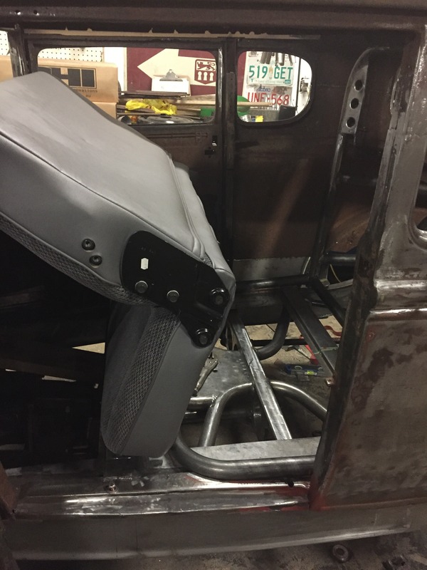

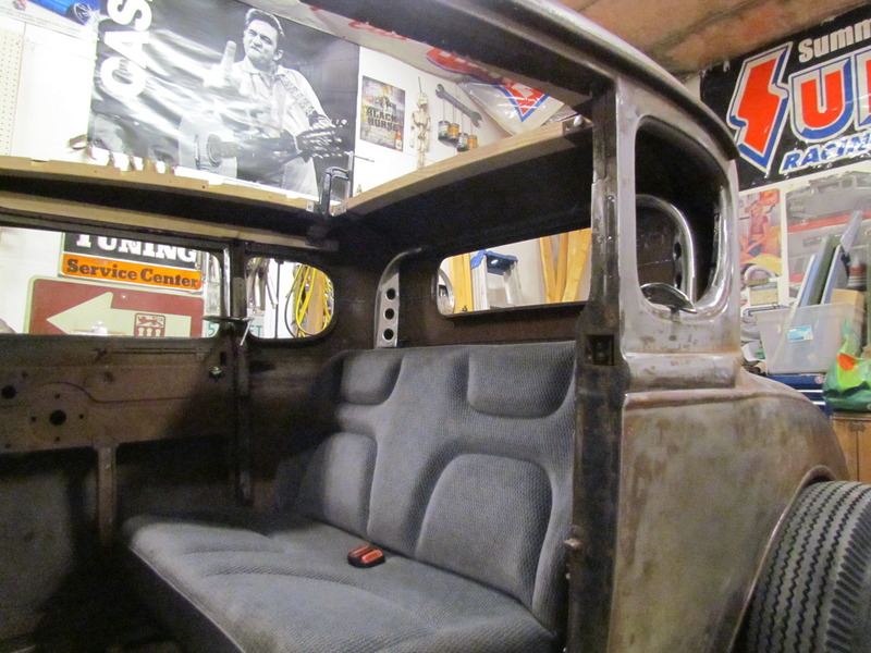

    In this picture you can see the seat frame laid in place.
    I beefed up the factory bottom of the seat and added hinges. BTW this is a caravan seat that is virtually brand new, comfy and cheap.
    I added a sliding pin style lock that pins the rear of the seat into the frame to lock it in place. Not sure if I have pictures of that.

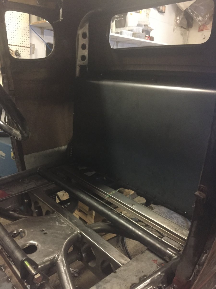

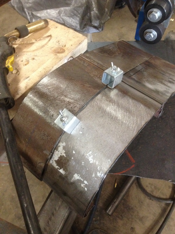

    I started building a floor, I bought a really cheap bead roller and some 20 gauge and went to town, bending and beading but it didn't turn out as planned so I bought some 16 gauge and made flat floors.
    The curve at the top was a pain in the butt to bend.
    This is the trunk area, not great.
    I added mounts to hold the rear and just used hockey pucks for those body mounts.
    The front mounts are flat rubber pieces I found around the shop used for stops/rests for heavy ag equipment, which fit the bill perfectly.
    Not seen (well sort of) I braced underneath the floor near the firewall for the future fuel cell.
