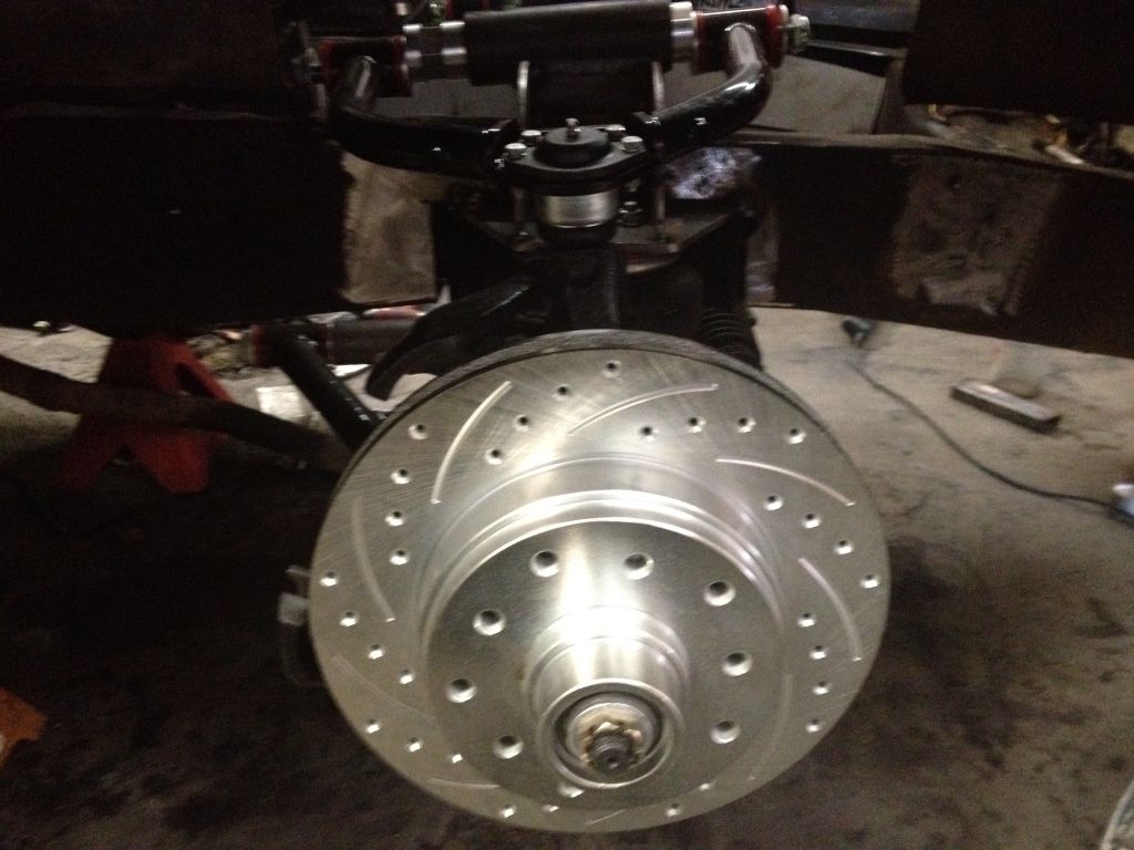

    So......my no limit kit sent lower arms for coil overs not bags which delayed my trip to the shop until Tuesday.....however the shop set a few pics.....the frame rails are plated....the frame is straightned out.....the rack and cross member are in place. Everything is just tacked until Jon from no limit approves it..

    So went to the shop today to visit the truck......the owner Kevin said he drove the truck after I left last time and that it scared the shit out of him and that I have every right to be pissed...he upped his insurance policy to be allowed to test drive on the fwy because of this situation. Again he was super cool and super nice and we went over all the measurements and details of the new suspension..... This set up looks so amazing. I'm really excited to drive it.....steering just has one knuckle instead of 3. It moved the wheel up so I can actually fit without steering hitting my thigh..... We did run into an issue.....my truck has a front sump oil pan which does not work with this kit or really with any kit because the rack and cross member....so we have to find rear sump for a 223 inline 6. Notch this oil pan and then run hoses and a larger oil filter to make up for the lost oil in the pan. Or we are going to try and flip it around and re drill screw holes and change gasket because it is symmetrical...anyone know what do do with inline 6 223 oil pan issue? Other than that everything is great. I took some pretty shitty pictures but here they are. Everything is only tacked not solid welds yet

    I believe he still works at the shop....i saw his bad ass truck there today. not sure never met the guy in person. All I know is the shop owner has been super cool and apologetic. And based on what I saw today I was super happy. All measurements were square and perfect all the way around. It just looks so much better and STRONG. its got a sway bar and looks like I could take corners at 50. I am just excited to see what a real suspension feels like. Even the owner admitted he had white knuckles when he took my truck on the fwy. All i know is all said and done I am super happy how this got resolved. I have no hard feelings with the shop. And i believe this was a learning experience for myself and the shop owner. I agree it should never have left his shop in the condition it was in and he also said that himself. Hopefully this entire situation helped save someone else and i got a better suspension and hes running a tighter ship. :D:D

    No......but I went and visited today and was SOOOO happy with the result so far.......we ran into issues with the oil pan but had one custom made and not notched like we were planning. I was there while the engine got put back in and was also able to watch the new bags cycle. WHAT A DIFFERENCE....I HONESTLY COULD NOT BE HAPPIER.....the welding looks way better and the truck sits PERFECT...due to the new oil pan we had to wait 24 hours for the sealer to dry and I am going out of town until next thursday or friday. The truck is done and will be taken on test drive MONDAY!....i will call him and see how she drove...I will update as soon as I get her back home on thursday or friday.. But overall I am very very happy.....nervous about a custom oil pan but very happy with the suspension...oil pan was pressure tested and everything but just dont like the word CUSTOM anymore due to my previous CUSTOM suspension:D
    here is a pic of her aired out and believe me the wheels are SOOO much more straight hardly any camber and it will be alligned on monday.....he even took my radiator to the radiator shop and had it welded for me because i showed him I had a pretty large crack in the top seam......
