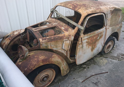

    here's the car when I saw it the first time :
    It's a 1934 peugeot 201. It started its life as small 2 doors car and got hacked into a pickup probably after WWII.
    here's a better view of the car once I brought it back to my shop :

  8. Nice project. What happened to the Simca/Topolino van next to your pickup ?
    Protofuria likes this.

    it's still there , waiting for someone with a lot of courage 56120227_2145738692403566_3274064199784857600_n.jpg

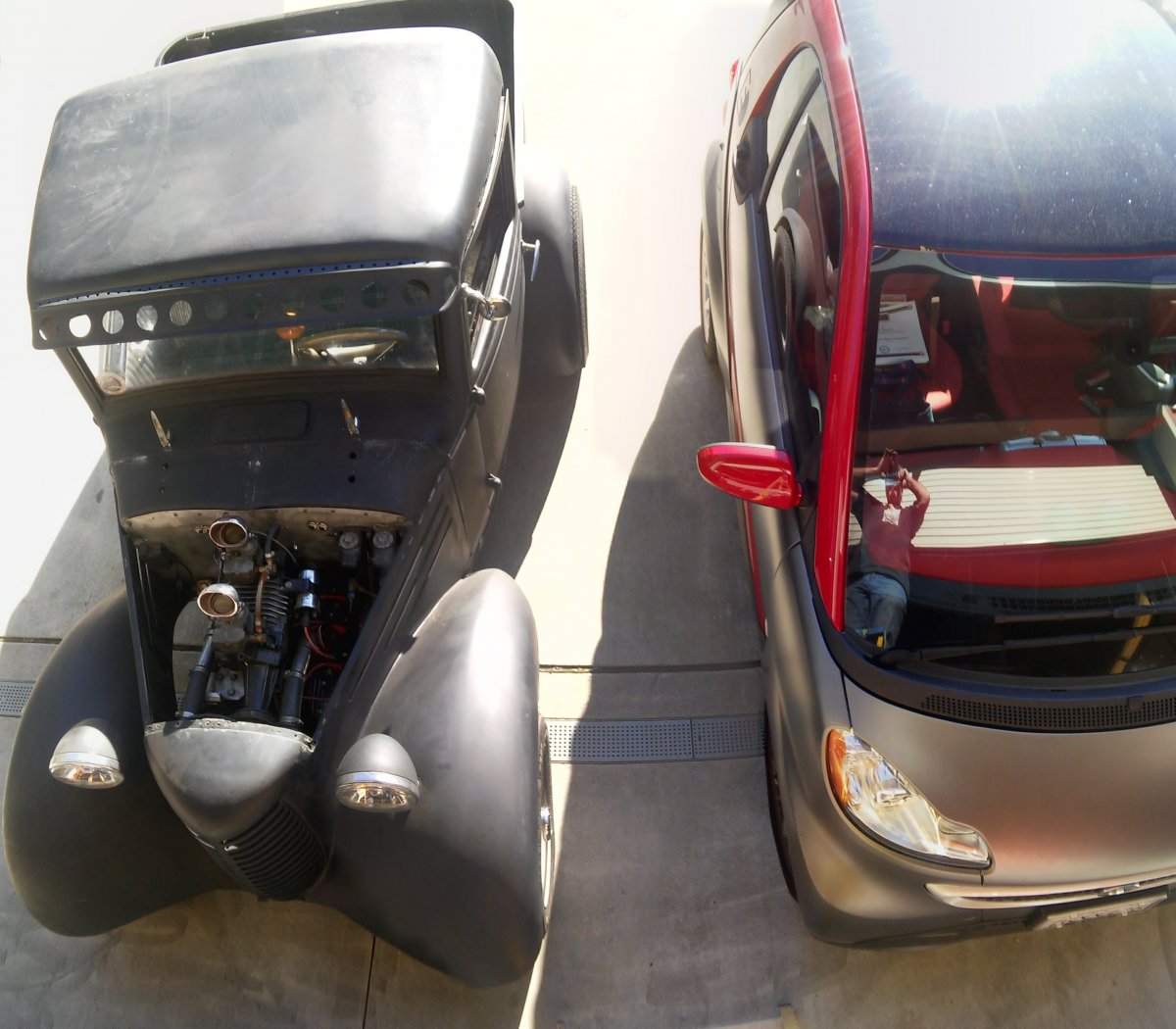

  13. Cool project, looks like the motor is fitting in there pretty good.

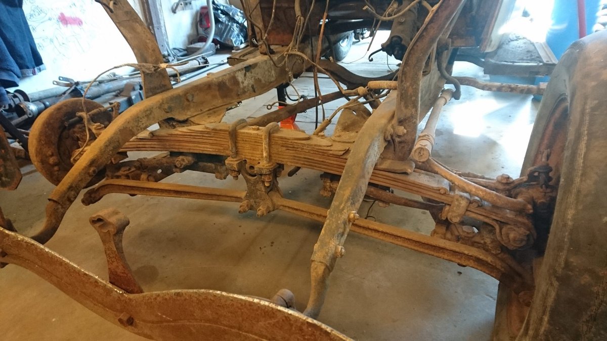

  14. Protofuria
    Joined: May 31, 2011
    Posts: 50
    Protofuria
    from France
    here's a view of the front axle : from start to 1933 it sported a solid straight beamvthen in 1934 they changed the design and went with independent wheels
    I'm working on the rebuilding of the front end. I was able to find some NOS spindle rebuilt kits (pretty expensive parts) . the wishbones were badly bent as the car had been moved with a forklift. Some adjustements under a press solved this.
    I also plan to lower the car as it sits pretty high. I'll reverse the two split beams and the longer leaf springs, this should do for a nice drop.

    yeah it looks like it belongs in there, except for the alternator that sticks out too much.
    I could have gone for a v6 but it would've been a really tight fit!

  17. Kiwi 4d
    Joined: Sep 16, 2006
    Posts: 3,582
    Kiwi 4d
    I presume thats the gas tank on the firewall. That’s a hazard i would think . What are your plans for shifting that?
    Cool build , and use what’s available.

    you're right, that's the gas tank. As there's no history of it being particularly a danger in case of an accident or some "spontaneous" fires, I will keep it. Plus it's in mint condition, absolutely no corrosion on or in it. But I'll be very cautious with all the fittings and such, I don't want any leaks near the engine. The real downside is its capacity. This would eventually push me to put a tank under the bed with a neck on the side.
    Please tell me more, what car do you have?
    That's the tranny I had with the engine, it's from a MK1 Ford Transit van. That handle is a mounting point (missing a ruber bushing). I can't use it as the shifting commands are located on the left side and stick right into the pedals.
    I'll use a Ford Granada tranny which has mounts under the case and shifting commands on top
