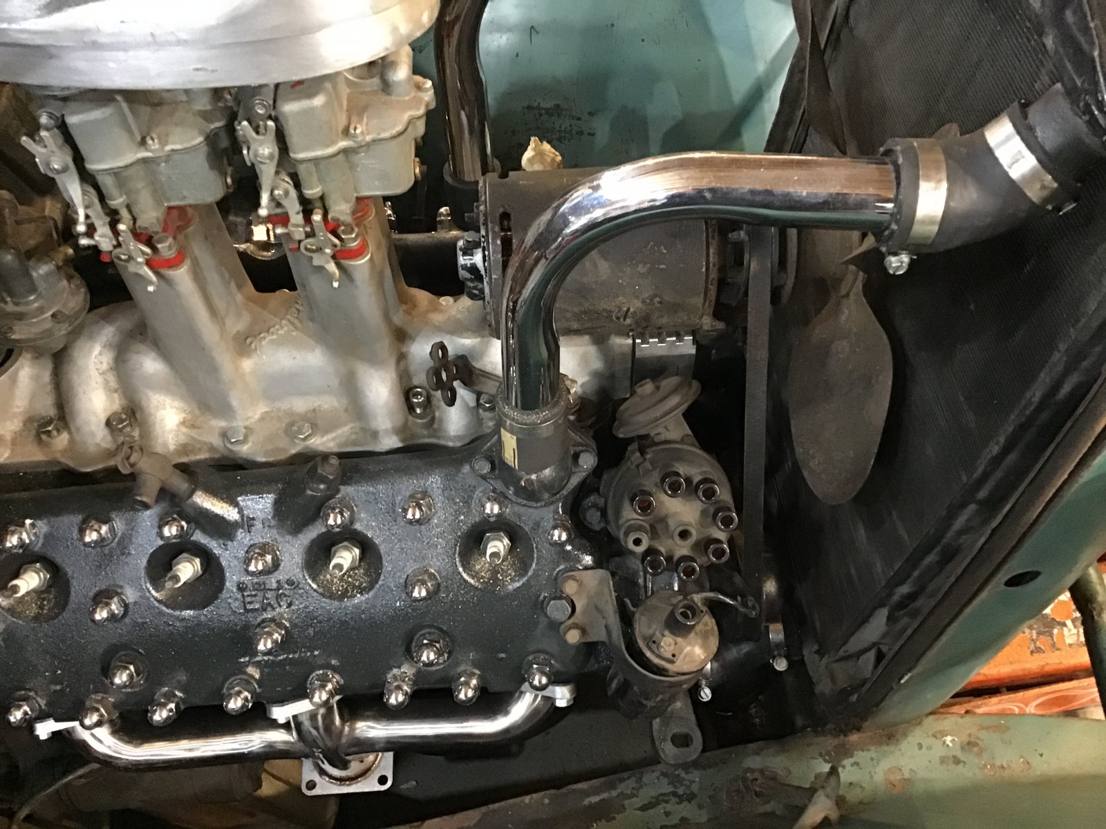

    I have tried to stick a few motors into my 1933 pheaton and with no luck without doing trimming and cutting. Plus the electric fan for me is a no but that’s me..
    You are right it’s tighter then a 32 by a inch or so and with the 8ba not sure. I am working on a flathead right now and shorten it up with truck pumps . Being it’s a 53 mercury motor or eac like your French flatty the pumps need to be later ones. So they stick out to clear the distributor. I also used a truck pulley and machined the splash or slinger off the pully . I left the duel pullies on it as I was thinking of a McCulloch vs57 blower in the future. If you notice I am also running a early edelbrock regular intake and had to machine a spacer for the intake for everything to line up.
    I measured the motor and center of the fuel pump studs to the waterpump pullies is 25 inches. That is the same dimensions as a 59a in my roadster but to the distributor and waterpump length is 24 inches so just a inch.
    I too am curious on your build as my 33 has the 21 studded motor in it. image.jpg
    Budget36, rusty valley and dutchrod like this.
