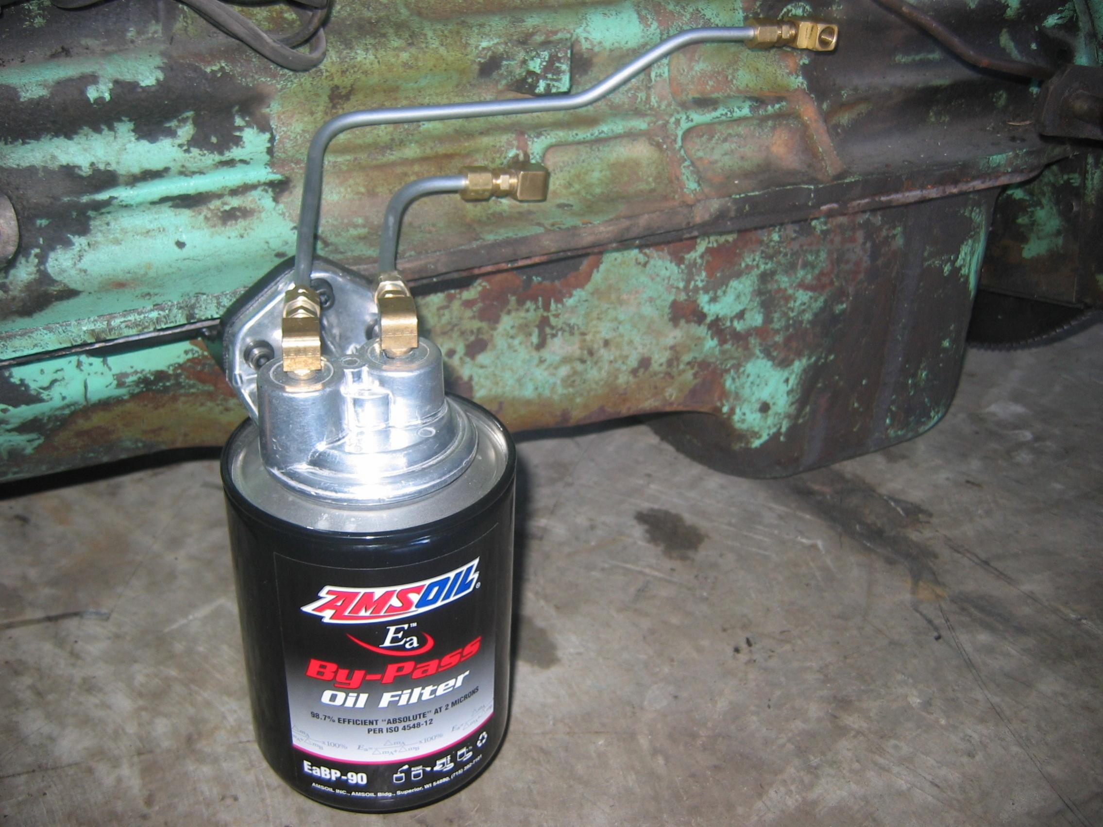

    One step beyond a TP filter would be an Amsoil by-pass set-up or a small Dieselcraft centrifugal by-pass.They claim they can filter to less than 1 micron.

    Pretty close...Amsoil rates thier bypass filter at 98.7% absolute effiency at 2 microns which insures the oil in my stovebolt 6 never darkens from soot contamination.
