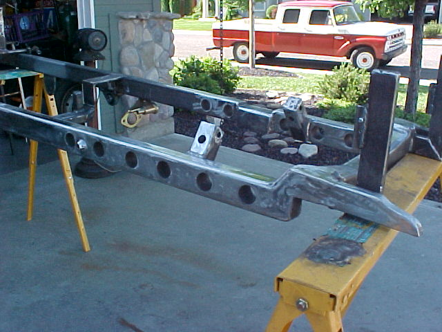

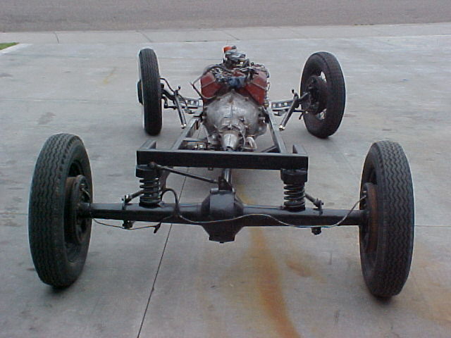

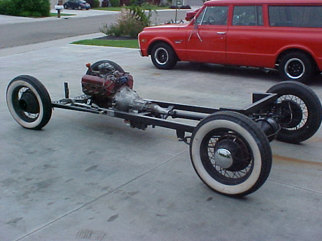

  15. That's just what I'm doing. See the pictures below.
