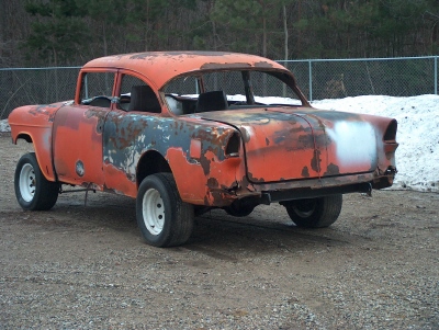

    I just bought this 55 chevy gasser, and now am looking for any history on it. It had been sitting on the north side of Coopersville Mi. for the past 8-9 years. The guy I bought it from said he found it over in the Grand Rapids/Cascade area. It has fiberglass hood and fenders that were molded together and turned into a flip front. The front tilt front end is latched at the bottom of front fenders with what apears to be Mercury Marine outboard motor cover latches! It has a 1957ish cast ford F700 truck hood scoop, not on car in pictures but I do have it.
    The front axle is a straight tube that has been widened 2" on each side, runs a buggy front spring mounted behind the axle with a 4 bar set up. The firewall has been cut out and replaced with an 1/8" steel one that is recessed back to the face edge of the dash! The dash panel where the gauge cluster and speaker holes are is filled with a thin tin panel. The steering wheel is approximately half way into the middle of the front doors with the seat mounted between where the original front and back seats were.
    There is angle in the back seat area that would have had tin panels on it creating a deck behind the front seat to the rear package tray. The door windows and quarter windows are lexan and there are no vent windows just one piece lexan in the whole door opening. Rear axle is a 1955 unit with coil springs on top of it as well as stock leaf springs and a pair of ladder bars. There is a fuel tank/cell mounted in the trunk floor. When the guy I bought it from got it, it had magnesium wheels front and rear, but they are no longer with it.
    Car was originally green from the factory but has been painted orange twice. If anyone has any info on this car, or maybe may have owned it at one time in the past, please let me know. I am looking forward to hopefully finding out some of it's past and maybe rebuilding it back for some more strip glory!! Thanks in advance, Al aka 333 Half Evil.

    That seat certainly isn't from "Back then" it dates from the 80's at the earliest

    it looks like the wheels and tires are newer too.

    is it just me, or does the front axle look bent, like the tires bow out at the bottom? Looks like a great start, good luck with it!

    the seats were just thrown in....he was getting rid of junk at my expense. The seat that was in the car when he got it was a shortback fibreglass/plastic? chair type seat with just a thin pad cover.

    wheels and tires are of a dirt track car, used them just so I could move the car around.
  13. The front wheels are probably out of alignment because there's no engine in it.

    the axle is not bent, there is only one rod on each side for the four bar set up therefore the axle is rotated way back, massive positive camber style!! that is why the tires look as they do. when you turn it they actually flop over like a road grader!! The other bars are in the trunk and when weather permits I'm going to get them back on to straighten things up a bit.
